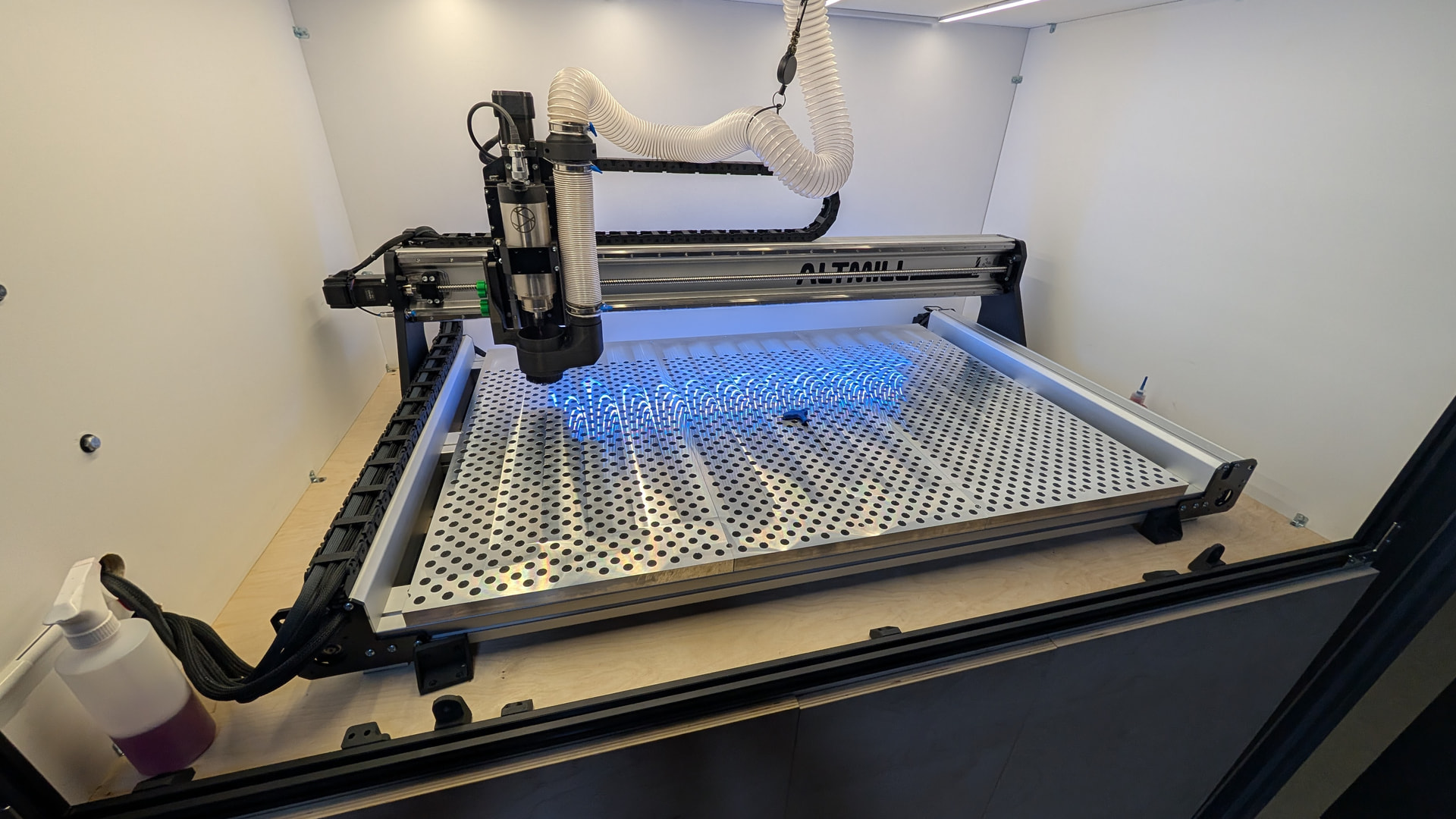

**Author:** ![Imisky](https://forum.sienci.com/letter_avatar_proxy/v4/letter/i/6bbea6/32.png) [@Imisky](https://forum.sienci.com/u/Imisky)\
**Post date:** [January 5, 2026, 7:47pm UTC](https://forum.sienci.com/t/1-4-aluminum-plate-as-table-surface-for-altmill-2x4/17197/20 "2026-01-05T19:47:51Z")
I did something similar with my Altmill 2x4, instead of 1 large slab, I broke mine down to 3, and went with 1/2” holes instead of 1/4” or 6mm. I didn’t however thread mill all the holes myself. I outsourced the fixture plate to a supplier that I often use.
I was originally going to make the plates but after some calculations the downtime on the machine (I use it for commercial purposes) would be too much for me. My plate is 1in thick and follows the specifications of SMW so I can use their vices should I need to. But I often make our own fixtures to go on top of the plate. My plate has around ~1750 holes
 ![PXL_20251202_194553289](https://forum.sienci.com/uploads/default/original/2X/f/f55654c8c599e6261d94701c7c798541c70e40af.jpeg)
