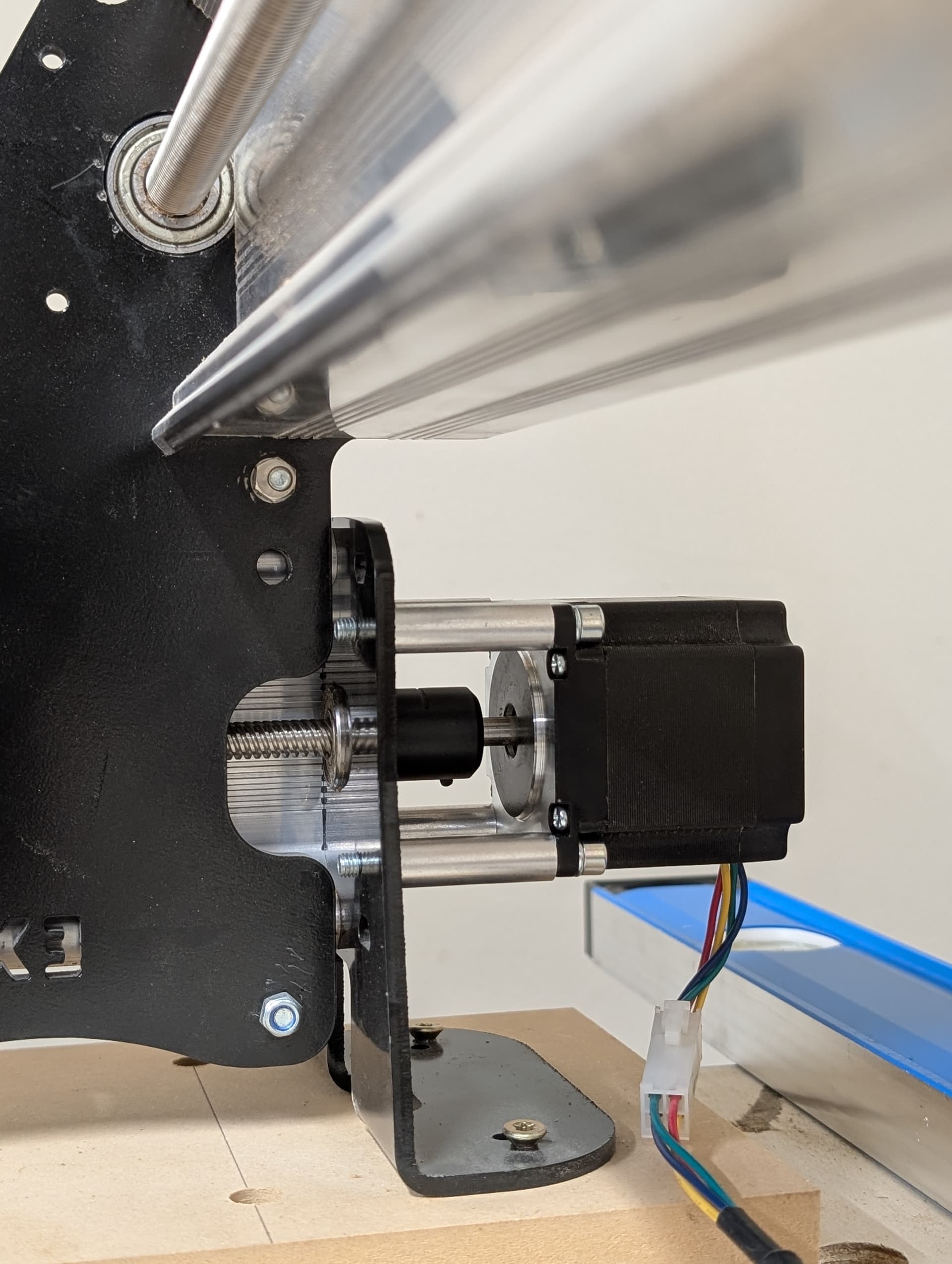

Ive switched motors around, cables, and checked wheels for tightness/play. Everything seems tight.

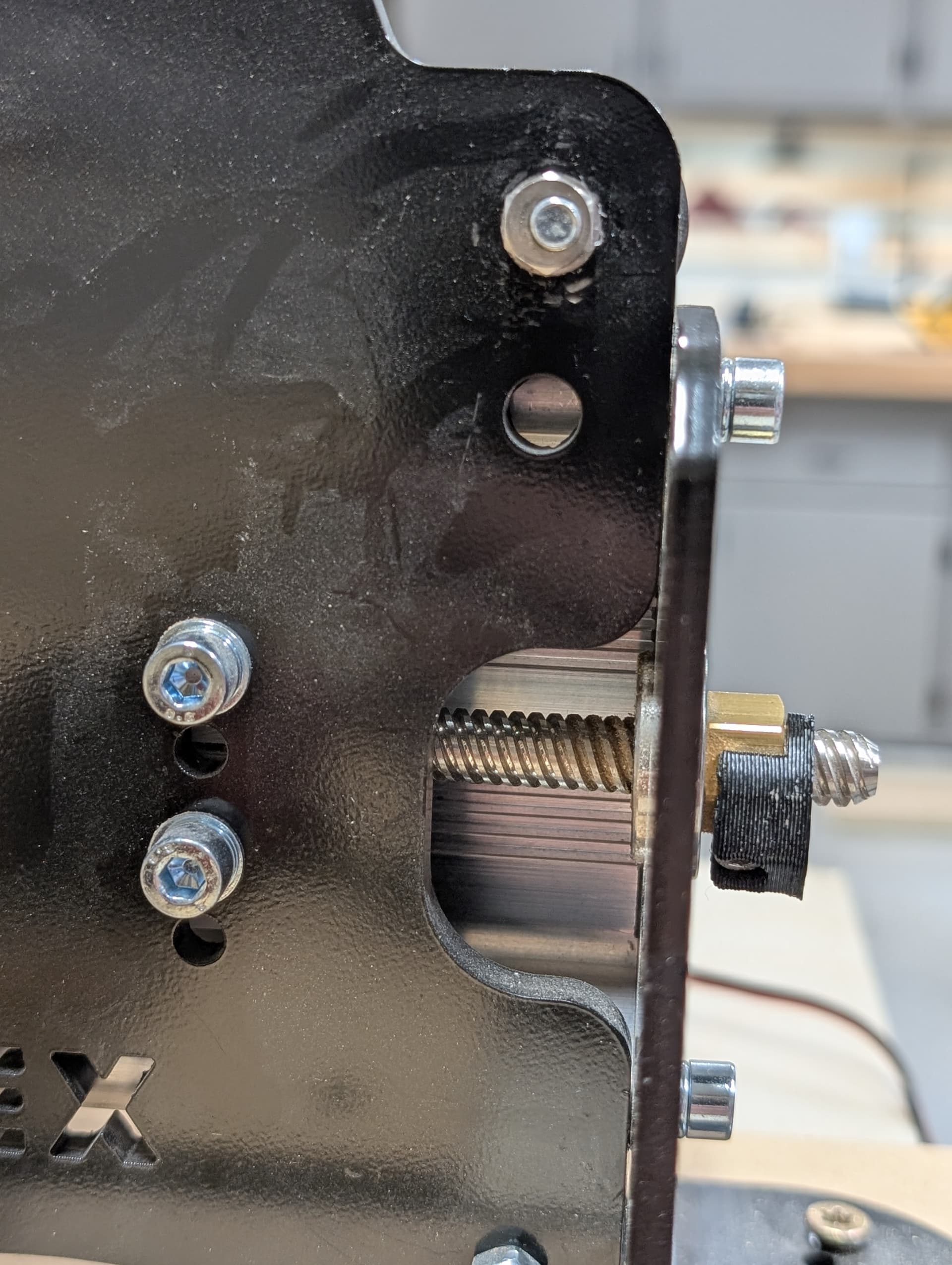

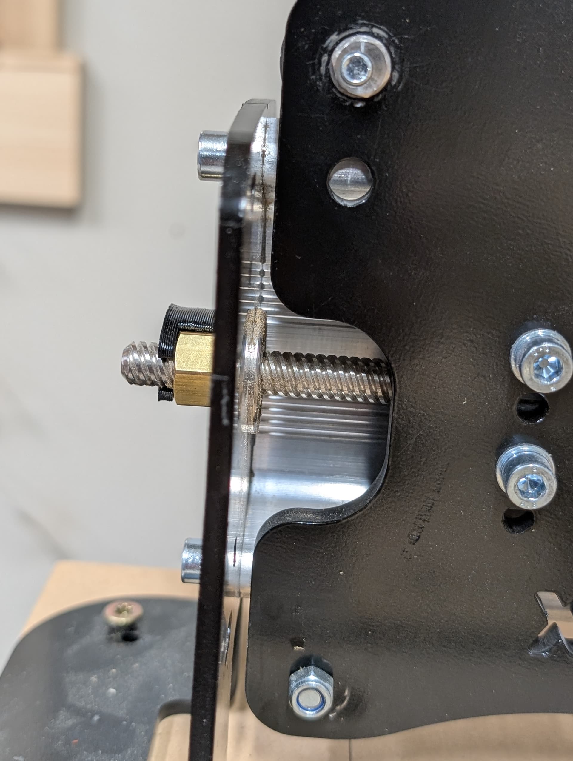

Confirm that the anti-backlash nuts are not the cause. Which do you have, the black or the white. In either case, loosen the bolts holding them to the plates and run the machine back and forward a few times with them loose, then, with the travel in the mid-point, snug them up. Don’t go nuts. If you have the black, back the adjusting bolt off completely, then by small increments, adjust it until there is no play - no more.

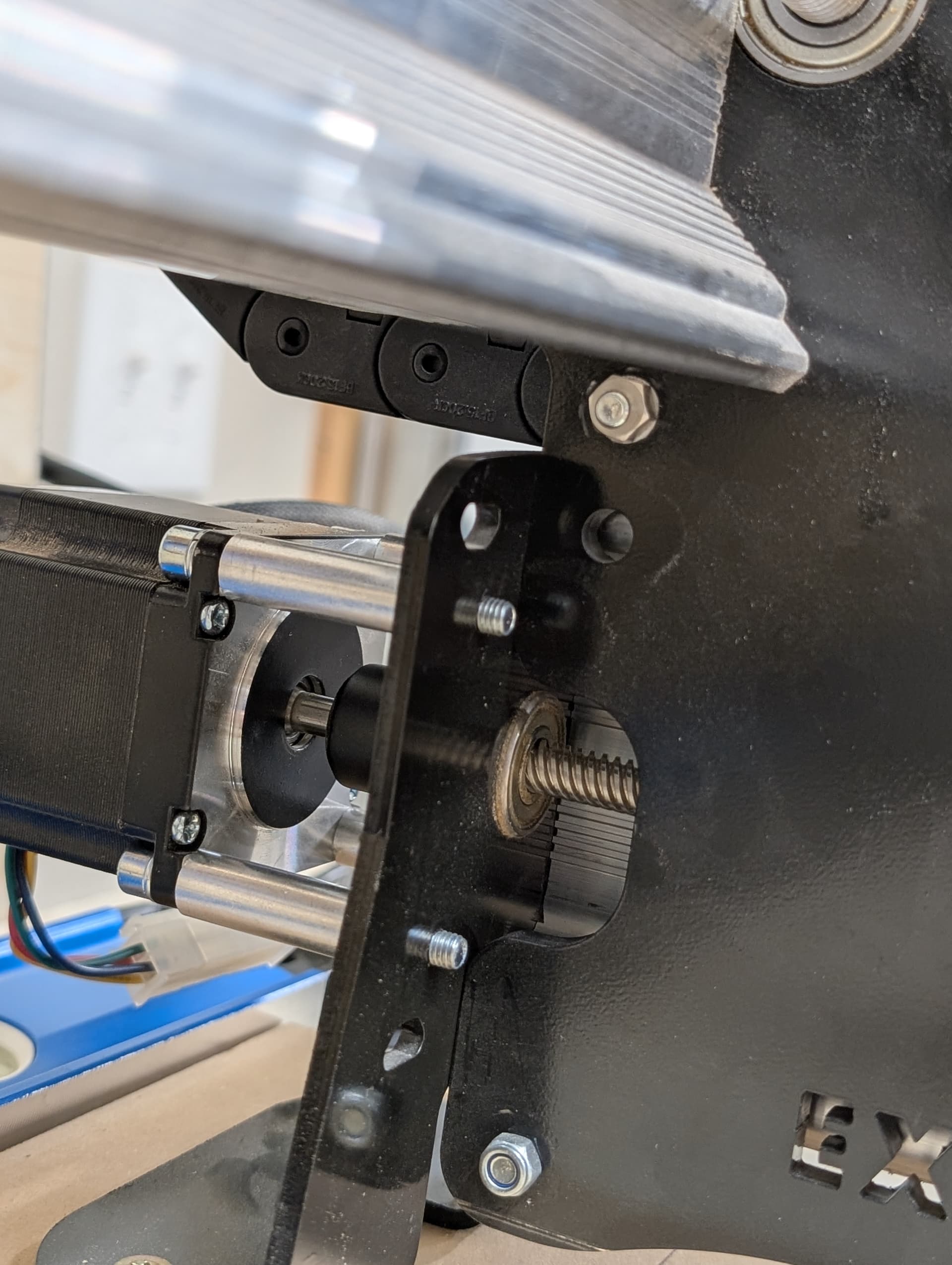

Ensure that the collar between the motor shafts and the lead screw are tight.
OH, big question. Which machine are you running? If this is an AltMill, everything that I just said is irrelevant.
You are describing a milder version of something I ran into something not long ago. And I can’t fully explain how or why. My right rail was not traveling at the same small rate as my left. Initially it was very subtle (one having a small gap vs the other butted up against the end), it wasn’t very long before it became very apparent it was binding and running at a severe angle. I checked the v wheels and backlash nuts but didn’t fix anything. What I believe happened is when the machine was getting run to the end stop, the bearing lock nut somehow became over tightened causing the binding on the lead screw. I loosened the set screw, reset the bearings to the appropriate tension and was off to the races again. If you’ve been running up against hard stops it’s possible you are experiencing the beginnings of the same thing?

Yes, Y motor and cables have been switched. Same issue, which makes it seem like a mechanical error, yet everything checks out good. I just rechecked V-wheels, left side is all perfect, right side is all good except for one on the bottom, which, no matter what I do, is always a little loose(been like that since I’ve had the machine). I also loosened up all v-wheels and ran it back and forth, but the problem is still there.
I have the white backlash nuts. I loosened them up and ran it, still 1/8th off on the left side with them both loose. I re-tightened with the short end of the Allen key and just two fingers, so not too tight. Re-checked, and the problem is still there.
Collars are tight.
Seems like a mechanical issue, yet nothing I do changes it, not even a little. It stays very consistent, like a motor reading steps just a hair off or the control board sending a weird signal, or reading it wrong? Is there a way to watch the individual motors count steps? Even though switching motors and wiring seems like it should switch the side of the problem if it’s something like that.
I also reset all my settings to check, problem is still there.
I have a 48x30 MkII.(would like an Altmill, Espescillay if it is more rigid and less screw ups(which might be just me, but whatever))
@Greener Kinda sounds the same, I haven’t run a job yet to see if it gets worse or anything, but will probably start since I’m running out of time and need to start making projects again. Actually, when this first started, the left side lock nut was loose. I noticed it when looking at the rear motor and can watch it suck in a little when butting it up against the front, yet it was not the fix, and why I’m here looking for help. I also usually never run my machine against the stops unless I’m checking alignment, and i don’t have Inductive sensors so im not doing that either.

@Joel.S I just watched the installation video for the white nuts. Be sure that the springs are facing the motor on both. Finally (and really this is “finally”) be sure to break them in . Sienci recommends spraying the lead screws with WD40 and running the machine back and forth several times at normal jog speeds. Then, repeat at rapid speed. Finally, dry off the lead screws.
@gwilki So the white anti-Backlash nuts are facing the correct way, springs towards the motors. I‘ve had these nuts installed for some time and have been using the machine without noticeable problems, yet the current problem still could’ve been there, just never noticed.
