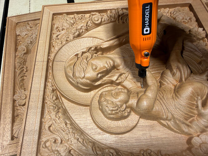

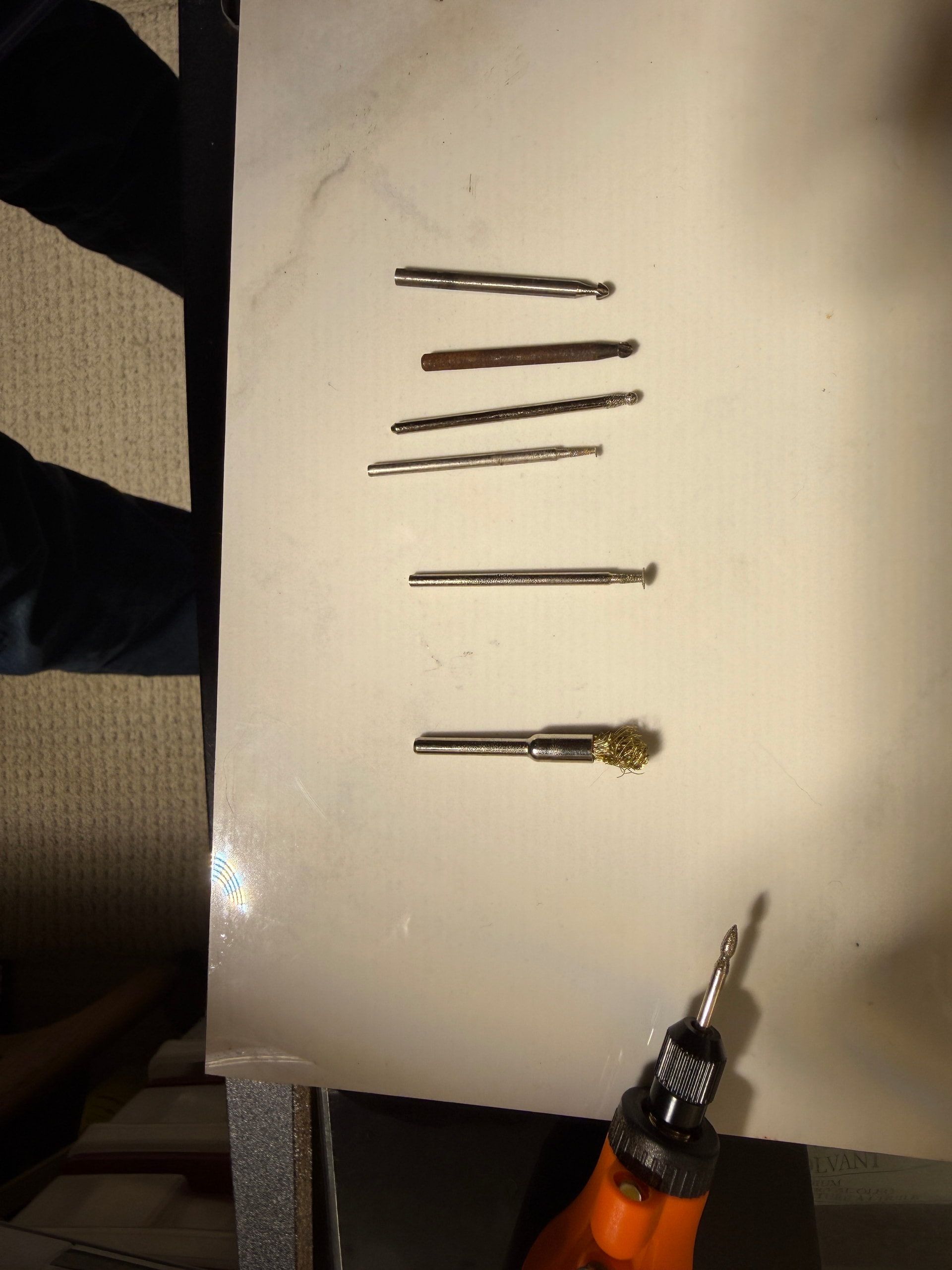

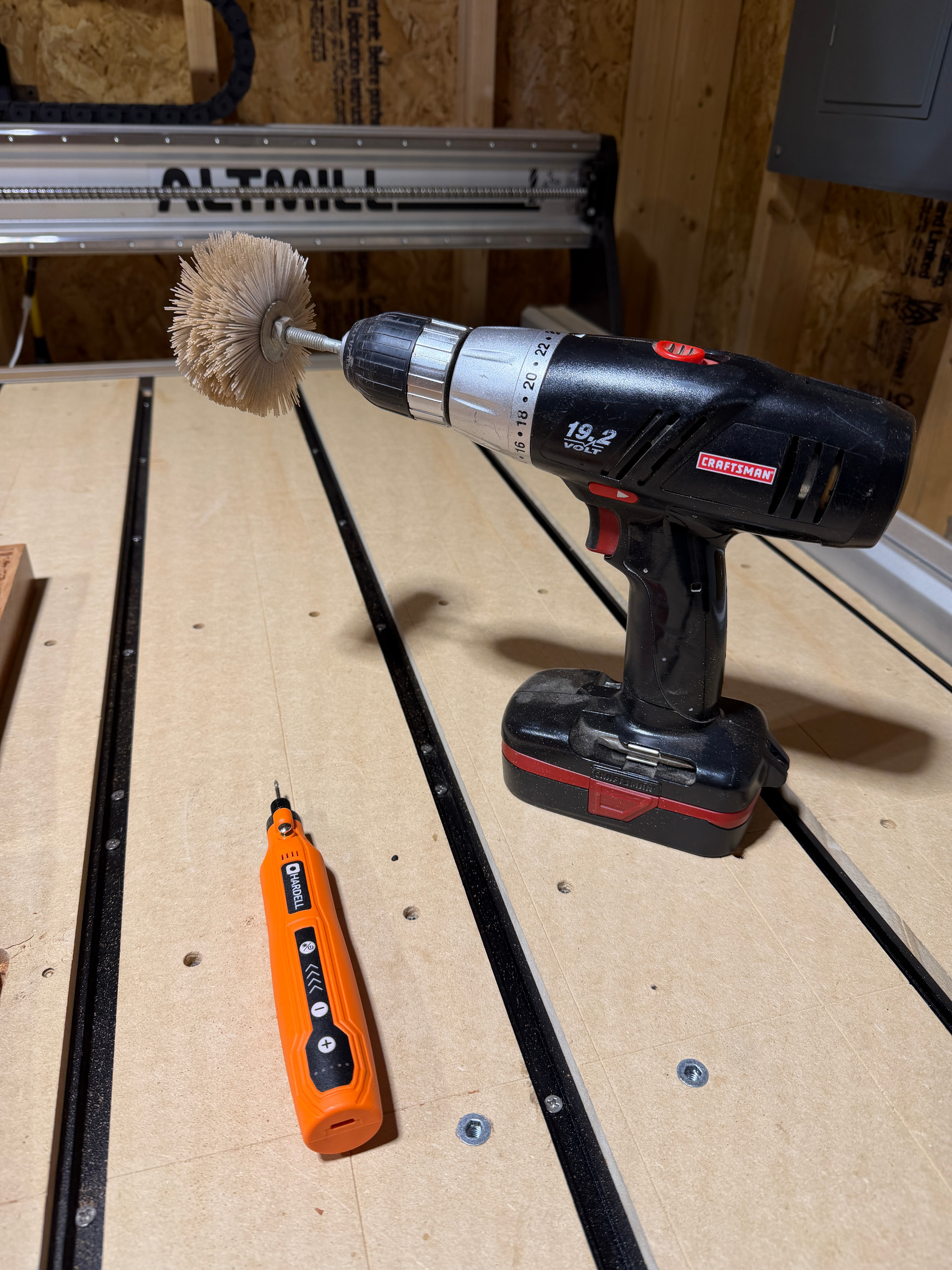

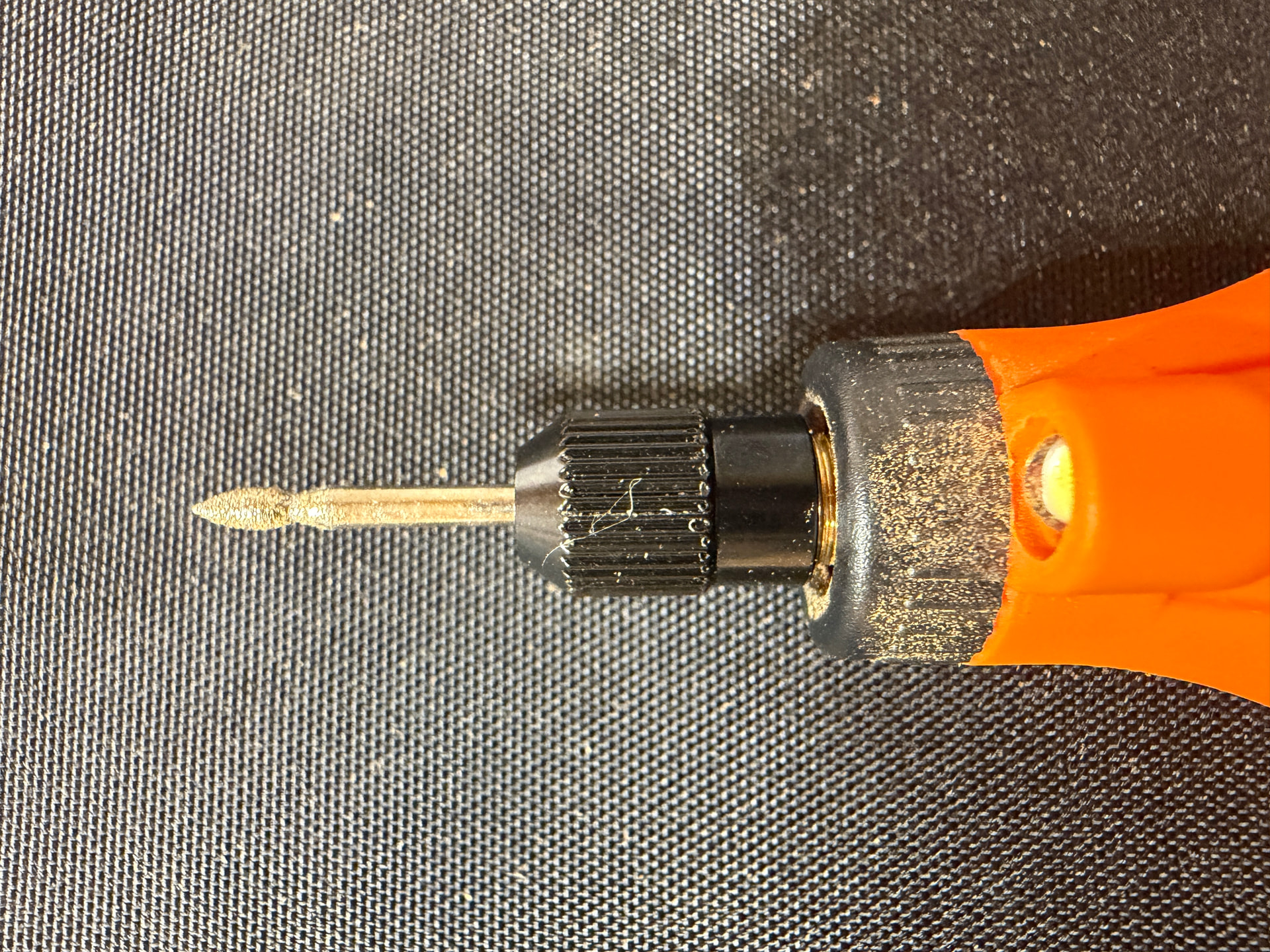

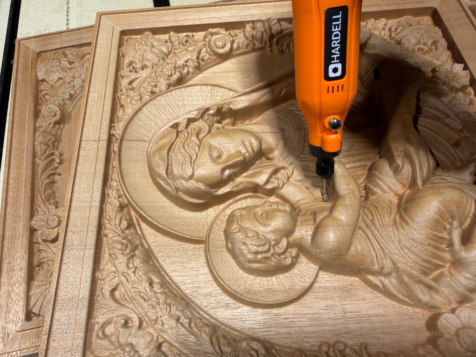

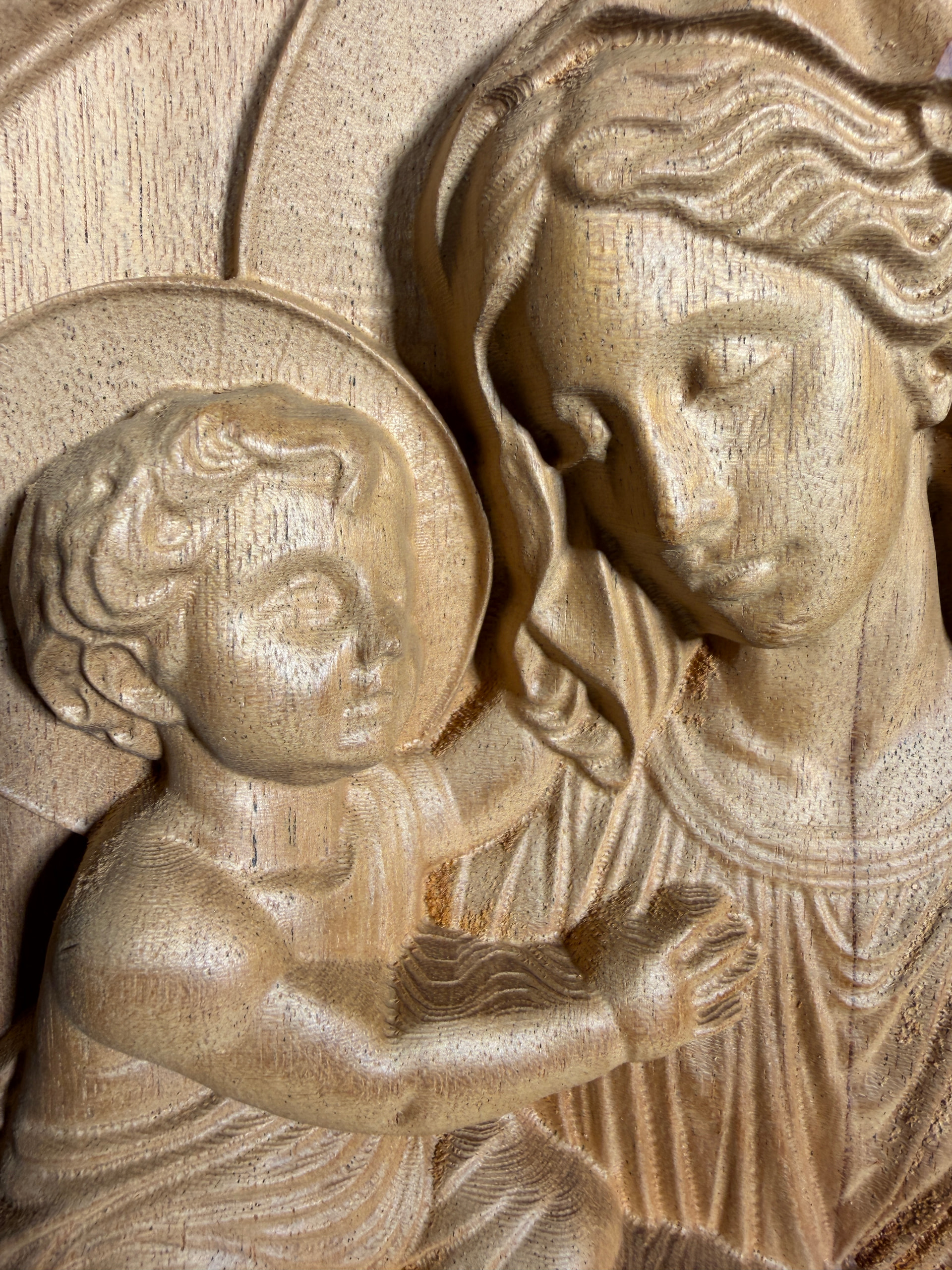

After doing so many carvings, and have tons of fun doing them, one step in my process needs some improvement. After the CNC finishes its finishing pass there are always some fuzzies on the wood left behind, even on dried wood. I use a drill sanding wheel first which removes most of these. But then I have to go in the crannies to get the rest with my pen dremel as many of you probably have done. I am looking for the any methods you use or specific bits for your dremel that you found to be the best. Thank you in advance for any thoughts. The bit I found so far to be the best is the one in the pen dremel. I have tried the others but they don’t work as good.

I like to use these dremel sanding wheels

Be careful when using the above disks - they tend to come apart in use and sling the “fingers” everywhere. Eye protection is a MUST.

I’ve never had that problem with the genuine scotchbrite ones. It may be that you get what you pay for. 🙂

@DavidB Here
