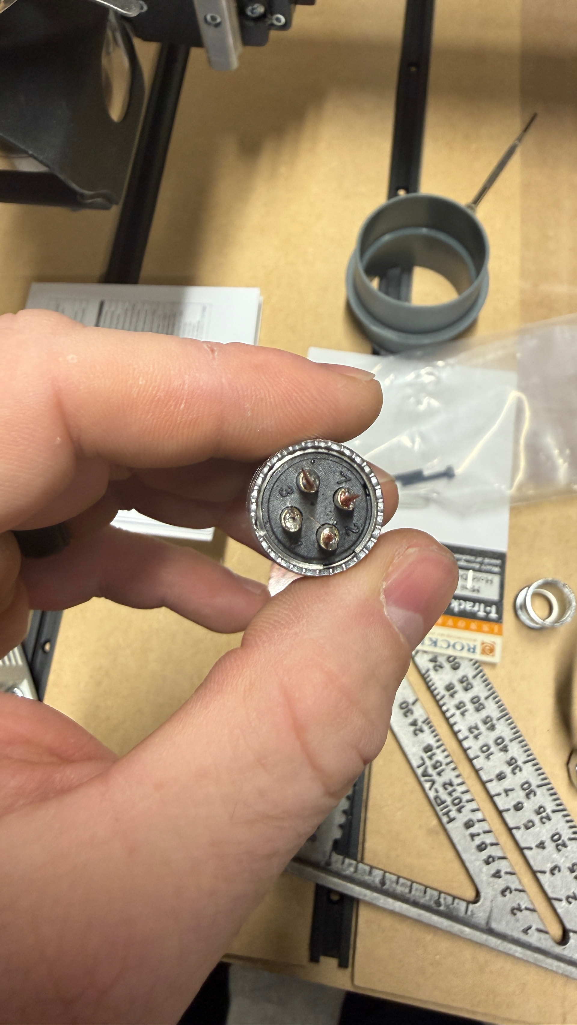

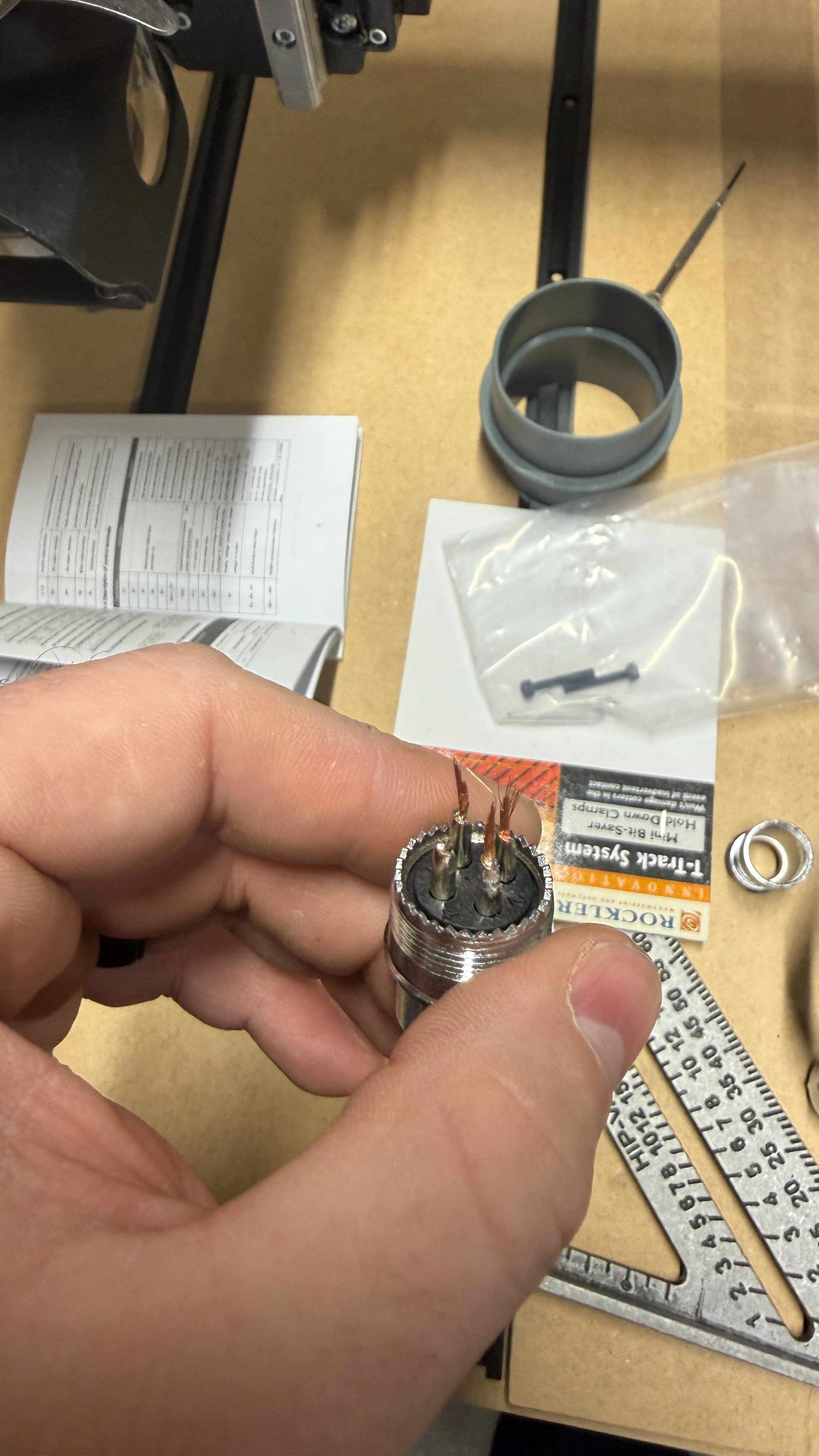

Plot twist - I went to install my dust boot and had to drop the spindle down a bit. When I did that, the spindle wire came out of the plug entirely, breaking the cable. It looks like the number 4 pin had no wire in the solder at all, and the tension relief clamp was completely loose.
At your own risk @Afterlife - might be worth opening that cable end and seeing if you see loose wiring at the solder points.
Yoooooo. Did that fix it? I have to check mine now

Got the new spindle cable and that didn’t fix anything…. sigh. Working with Lucy from their support team, hoping it’s something that can be fixed fast. I have projects stacking up!
