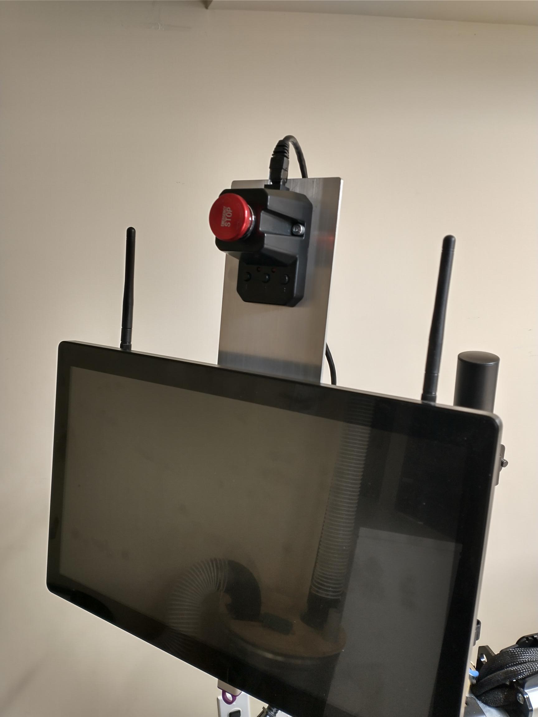

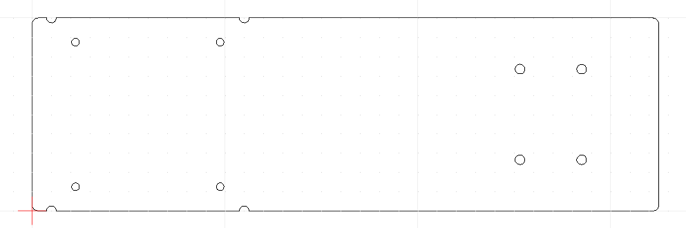

I didn’t like the default location of the e-stop. It was hard to reach in the event of an emergency stop. At first, I was going to put it at the front of the Altmill but figured it might get hit accidentally. Final location was on top of my gControl.
I had some 1/8" x 4" aluminum flat bar which I milled to fit between the Vesa plate and the gControl. The semi-circle cutouts are for the 100mm mounting screws. The 4 holes on the right of the diagram are to mount the e-stop. Only two holes are required but I drilled all four to allow me to mount the e-stop with the cable facing up or the cable facing down. Now it’s easy to reach and I can see the 3 buttons as well.
Reflection of my dust collector in the screen.

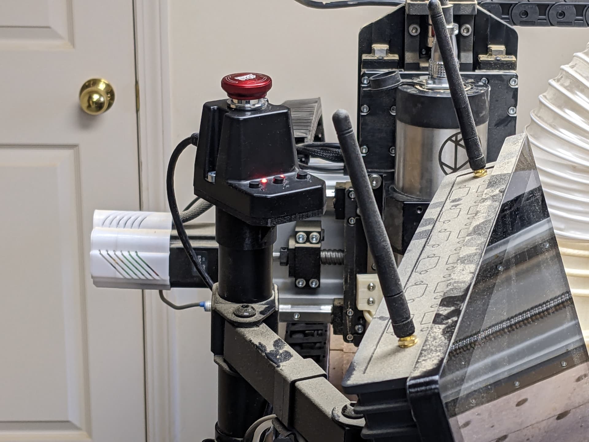

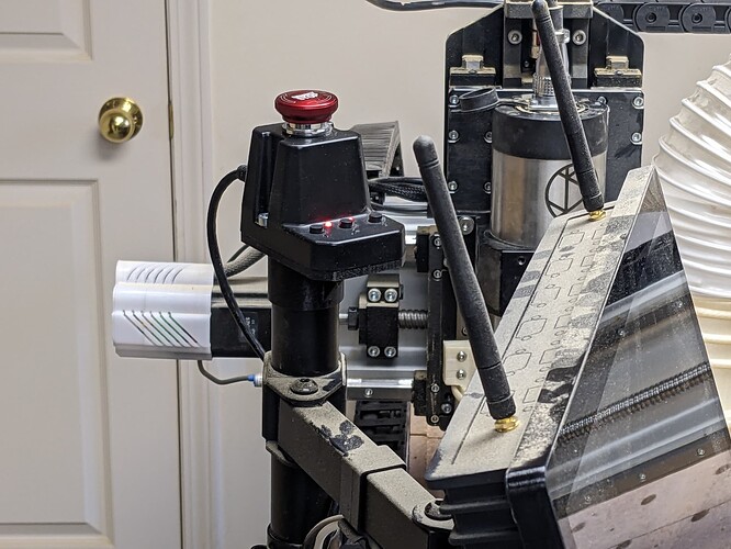

This is what I did:
 ![Altmill estop](https://forum.sienci.com/uploads/default/original/2X/d/d4674d54234fca7ba8be82e0e4c8cd79636a3f75.jpeg)
There is a 3D printed foot that fits over the gControl mounting post and the e-stop mounts on that.

Yeah, I had considered that location (didn’t know about the foot though) and other spots around the post. I tried to mimic reaching for it during an emergency and it was too hard to reach considering my monitor height and the antennas.

@Chucky_ott I don’t have the sienci gcontrol, so this question comes from ignorance, but when you hit the estop, what stops the arm from swivelling?
**Post date:** [June 23, 2025, 8:01pm UTC](https://forum.sienci.com/t/alternate-location-for-e-stop/17819/7 "2025-06-23T20:01:04Z")
The bolts are tight enough that you really need to push hard on the monitor to turn the arm. Pushing the e-stop just moves the monitor by the amount of play in the swivel between the VESA mount and the arm.

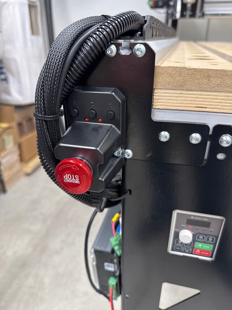

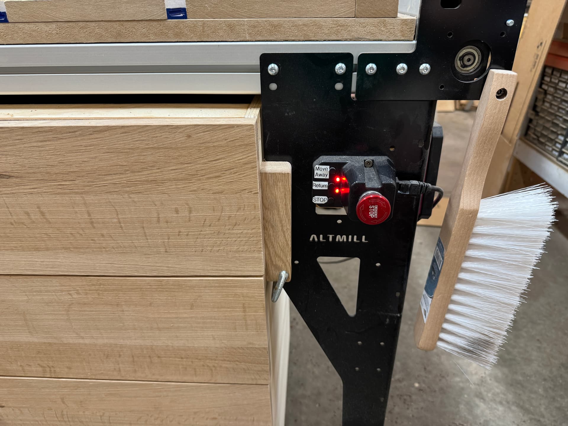

Here is where I put my e-stop:
 ![IMG_2445](https://forum.sienci.com/uploads/default/original/2X/9/9f6008ee04e539063e1eef4dc4da0bea8736db36.jpeg)
I made a simple wood back-plate to hold it in place on the right leg. As pointed out, one must be careful to not bump it by mistake, but it is very easy to reach and I programed the buttons to move the Spindle out of the way and back again.

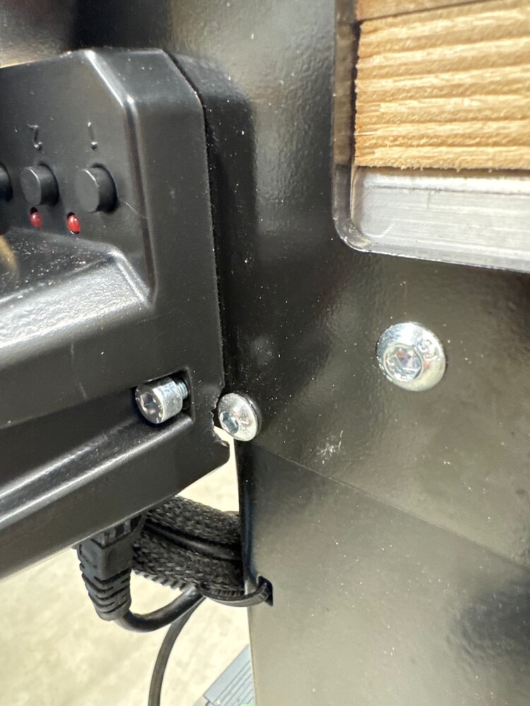

 ![IMG_9305](https://forum.sienci.com/uploads/default/original/2X/2/2e7c87507407e85741799b40658a07b45b12844f.jpeg)
 ![IMG_9306](https://forum.sienci.com/uploads/default/original/2X/c/cbab336ad2184f0f077f2fbde6e28696128b16a8.jpeg)
**Author:** ![skivvie](https://forum.sienci.com/user_avatar/forum.sienci.com/skivvie/32/11200_2.png) [@skivvie](https://forum.sienci.com/u/skivvie)\
**Post date:** [March 20, 2026, 7:29pm UTC](https://forum.sienci.com/t/alternate-location-for-e-stop/17819/10 "2026-03-20T19:29:04Z")
Ah HA! Thank you so much for posting this. I wouldn’t have thought to try those bolt holes and was going make my own mount. Perfecto. Cheers.

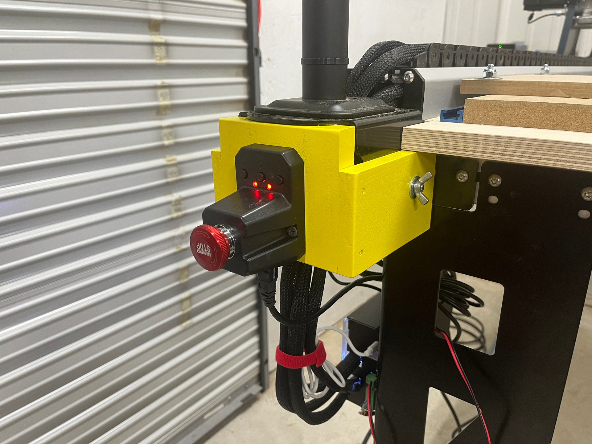

My setup as having it on the left side I feel is a safety issue.
 ![image](https://forum.sienci.com/uploads/default/original/2X/7/772afff12fedf963800a5f8940432544b22a58dd.jpeg)
**Author:** ![gpg](https://forum.sienci.com/user_avatar/forum.sienci.com/gpg/32/9838_2.png) [@gpg](https://forum.sienci.com/u/gpg)\
**Post date:** [March 27, 2026, 6:13pm UTC](https://forum.sienci.com/t/alternate-location-for-e-stop/17819/13 "2026-03-27T18:13:16Z")
That’s exactly why I mounted mine up front. In an emergency situation, I wanted it readily accessable without reaching or having to look around the corner to find it. I’m digging the yellow mount. Super high visibility.

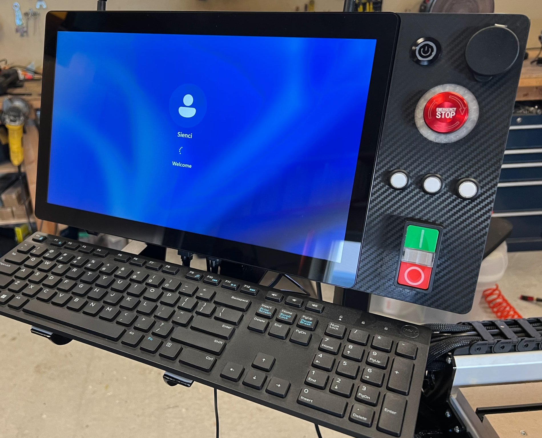

**Author:** ![marcoose](https://forum.sienci.com/letter_avatar_proxy/v4/letter/m/7ea924/32.png) [@marcoose](https://forum.sienci.com/u/marcoose)\
**Post date:** [March 31, 2026, 1:59am UTC](https://forum.sienci.com/t/alternate-location-for-e-stop/17819/14 "2026-03-31T01:59:21Z")
I took mine apart and put it into a 3D printed box that fits on the side of the gControl
 ![image](https://forum.sienci.com/uploads/default/original/2X/4/4bbca737671568bdc9de8f35f89158eb357202de.jpeg)
**Post date:** [March 31, 2026, 2:55am UTC](https://forum.sienci.com/t/alternate-location-for-e-stop/17819/15 "2026-03-31T02:55:50Z")
That looks awesome! What are the other buttons/knobs do? I assume the 3 buttons below the stop button are the three buttons on the original emergency unit but what about the big button in the upper right? What about the button that looks like a power button and the red/green monstrosity ?
**Post date:** [March 31, 2026, 11:42am UTC](https://forum.sienci.com/t/alternate-location-for-e-stop/17819/18 "2026-03-31T11:42:12Z")
Yep, the black power button in top left is gControl PC power, the top right is a USB extension dust cover, the middle is the original e-stop with neopixel ring around it, then 3 buttons that replicate the stock ones, and the monstrosity at the bottom is for a contactor that turns on the machine power (the Sienci 48v and 220v for my spindle)
