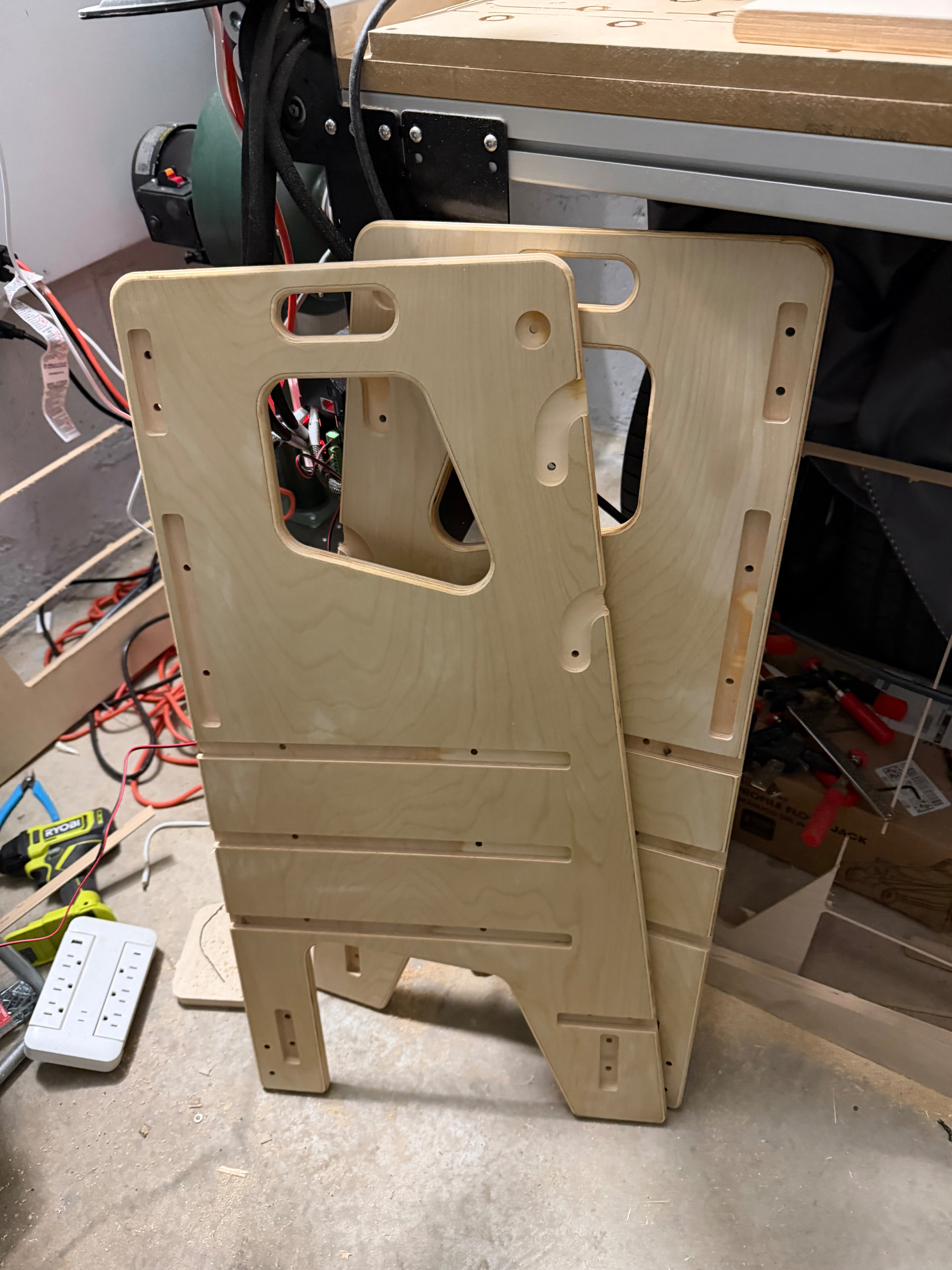

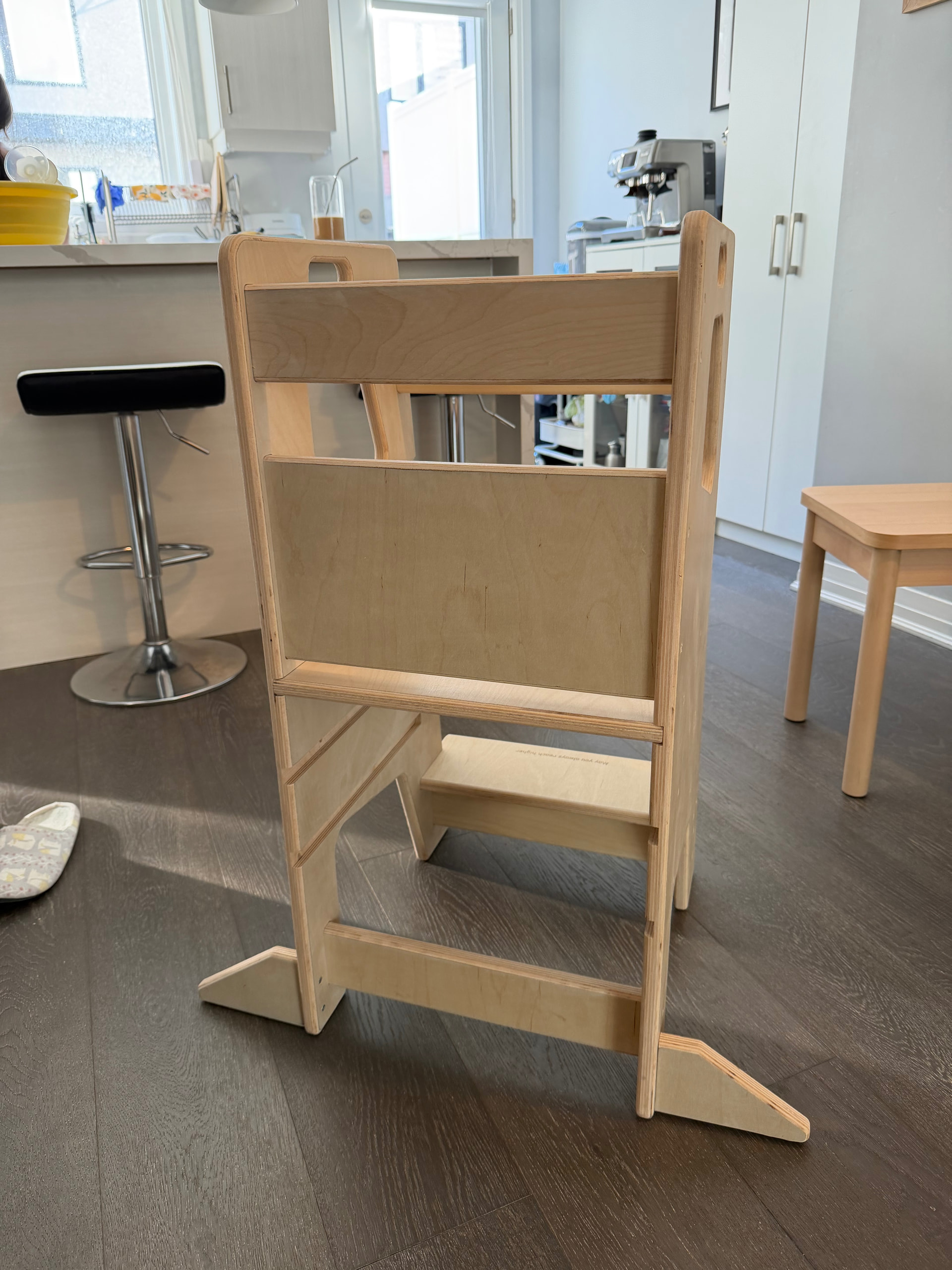

Thank you, I absolutely love it. Managed to make a Montessori Learning tower for my kid (and break a compression bit in the process). I’m working primarily with 3/4” plywood and 1” hardwood (cherry, maple, walnut). Do you have some recommendations for feed, speed, and step down for a 1/4” compression bit? I found the Long Mill settings to be too conservative on the Altmill.

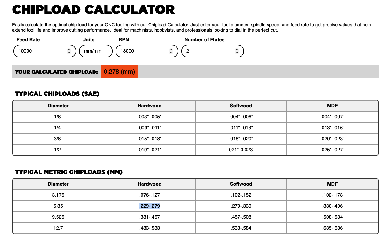

Haha fair. I was not running at the LM recommended settings when the bit broke, though. TBH I didn’t know what I was doing when that happened. Read up quite a bit on chip load and related stuff since.
Right now I’m cutting 4/4 maple at 18,000 RPM and 10,000 mm/min, with a step down of 1/4”, and yes I do have ramp enabled. I’m using Fusion 360 and the settinsg above seems to be good.

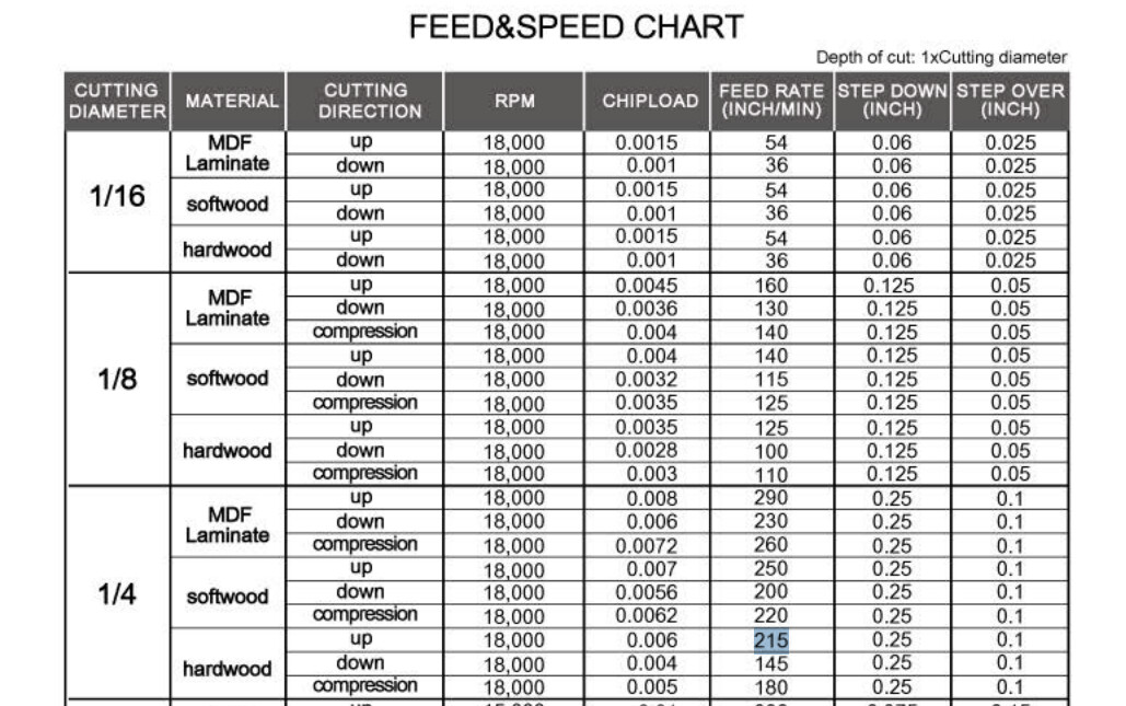

I believe in the spetool spreadsheet, it’s set to in/min. which is about 5400 mm/min.
 ![image](https://forum.sienci.com/uploads/default/original/2X/b/b59eea5d00a9a84822144be4fa8c5f10ab0b8353.jpeg)
I was trying to match this (from IDC woodcraft).
 ![image](https://forum.sienci.com/uploads/default/original/2X/6/6f575fde0a9802d6b21aa4252ea8df743b82ceef.png)
**Post date:** [March 28, 2026, 3:20am UTC](https://forum.sienci.com/t/altmill-feeds-and-speeds/14176/17 "2026-03-28T03:20:01Z")
I sit corrected. That is indeed 215 in/min.
So that would be 215\*25.4 or 5461 mm/min
So you are running things about twice the feed that is recommended.
The damn mm vs in and sec vs min always seems to screw me up - most annoying.
I stand by my initial comment that you seem to run things very aggressively (ok so I downgraded from ‘incredibly’ to ‘very’)
