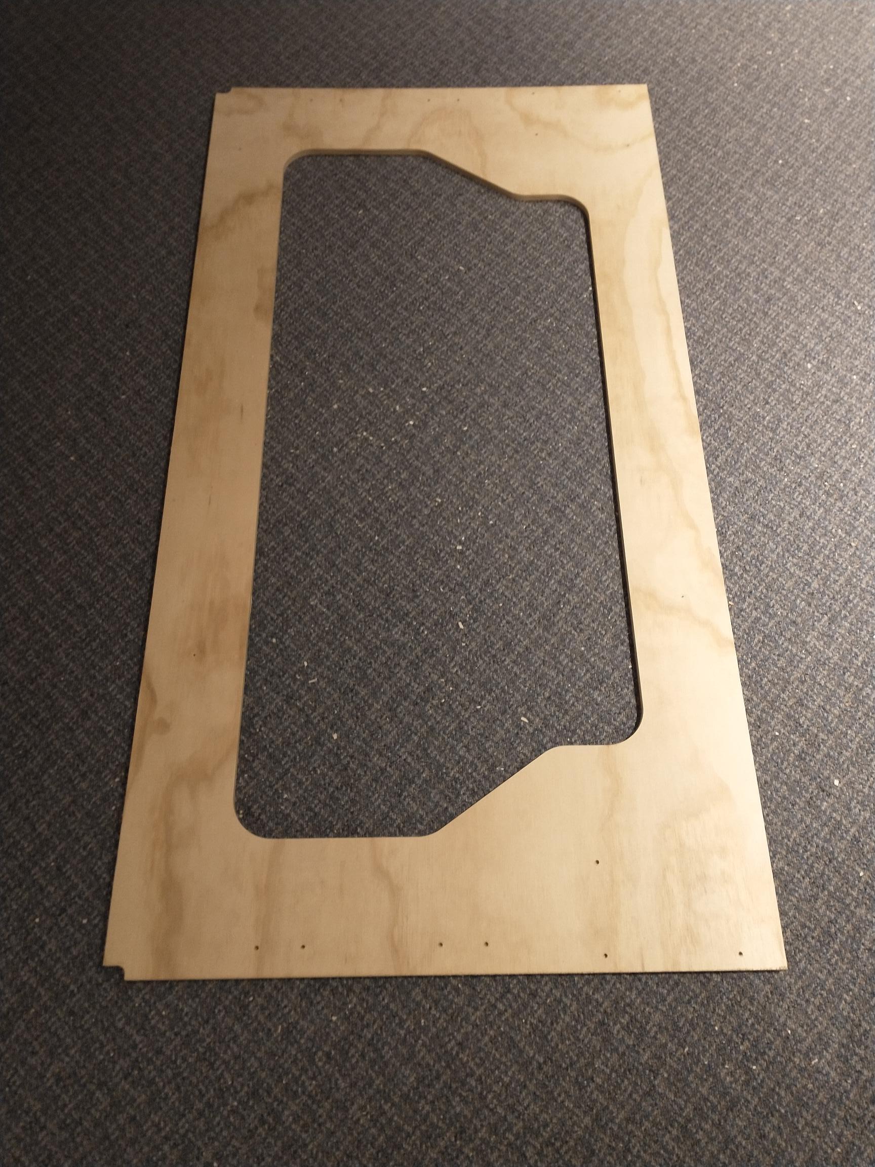

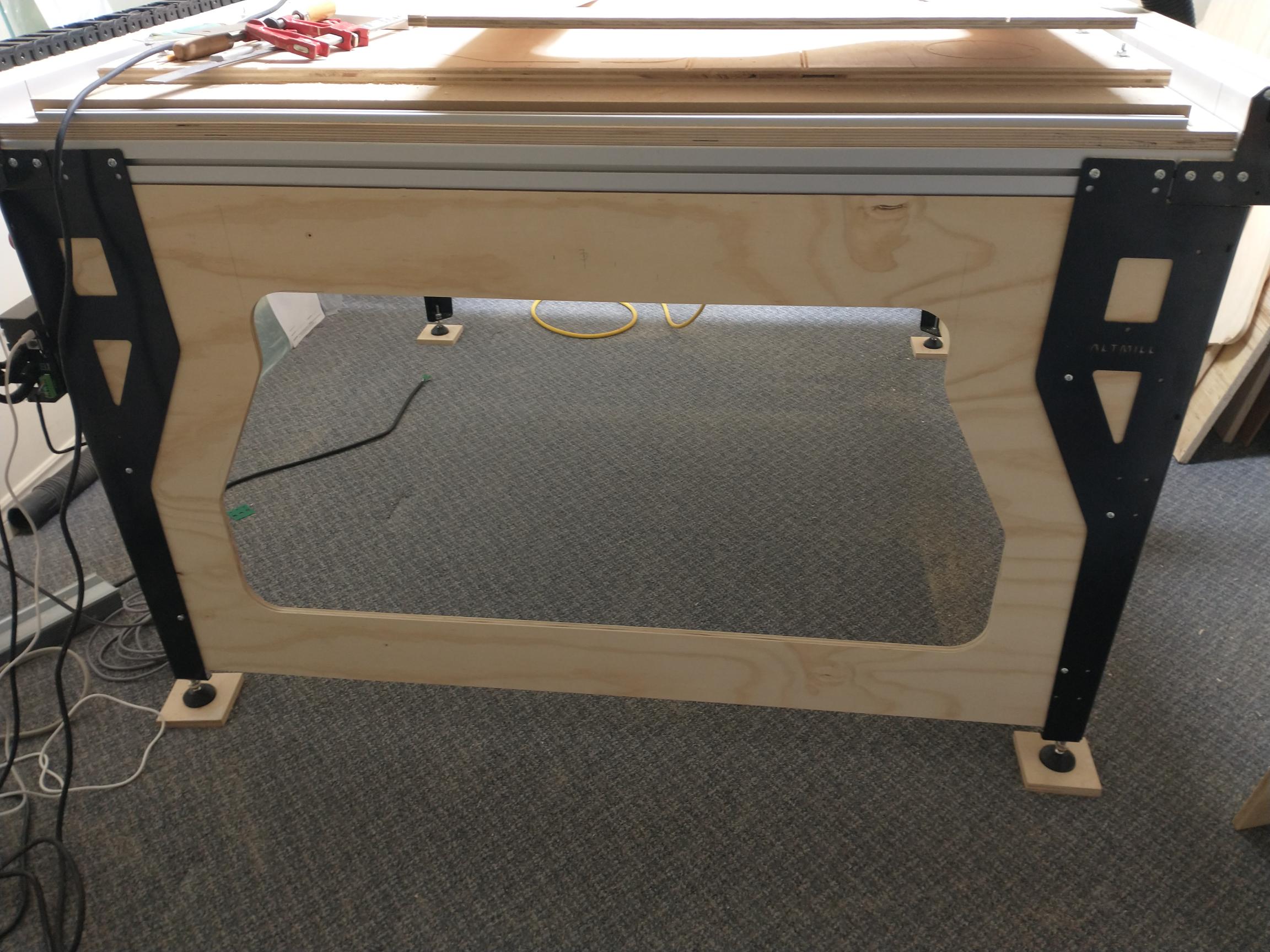

I did my first tiling job today with vCarve. It was to do the side leg stiffeners for my Altmill.
 ![IMG_20250619_165626082](https://forum.sienci.com/uploads/default/original/2X/5/537ed86a9ef16756ab77b8b1aaae5d72e6c4630e.jpeg)
It’s simple enough to do with vCarve but you do need to think it through to have good reference points or registration marks for when you move your piece.
A few thing I learned:
1. Use more tabs than you think
2. Plywood is not always flat so you need to find a way to keep it flat
3. If you use a 1/8" bit, the cut length is not very long. Be careful that your collet doesn’t hit anything. My collet rubbed against one of blocks I used as a reference edge. It left some nice burn marks. I posted here before about the risk of fire. That risk is now real for me. You can never be too careful and you might not think of everything when you do your toolpaths.

**Post date:** [June 19, 2025, 9:07pm UTC](https://forum.sienci.com/t/altmill-leg-stiffeners/17746/2 "2025-06-19T21:07:27Z")
How did you end up keeping the plywood flat?
**Post date:** [June 19, 2025, 9:38pm UTC](https://forum.sienci.com/t/altmill-leg-stiffeners/17746/3 "2025-06-19T21:38:08Z")
Screws through the ply into the spoilboard.
**Post date:** [June 19, 2025, 9:50pm UTC](https://forum.sienci.com/t/altmill-leg-stiffeners/17746/4 "2025-06-19T21:50:26Z")

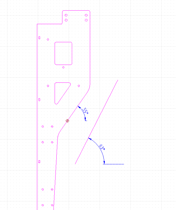

Another thing I learned…the OnShape drawings for the legs are not accurate. The drawings indicate an angle of 55° for the flared part but the actual legs have an angle of 63°.
 ![Screenshot 2025-06-19 174302](https://forum.sienci.com/uploads/default/original/2X/5/5c20c6c64fef758f0769db75e1237e4528eee702.png)
Doesn’t Sienci know that I’m a bit OCD!! Luckily, the side stiffeners will not be visible. But I’ll have to fix the profile for the front stiffener. There’s no way that I’ll be a able to look at it if the angles don’t match. Ughh!

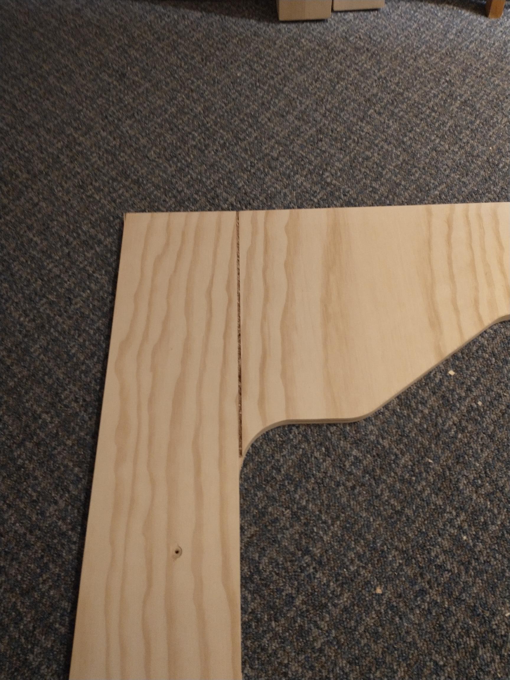

Well, I must say that i gained a lot of wisdom today. Another thing you shouldn’t forget when you tile is to change files between cuts. Otherwise, you might be asking yourself: “Why is it cutting there? Should it not start where it left off? Oh shoot!”
 ![IMG_20250619_183134689](https://forum.sienci.com/uploads/default/original/2X/6/628523a760a9c5c547d31a962346fe0c88d09255.jpeg)
No harm done. Cut wasn’t that deep.
**Post date:** [June 20, 2025, 12:45am UTC](https://forum.sienci.com/t/altmill-leg-stiffeners/17746/6 "2025-06-20T00:45:41Z")

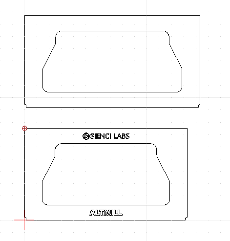

Much better with the correct 63° angle.
 ![IMG_20250619_203640067](https://forum.sienci.com/uploads/default/original/2X/9/9182a51a93e45cb58167004f0d52bf20ae85d39d.jpeg)
 ![image](https://forum.sienci.com/uploads/default/original/2X/2/25a81d0b5e4134f834ad6759aa38311ca8e25c77.png)
I didn’t bother to vCarve the Sienci logo and I got rid of the bolt holes since the legs don’t have the same holes on both faces.
Here is the DXF file with the front and side stiffeners. They all require tiling unless you just cut out the middle. If you tile, you can cut all the edges as well.
[Altmill\_table\_leg\_stiffeners.dxf](https://forum.sienci.com/uploads/short-url/xMJIsl3bGX6ecOf9J11QXSYqQHY.dxf) (165.7 KB)

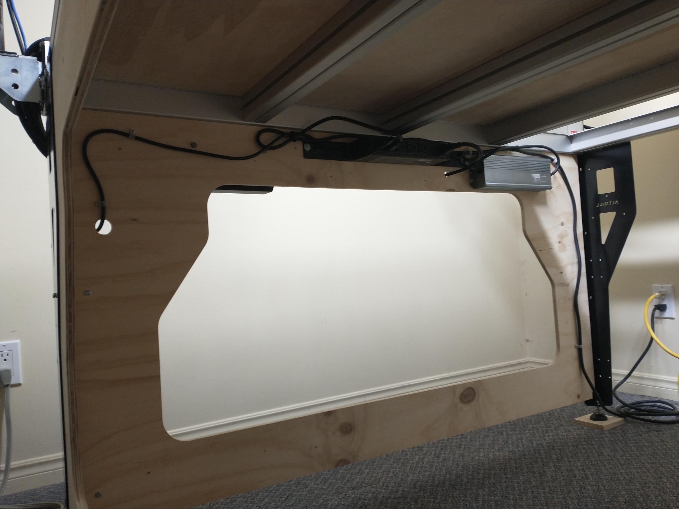

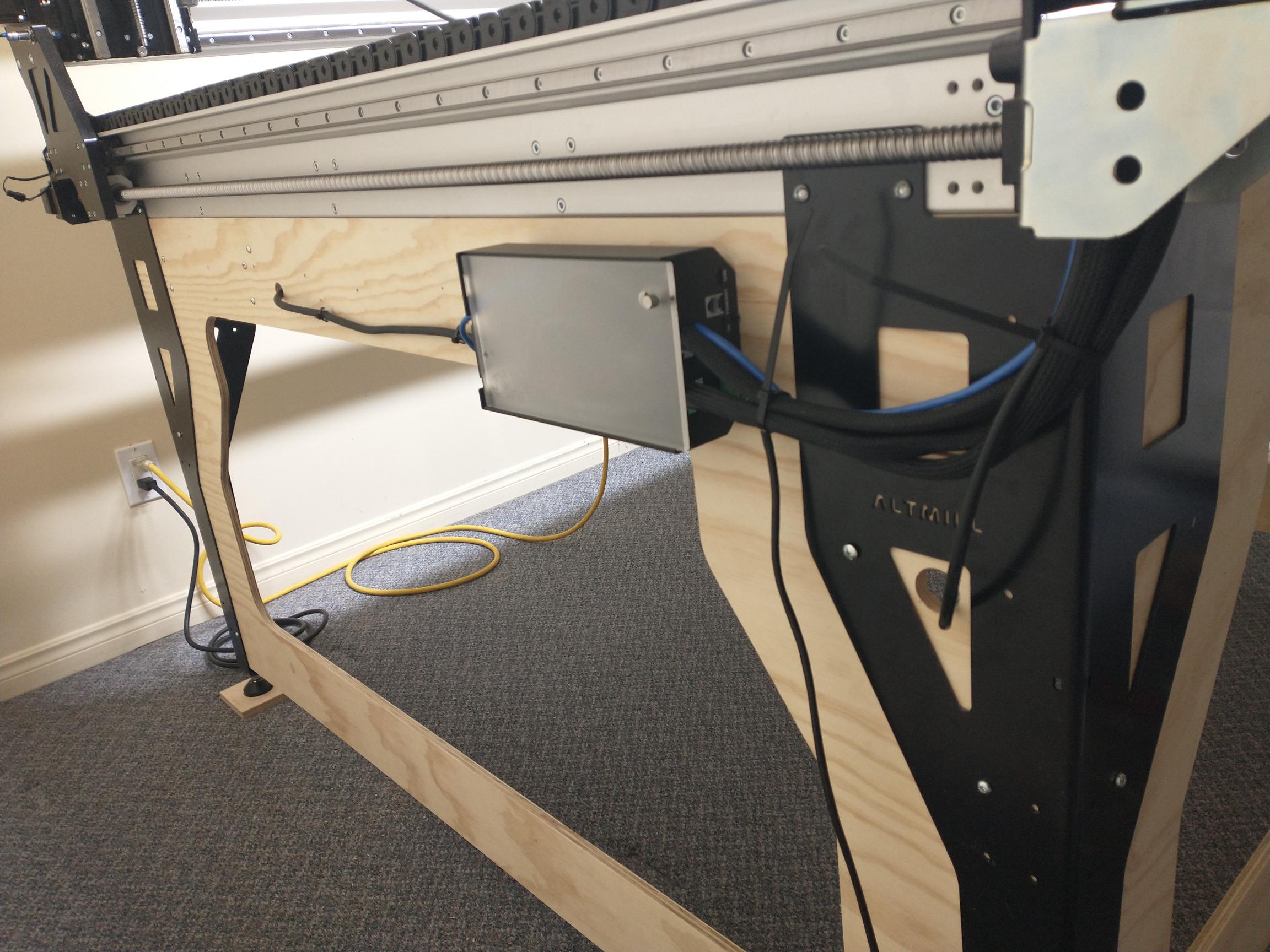

I must admit that even though I am a perfectionist, I am a bit of a slob. One of the deals I made with my wife when I told her I’d be buying a $6k CNC and that I would install it on the carpet in our finished basement (which we only use for storage anyways) was that I’d keep the area clean.
It goes without saying that one of the first steps in doing that is making sure you have good dust management . Where I usually fail is with clutter. I tend to leave stuff lying around, I have a hard time throwing things out, and I end up tripping over myself going from point A to point B. So with the new leg stiffeners, I have plenty of mount points for the various accessories. Nothing on the floor. Let’s see if it will last.
I don’t have my spindle nor VFD yet but it will be mounted somewhere in that corner. The e-stop will also go at the front. I find that having it on the side, with the gControl in the way, makes it difficult to access when you need to do an emergency stop.

Chucky, after spending some time with it do you notice it being a lot stiffer? I really haven’t had any problems with my “non-stiffened” Altmill 4x4, but have thought about adding something like this. It can only make it better, right?
**Post date:** [April 21, 2026, 1:33pm UTC](https://forum.sienci.com/t/altmill-leg-stiffeners/17746/17 "2026-04-21T13:33:03Z")
@gabo Yes, definitely stiffer, especially when the spindle is doing a lot of rapid movements in small increments. The table tends to shake quite a bit. One of my reasons for doing this was reducing the amount of stress at the table-leg interface. Those screws likely see a lot of stress and I didn’t want them to loosen over time.
I have modified my layout a bit. I have stiffeners at the back and sides. The front is just a plywood panel set further back. I have my VFD and SLB mounted to the panel. Both are easily accessible from the front. I also have a power bar on the front panel to attach accessories (e.g. vacuum, heat gun, compressor) when required. I had to reach for an outlet on the wall before.
