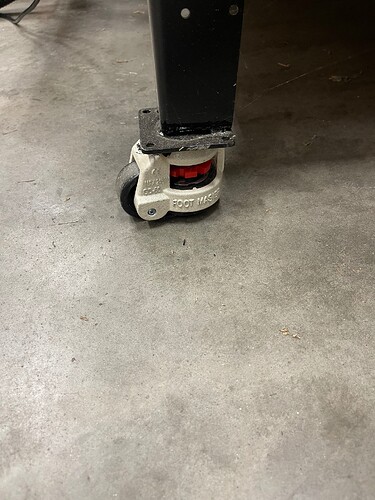

### Author: ![Ok-Advance-8430](https://forum.sienci.com/letter_avatar_proxy/v4/letter/o/b19c9b/32.png) [@Ok-Advance-8430](https://forum.sienci.com/u/Ok-Advance-8430)
#### Post date: [August 14, 2025, 9:31pm UTC](https://forum.sienci.com/t/altmill-on-casters/14204/10 "2025-08-14T21:31:12Z")
![IMG_0574](https://forum.sienci.com/uploads/default/original/2X/c/cfcad6665f7d0844ae992c8507133cdf5c220762.jpeg)
Here is a picture of 1 of them. The adjustments not bad, but I am adamant I do not like the thumb wheel.

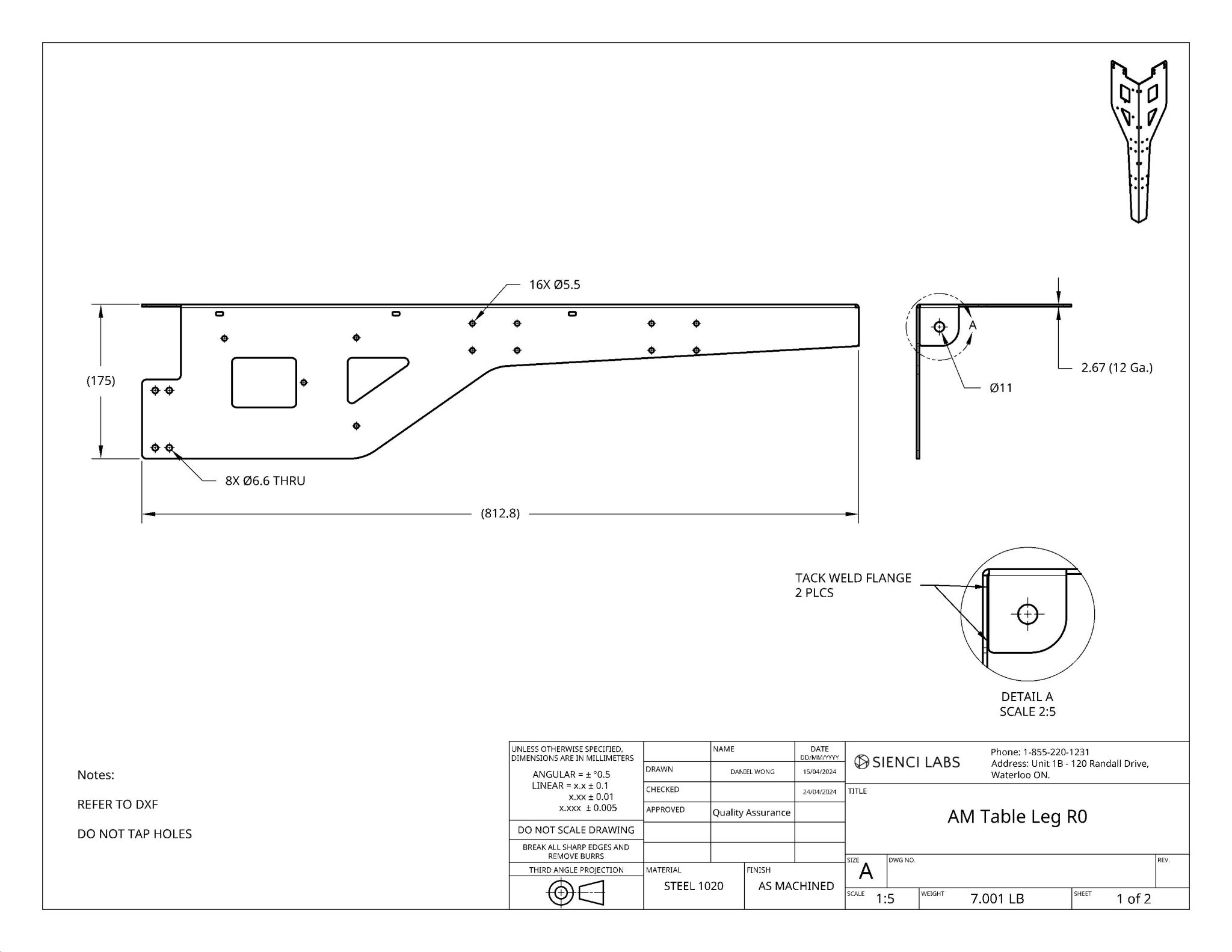

### Author: ![LightBurnSupport](https://forum.sienci.com/user_avatar/forum.sienci.com/lightburnsupport/32/10249_2.png) [@LightBurnSupport](https://forum.sienci.com/u/LightBurnSupport)
#### Post date: [September 10, 2025, 7:19pm UTC](https://forum.sienci.com/t/altmill-on-casters/14204/12 "2025-09-10T19:19:36Z")
You can find the dimensions for the spacing of the legs here: [https://sienci.com/wp-content/uploads/2024/02/AltMill-Table-Leg-Dimensions.pdf](https://sienci.com/wp-content/uploads/2024/02/AltMill-Table-Leg-Dimensions.pdf)
And specifics on the holes here:
Where a stem-caster would go is **11mm dia**
[![](https://sienci.com/wp-content/uploads/2024/04/AM-Table-Leg-R0-2048x1583.jpeg) ](https://sienci.com/wp-content/uploads/2024/04/AM-Table-Leg-R0-2048x1583.jpeg)
### Author: ![Chucky\_ott](https://forum.sienci.com/user_avatar/forum.sienci.com/chucky_ott/32/8692_2.png) [@Chucky\_ott](https://forum.sienci.com/u/Chucky_ott)
#### Post date: [September 11, 2025, 5:38pm UTC](https://forum.sienci.com/t/altmill-on-casters/14204/13 "2025-09-11T17:38:16Z")
@LightBurnSupport FWIW, those appear to be the legs on the Altmill Mk1. The Mk2 legs have a different shape and hole placement. Ask me how I know 🤔
That said, the hole on the bottom for the levelers or casters is likely the same.

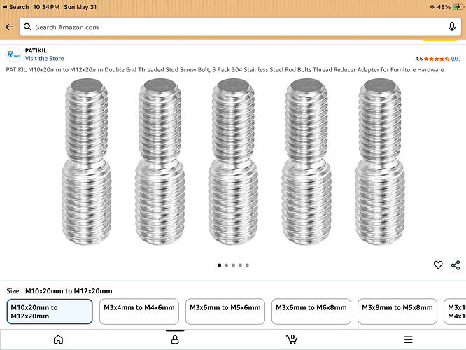

### Author: ![DPofFB](https://forum.sienci.com/letter_avatar_proxy/v4/letter/d/46a35a/32.png) [@DPofFB](https://forum.sienci.com/u/DPofFB)
#### Post date: [May 27, 2026, 12:05am UTC](https://forum.sienci.com/t/altmill-on-casters/14204/14 "2026-05-27T00:05:09Z")
Altmill Mark2 holes … about 10mm.
### Author: ![DavidB](https://forum.sienci.com/letter_avatar_proxy/v4/letter/d/76d3ee/32.png) [@DavidB](https://forum.sienci.com/u/DavidB)
#### Post date: [May 27, 2026, 2:24am UTC](https://forum.sienci.com/t/altmill-on-casters/14204/15 "2026-05-27T02:24:55Z")
I just drilled them out a bit bigger for the caster bolt to fit.
#### Post date: [June 1, 2026, 2:35am UTC](https://forum.sienci.com/t/altmill-on-casters/14204/16 "2026-06-01T02:35:59Z")
I found these on Amazon. Oe end of the stud is 12mm and fits in the casters I bought while the other end is 10mm and fits in the hole in the Altmill legs.

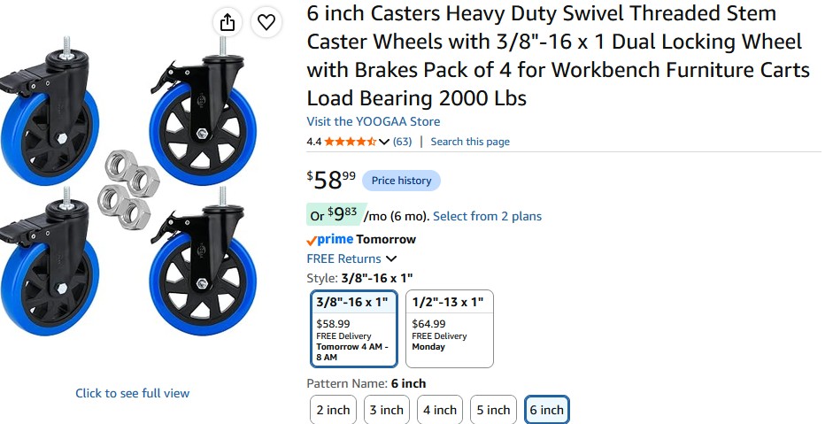

### Author: ![OsunaPete](https://forum.sienci.com/letter_avatar_proxy/v4/letter/o/dbc845/32.png) [@OsunaPete](https://forum.sienci.com/u/OsunaPete)
#### Post date: [September 26, 2026, 10:50pm UTC](https://forum.sienci.com/t/altmill-on-casters/14204/17 "2026-09-26T22:50:05Z")
Since I’m taller than average I tend to like all my work surfaces higher off the ground. When I got my AltMill 4x4 a few months ago I bought some 6" locking casters. I was able to level everything when I was installing them by adjusting the locking nuts on the stem. My shop floor is fairly flat and I always run my CNC in the same location - it’s just on casters to a) make it higher, and b), make it easy to move if I need to get around it for some reason.
Here’s what I got, and they’ve been working well:
