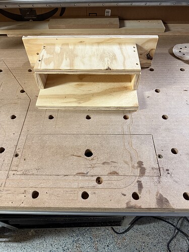

Hoping that someone else has solved the vertical milling challenges on an Altmill. Wondering if you use a drop in jig or clamp below to the cross rails but concerned about rigidity. The fine engineering group at Scienci should anticipate vertical milling and perhaps make a ready to use drop in, I’d buy one! Suggestions appreciated!

Thanks for follow and I did search but came up empty. I’ll build a drop in behind the front rail with integrated clamps. Width has to accommodate up to 12” so pics to come.

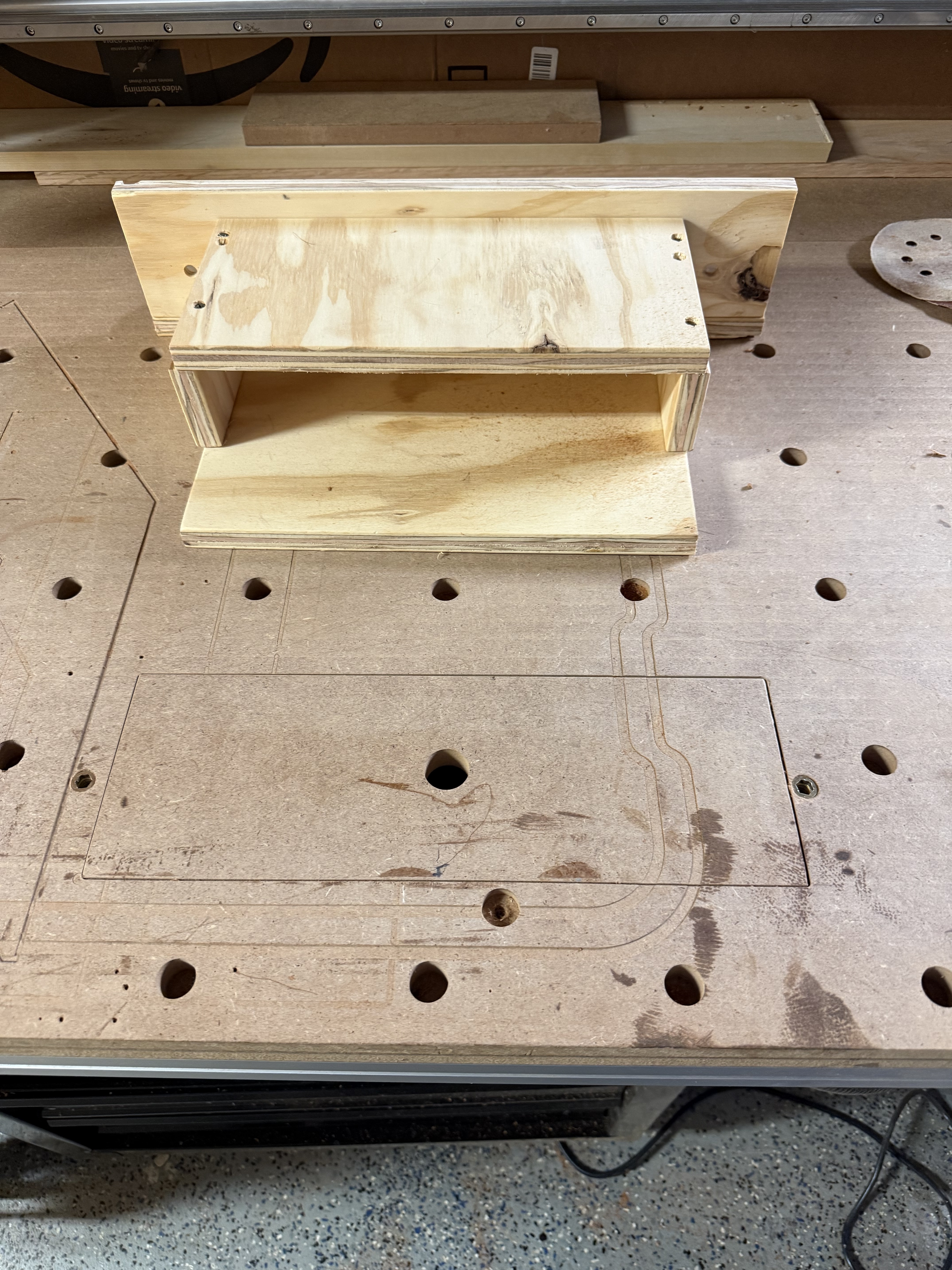

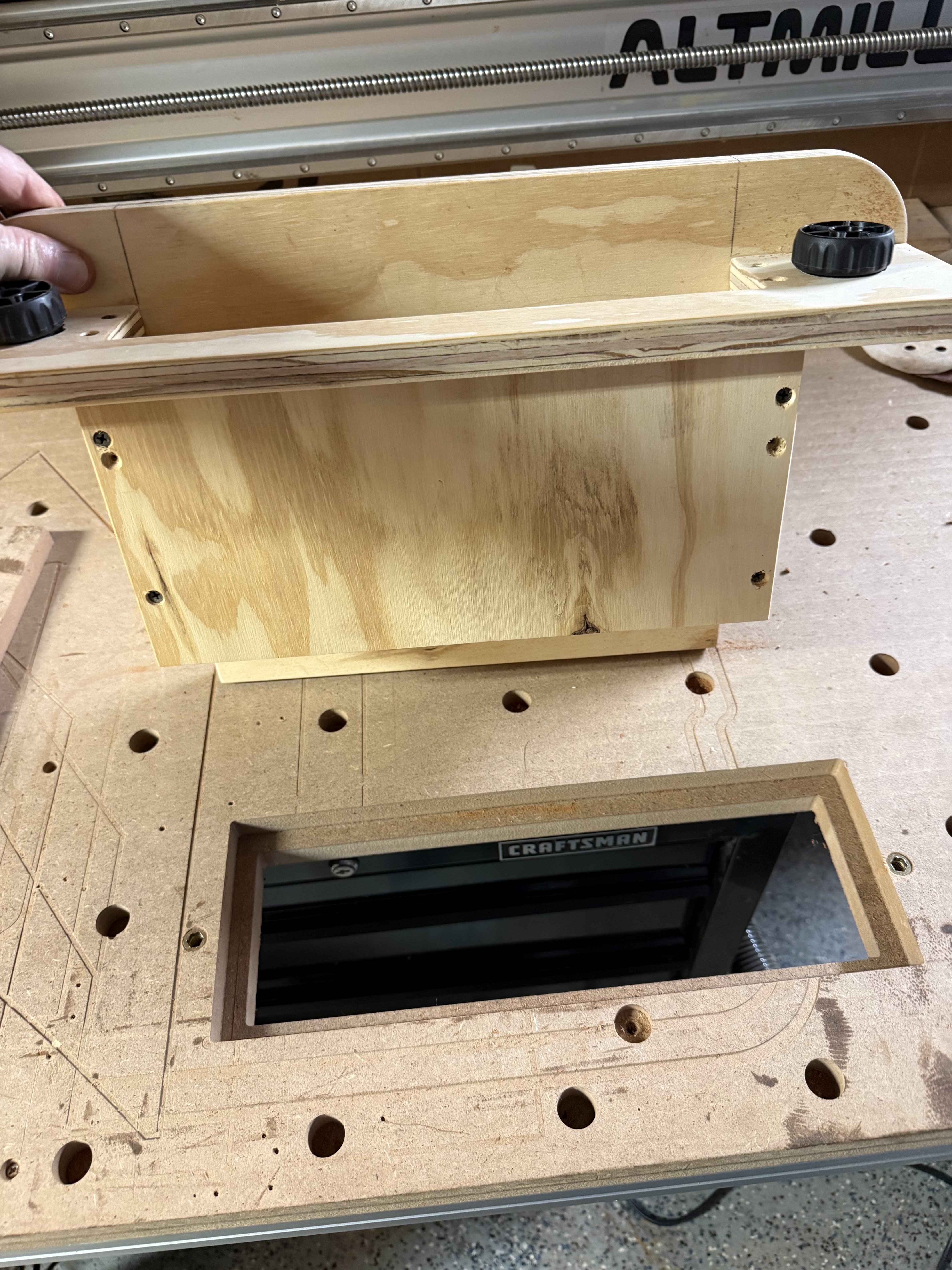

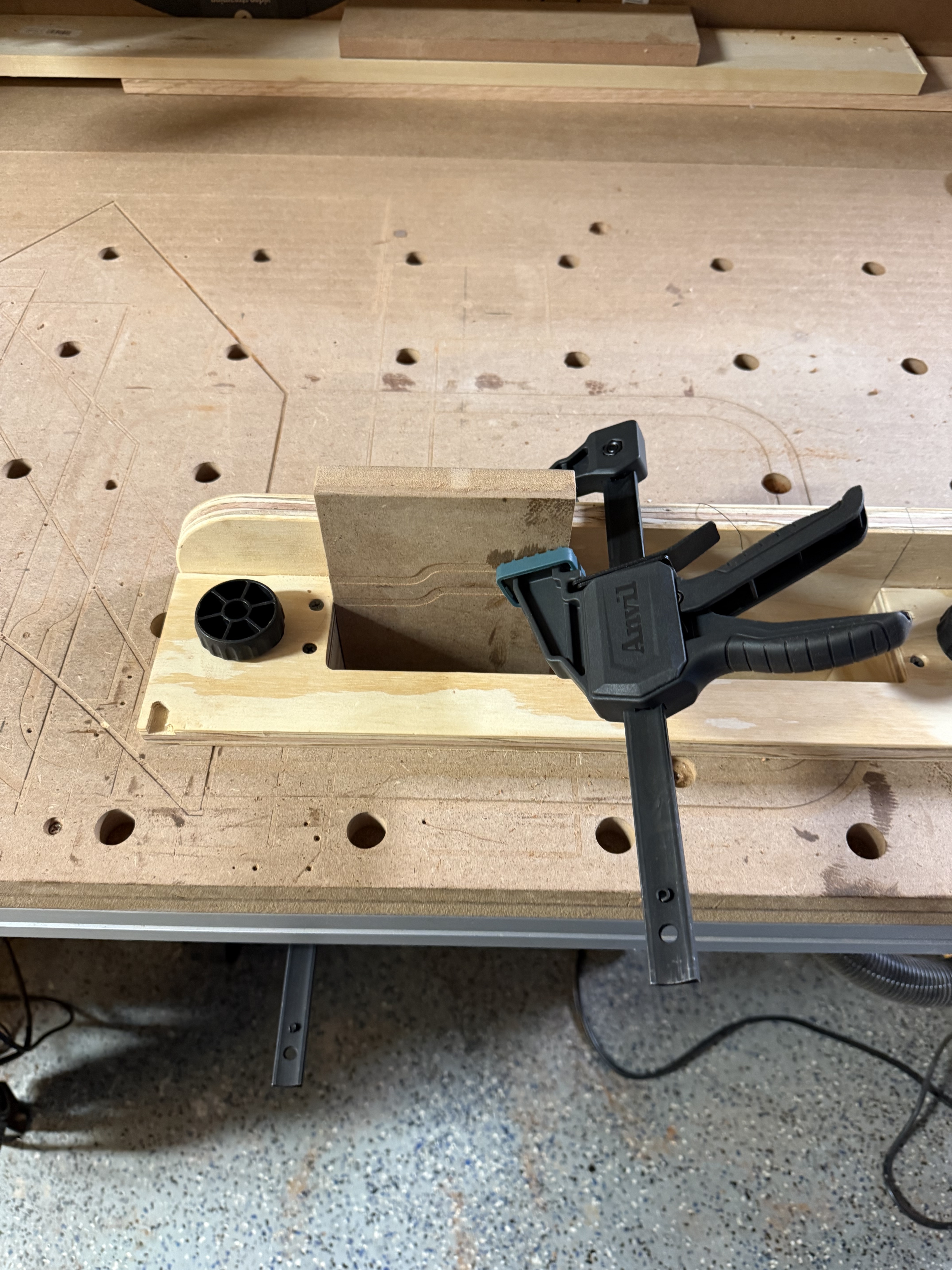

**Author:** ![Rmaustin](https://forum.sienci.com/user_avatar/forum.sienci.com/rmaustin/32/12256_2.png) [@Rmaustin](https://forum.sienci.com/u/Rmaustin)\
**Post date:** [August 18, 2026, 11:52am UTC](https://forum.sienci.com/t/altmill-vertical-clamping/26813/9 "2026-08-18T11:52:23Z")
Sturdy and square makes it easy to index zero too

**Author:** ![CuttingTheCrapAlex](https://forum.sienci.com/letter_avatar_proxy/v4/letter/c/f05b48/32.png) [@CuttingTheCrapAlex](https://forum.sienci.com/u/CuttingTheCrapAlex)\
**Post date:** [August 19, 2026, 7:59am UTC](https://forum.sienci.com/t/altmill-vertical-clamping/26813/10 "2026-08-19T07:59:45Z")
That’s pretty neat! How is the experience milling with that piece?
**Post date:** [August 19, 2026, 11:53am UTC](https://forum.sienci.com/t/altmill-vertical-clamping/26813/11 "2026-08-19T11:53:29Z")
The accuracy has been very tight and my primary goal was rapid indexing to avoid resetting XY while the Z remains constant between stock changes. If Scienci would make Z machining standard there would be little comparison when shopping for new machines. Hint.
