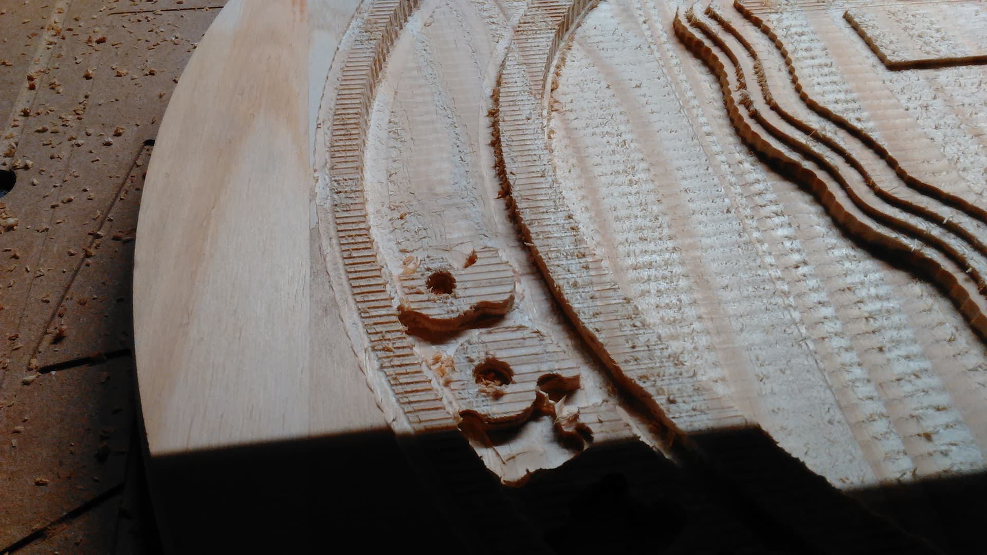

Well, I started the carve today. The roughing path went great and was looking good but now I’m on the finishing path and am completely confused by what is happening. It is still early in the tool path but…WTH.
It has made multiple passes back and forth. It seems to be scoring the surface. I’ve never noticed it doing this before but this is my first big carve. Maybe this is normal. IDK
 ![IMG_20220216_145904](https://forum.sienci.com/uploads/default/original/2X/a/a712726bc650f4d49c8e317c2eebc2faeccdafe0.jpeg)
It just doesn’t seem to be running as it has on other carves.
I used carveco maker +. It is a raster tool path. Tapered ball nose 0.62". Step over of 0.0075". Step down of 0.05". I did not change the XY zero. I did re-zero the Z for the finishing bit. Videos below

I checked my Z again and it seems it may be a tad too high. I did not surface my work piece before I started. Could having the Z too high produce results like that?
**Author:** ![Swinly](https://forum.sienci.com/letter_avatar_proxy/v4/letter/s/82dd89/32.png) [@Swinly](https://forum.sienci.com/u/Swinly)\
**Post date:** [February 16, 2022, 10:53pm UTC](https://forum.sienci.com/t/any-thoughts-help-advice-with-this-table-design/5073/11 "2022-02-16T22:53:48Z")
Dang it Dang it dang it I figured it out. I saved the roughing tool path twice. So when I did the finishing path it was really the roughing pass again.
