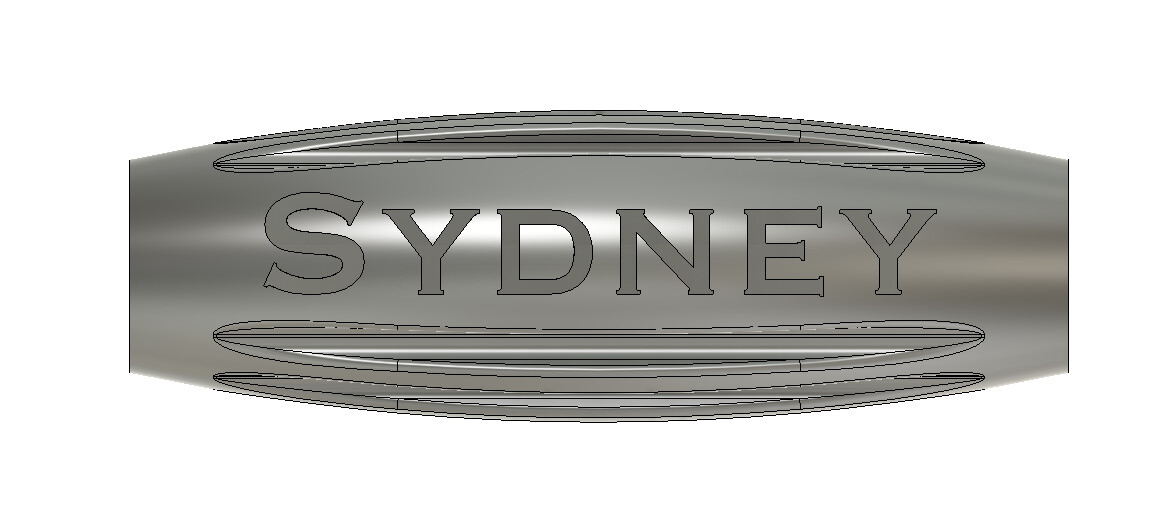

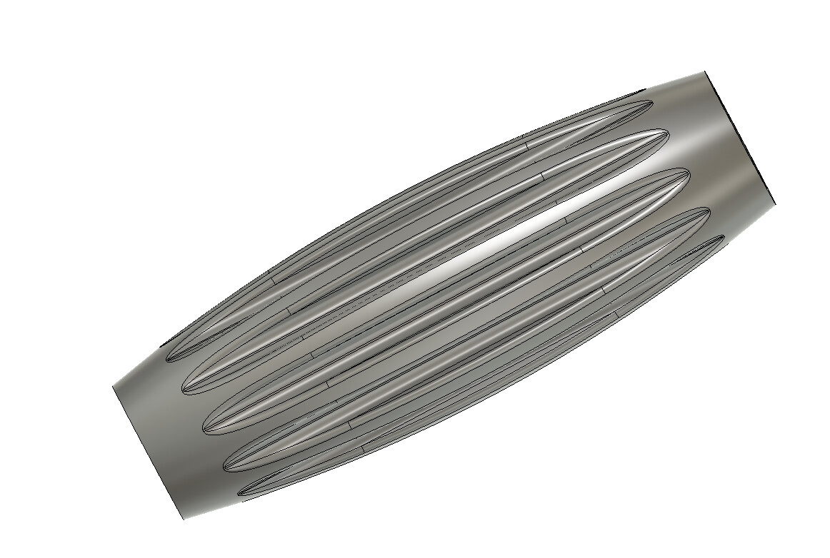

Thanks for the replies guys! This is awesome. I was wondering how I would go about drilling the center and then spinning it and this explains it perfectly. Sounds like I need a mandrel. I’m gonna try to see if I can get away with not buying all the other tools. This is what I’m working on:
