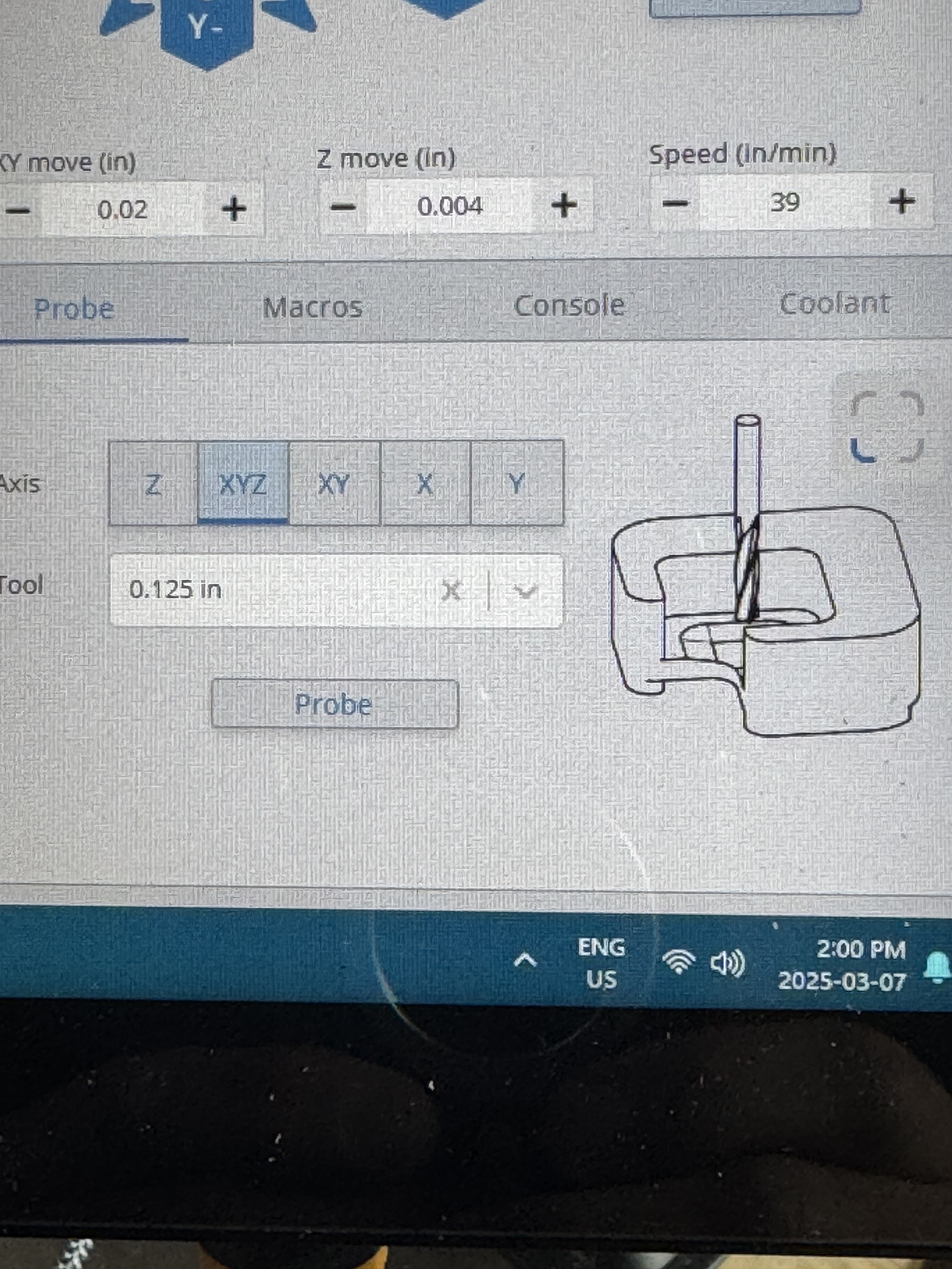

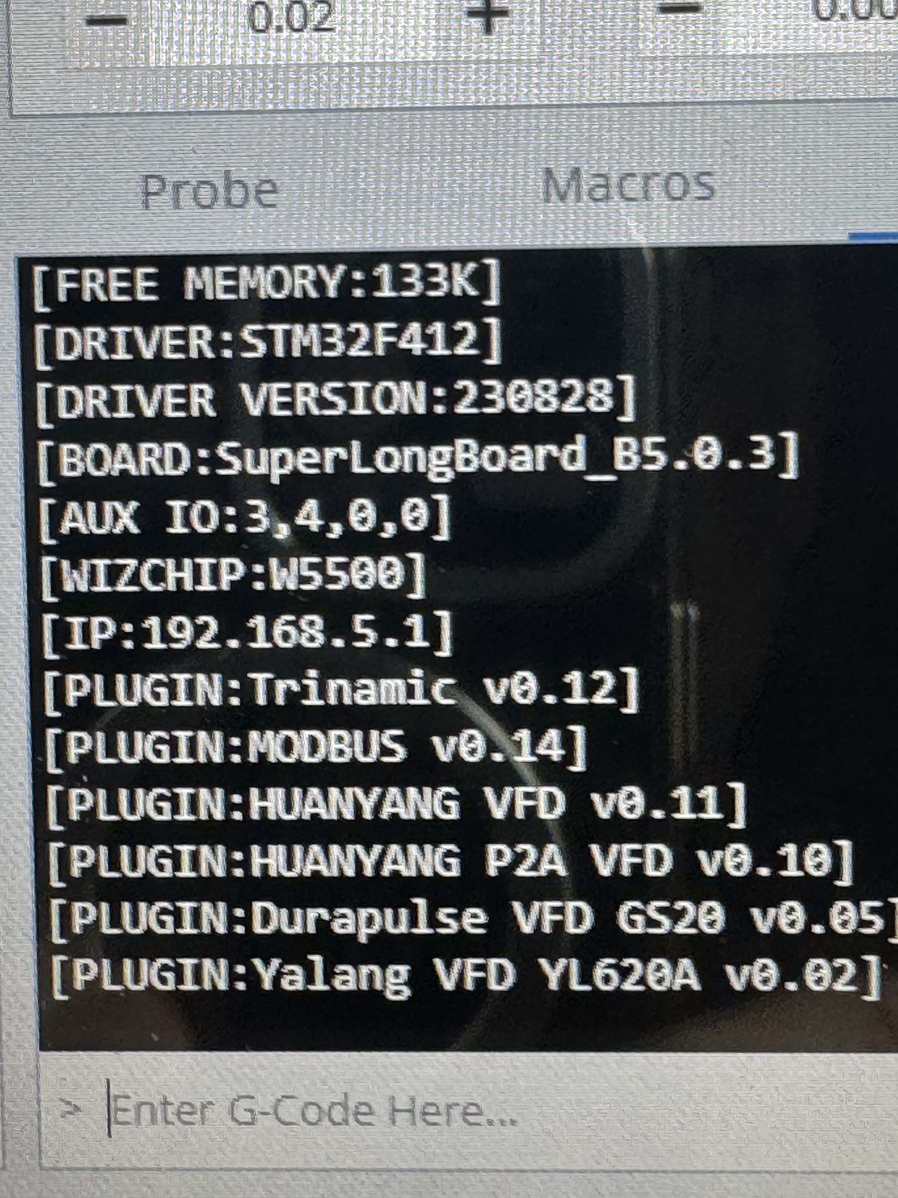

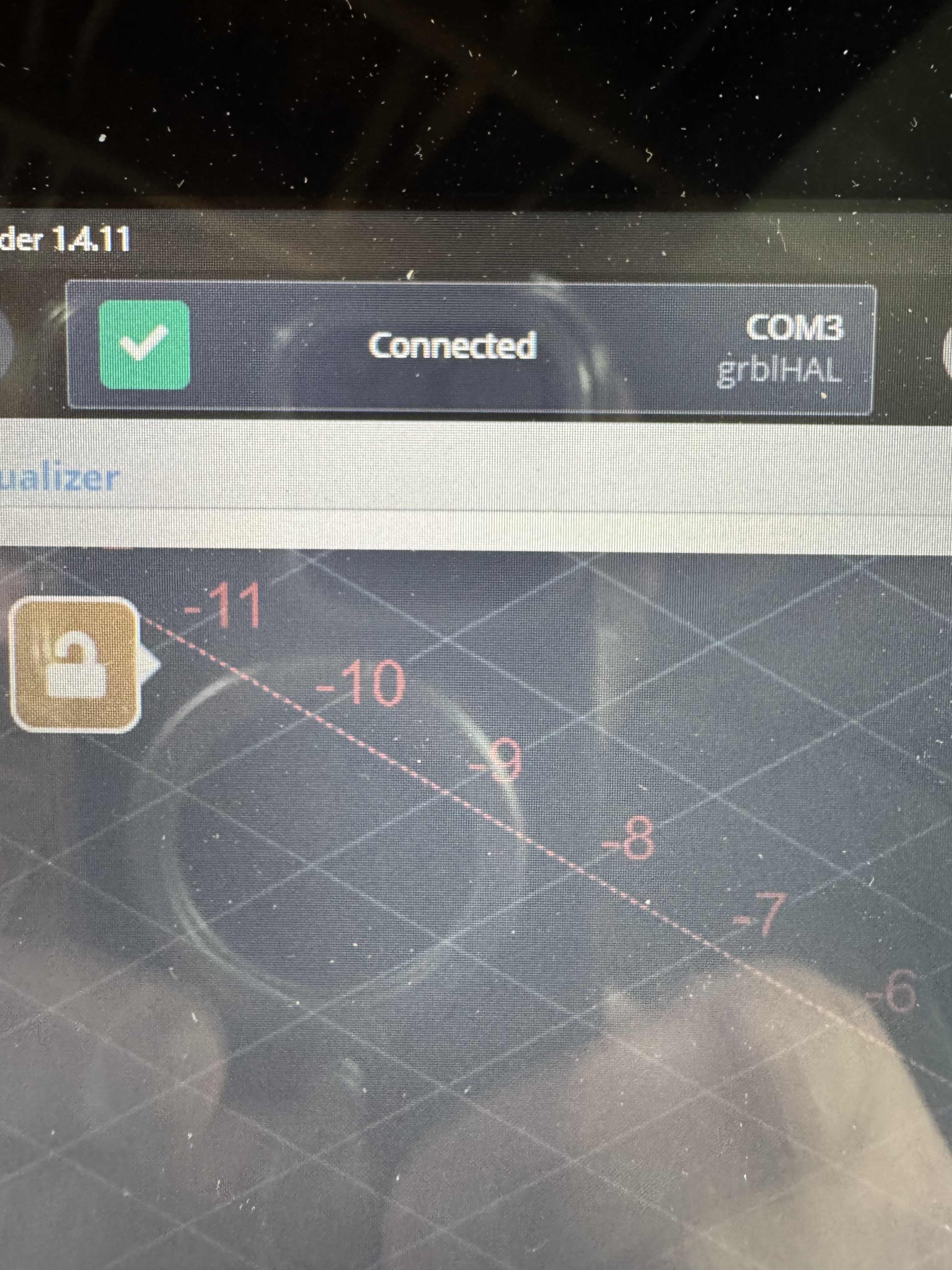

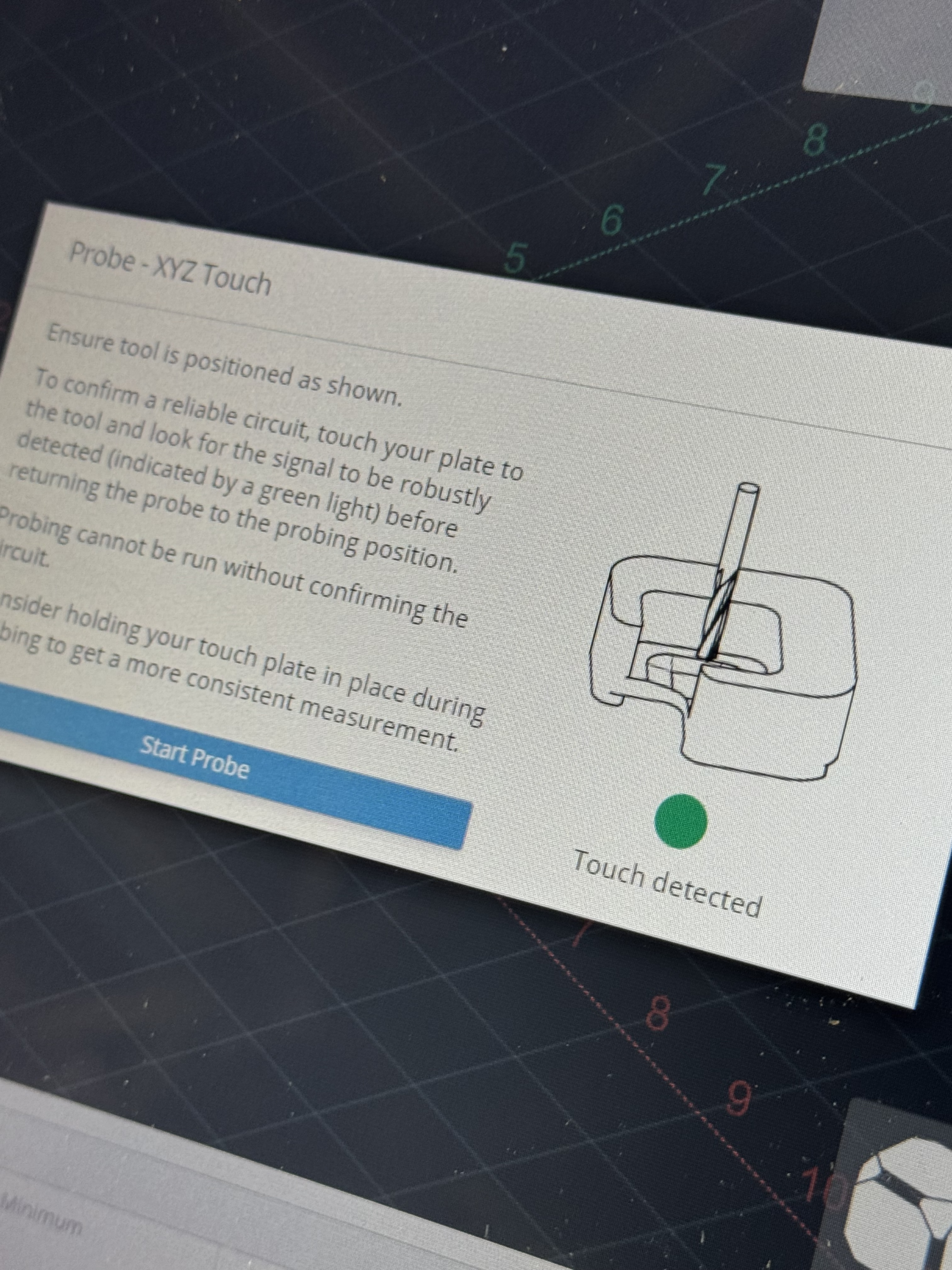

I recently upgraded to the Sienci gControl Panel . I am not having any luck getting the Auto Touch plate to cooperate. I have the Longmill MK2 and SLB.
Hi David,

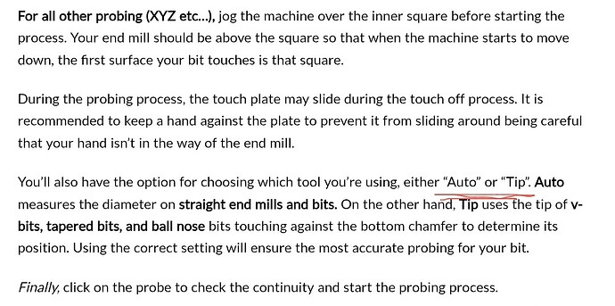

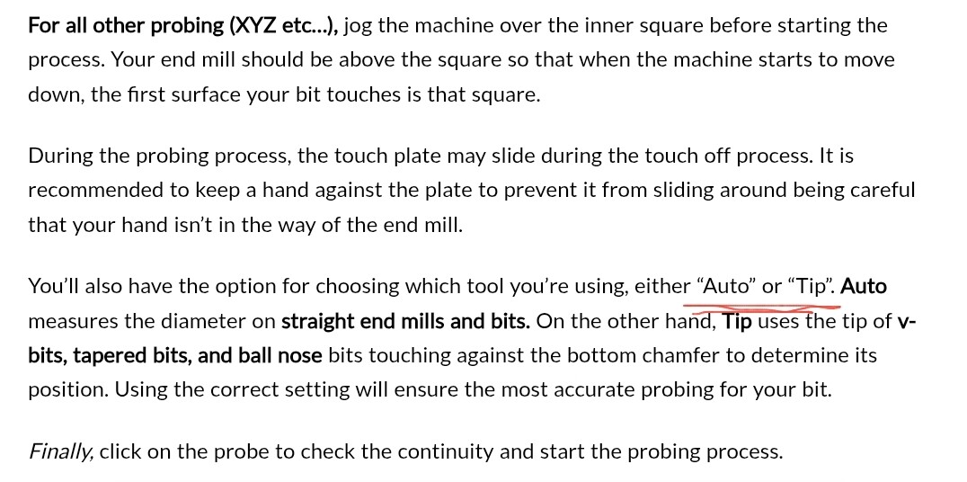

Though I have an auto touch plate, I don’t use it much so I had to look into the procedure layed out in the manual to the plate. Can it be that you selected a specific end mill (0.125inch)that prevents the atp macro from working correctly?
Complete guide here:
