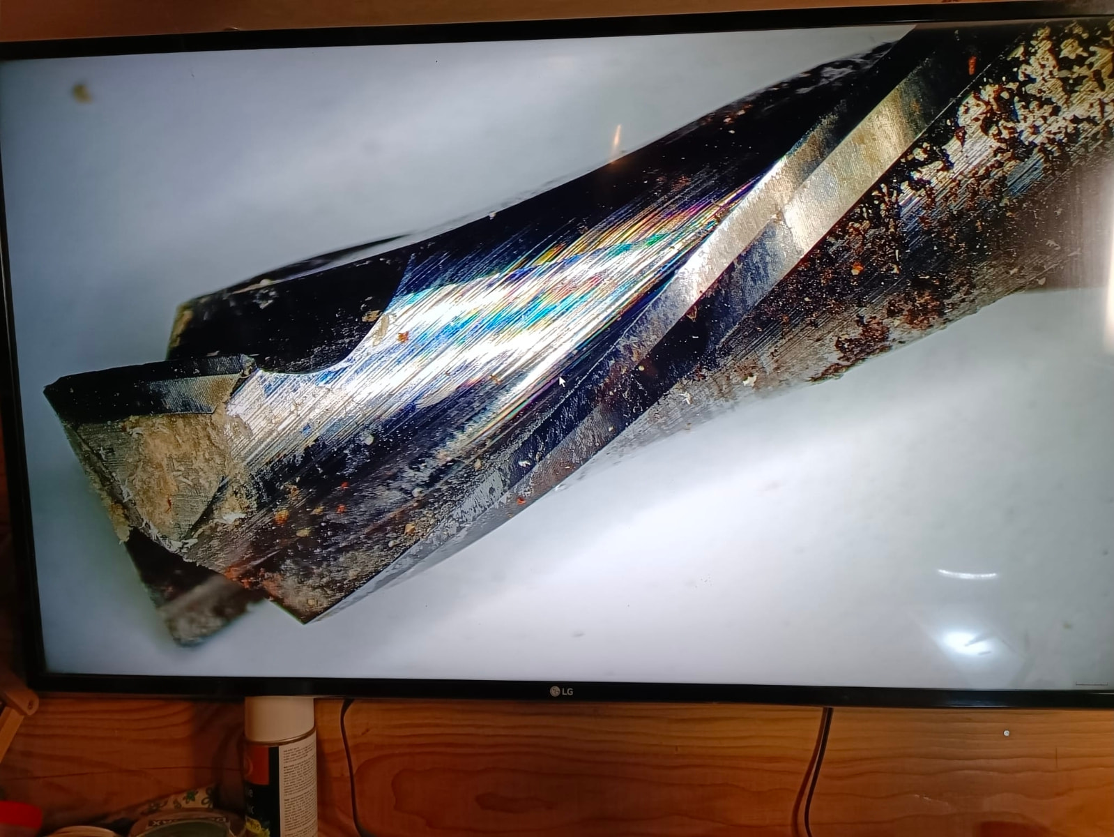

**Post date:** [April 5, 2026, 8:24am UTC](https://forum.sienci.com/t/autozero-touch-plate-question/26097/11 "2026-04-05T08:24:06Z")
> [@Chucky\_ott](#):
> Would love to know if someone looked at a bit with an electron microscope after zeroing.
Have not but could if needed. This is my microscope zoomed all the way out. Send me new tapered ball noses and I will do experiment for free, zooming all the way in on tip.
 ![Screenshot_20260405_102012_Gallery](https://forum.sienci.com/uploads/default/original/2X/b/b5aa6f881e378a95b3f80f6aeaa2e0b2761021df.jpeg)
For free!
