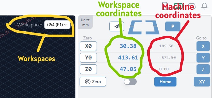

As @Jens said, there are workspace coordinates and machine coordinates. I don’t know what the standard nomenclature is for these but that’s what I use.
 ![coordinates](https://forum.sienci.com/uploads/default/original/2X/4/4b1c15c27a33f6143ac3bb148c960078d4e59e24.jpeg)
On the Altmill, the machine coordinates are relative to the home position at the rear-left of the machine. If you power cycle the SLB-EXT and rehome, the machine coordinates of any position on your bed should remain the same. I tested this within 0.01mm
The workspace coordinates can vary depending on the workspace you are in and where you zeroed the machine. Workspaces are convenient if you want to have several workpieces on the bed at the same time. For example, I did an epoxy job on one side of my Altmill and another small wood carve on another part. Each used their own workspaces with their own zeros. The epoxy job was several weeks long and I needed the Altmill for other things while the epoxy cured.

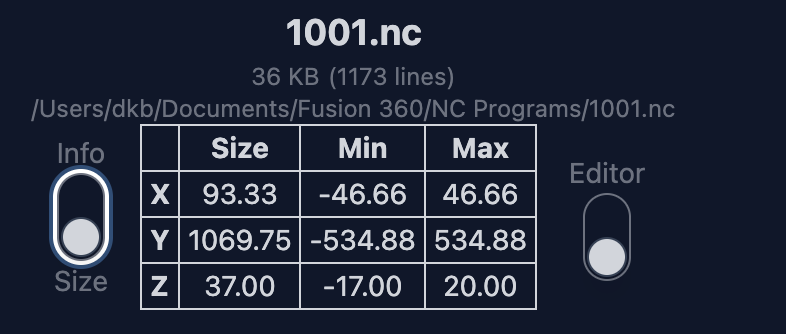

If you want to do an air carve while your workpiece is on the bed, there are several methods that come to mind. FWIW, I’d do an air carve without any bits installed.
1. Using the same workspace, just move your Z up by a known distance and re-zero Z. After you have done the air-carve, lower z by the known distance and re-zero Z. Be careful when you do this. Depending on how much Z travel your actual job has, you may hit the machine limits or have you spindle move down into your workpiece (hence my suggestion to remove the bit )
2. Do your air-carve in a second workspace. For the second workspace, use the same X0 and Y0 but a higher Z0. The same precaution on clearances apply here. Also always keep track of the workspace you are in beofre hitting the start button. I have had instances of a workspace reverting to G54 without my knowledge. This usually happened if I had an Alarm in the workspace I was in. This may have been fixed in the newer updates.
3. Instead of doing an air carve where the spindle actually moves, just do a check on file load. When you enable this, the file will run without moving the spindle but you will see the entire progress in the visualizer. So install your workpiece, set the zero position, and then load the file. It will generate alarms caused by limits just as if you were running your actual job. There were are few instances where I could not get out of check mode so I had to manually type in $C in the console

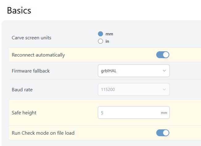

@DavidB If you have your workpiece installed and it is fairly thick, I’d avoid #1 and #2 unless I was absolutely sure that I would not hit anything in the z direction. You’ll get an alarm for any movements exceeding the top limit of your spindle. But you’ll not get that alarm in the downward direction.
I think gSender gives you your job’s Z travel so that you can calculate your clearances. You can also set soft limits and gSender to limit the travel. I do this when I use long roughing bits. They could potentially plow into the spoil board and even the aluminum cross rails if you’re not careful. It goes without saying, always have the e-Stop button close by.

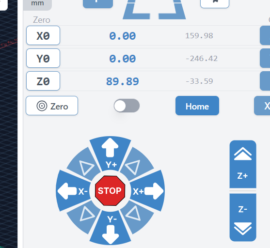

Mark a center spot on your board that you want to carve-and lets assume that is where you want to call 0,0
move the machine to that XY and zero your machine – by clicking XO Y0 or you can zero all if you like – keep z high enough for safety but within bounds of machine as you look at actual machine.
If helpful, Check these out by manually moving your altmill in gsender and watch the left box
 ![image](https://forum.sienci.com/uploads/default/original/2X/0/01a84ed2b596d34fd1285854326a1b34f3cbd0ac.png)
Ignore the right grey numbers for now though it will change in the same direction likely and reflects the distance and direction away from its home position too–
The blue numbers are what is going to drive the carve. In my example I am at 0,0 89 .89 mm above the z 0 and assuming i am using mm as default units.
Going down pushing z- button would show 89.89 going toward 0.
Move left right up and down viewing the numbers - this confirms what is happening.

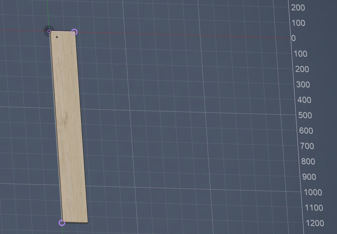

Thanks for the detailed response! I am still trying to carve first thing (holes in spoil board)
Right now I keep getting error because the gcode generated is outside the machine boundaries:
One of the lines for instance:
**G0** X-40.631 Y531.982
 ![Screenshot 2026-06-04 at 4.05.17 PM](https://forum.sienci.com/uploads/default/original/2X/0/05dab0f9027f8bcd04db9460439e7fe7d1b278cc.png)

@DavidB move your spindle to your workspace zero (using the GoTo XY button). What are the corresponding machine coordinates (grey numbers)?
Looking at your screenshot, your zero is at the centre of your workpiece.
When it cuts it will move to a maximum of 46mm to the left and the right of the X0 and a maximum of 535mm front and back of your Y0.
If your machine coordinates at your zero location doesn’t allow that +/-46mm x travel and +/-535mm y travel, you’ll get the alarm.
