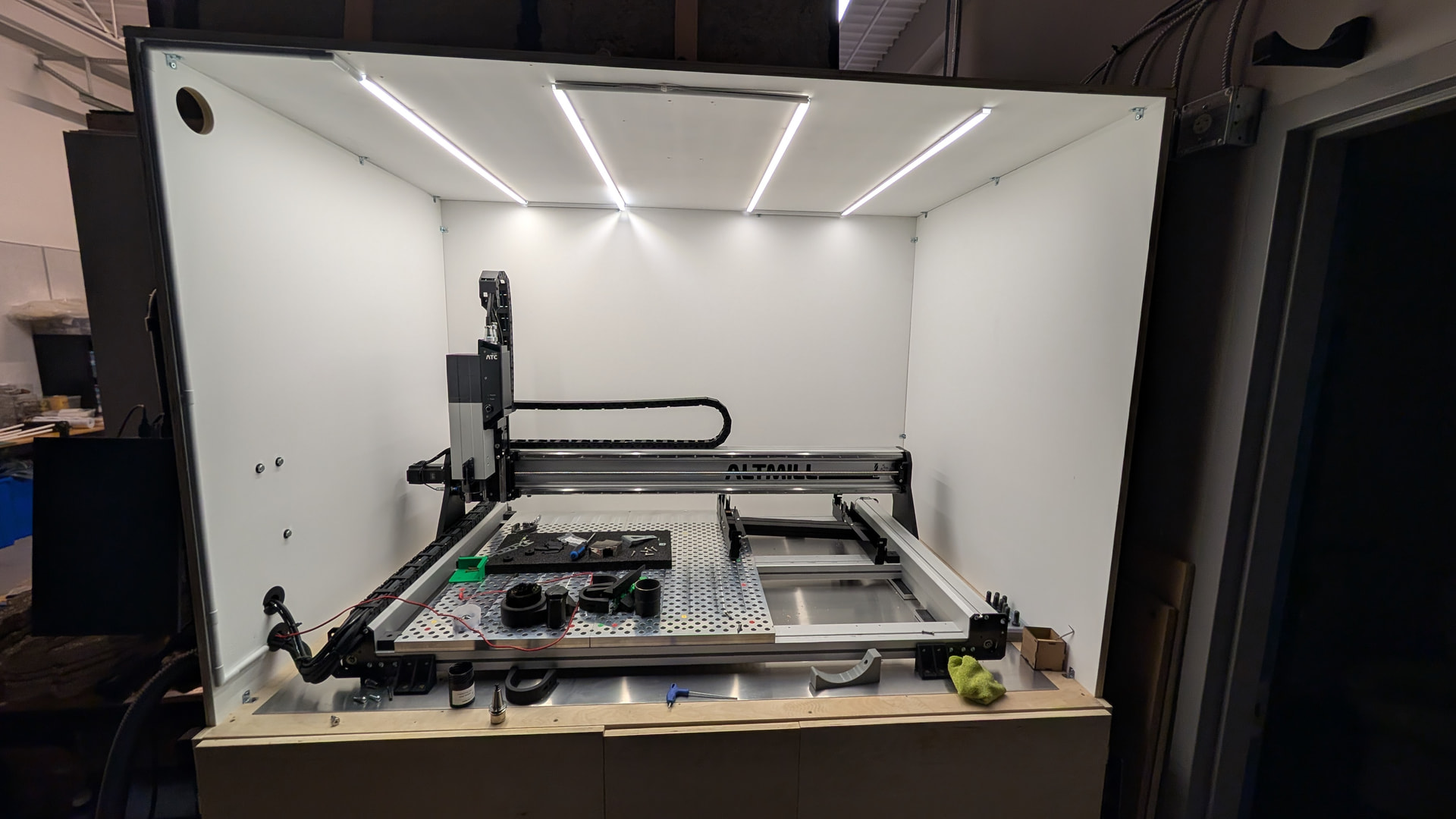

Ended up deciding to just go ahead and make the enclosure 48" tall.
There’s absolutely no real need for it to be that tall, but I just can’t afford to have the machine down again for another enclosure upgrade because it needed to be bigger… So bigger it is for me.
That said, I’d still say 41"–43" provides plenty of room for anyone looking to build a shorter enclosure setup. My setup is just a bit more extreme because of the ducting, vacuum configuration, and the possibility of raising the machine again later on.

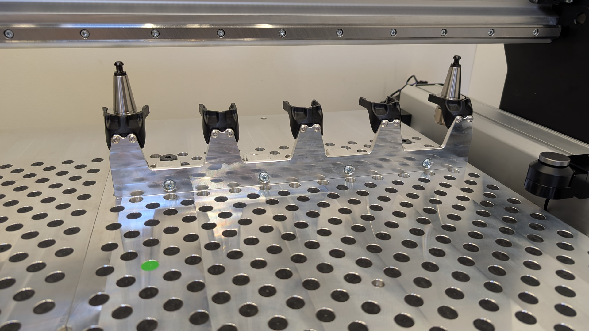

I also got around to putting together the 6-tool rack and… as I suspected, it doesn’t fit my configuration with the fixture plates — both in the X direction and in terms of the space underneath.
I didn’t get around to taking measurements yet, that’s tomorrow’s job.
At this point, it looks like a custom solution is going to be the only way to make everything work properly. The good news is I should still be able to make it removable so I can retain the full functionality of gsender and the full cutting area when needed.
 ![PXL20260513034744086](https://forum.sienci.com/uploads/default/original/2X/8/8f492af5a5756c998a43666d1a82a7a97c88e30b.jpeg)
Most likely will have to also look at a retractable/auto detactable dustshoe design…

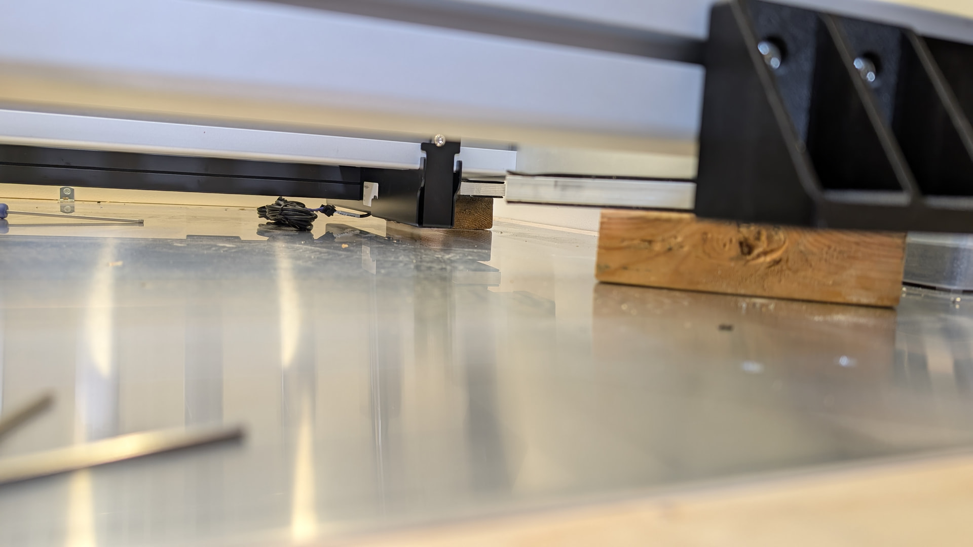

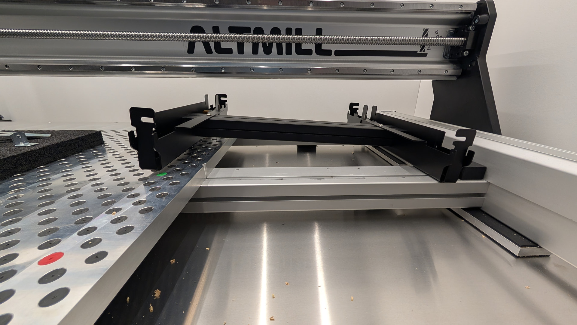

For anyone planning to get the ATC and use the Sienci 6-tool holder rack:
You’ll need to lift the machine by approximately 2 1/8".
- 1/2" aluminum block
- 2x4 (which is actualyl 1.5x3.5)
- 1/16 neoprene rubber x2
Otherwise, the tool rack sensor plug won’t clear properly underneath the machine.
 ![PXL20260513191234251](https://forum.sienci.com/uploads/default/original/2X/a/a6111678dcba8201ed9f3aef835b3a1724ee1b08.jpeg)

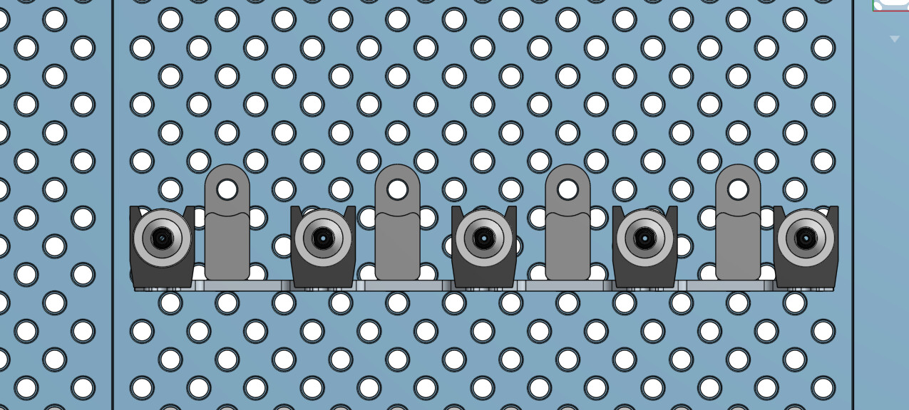

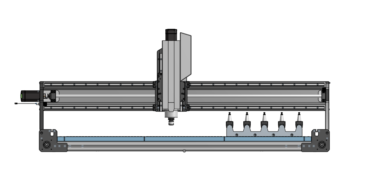

Also pulled all the critical dimensions for the ATC setup needed to design the custom rack and dust shoe system - including the ATC spindle itself and the OEM tool holder locations that Sienci Labs uses.
 ![image](https://forum.sienci.com/uploads/default/original/2X/b/b442f02e2997cd0739c666d2e5ff74047dbf64ff.png)

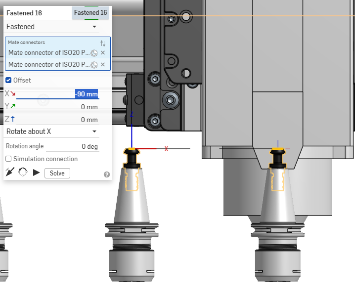

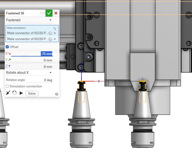

Seeing it laid out like this actually opens up the possibility of designing a custom tool rack directly on top of the fixture plate, since none of the tools we use have particularly long stick-outs.
In the OEM location, the distance between the bottom of the tool holder and the fixture plate sits at 38.69 mm. That can also be increased by another 5 mm, bringing total clearance to 43.69 mm (1.72").
The spacing between the tool holders also sits at 90 mm center-to-center, which appears to have been designed around the dust shoe that comes with the ATC.
 ![image](https://forum.sienci.com/uploads/default/original/2X/9/9198c2c3e3f398ba1a6e9f70c3c9e78e1af03528.png)
A custom solution **might** be able to bring the spacing down to around 75 mm.
If that works, I could potentially fit all 6 tools onto a single fixture plate. Otherwise, I may turn this into a 10-tool system instead — starting with 5 tools on one plate, then adding another 5-tool plate later if needed.
We’ll see where the measurements and clearances end up landing.

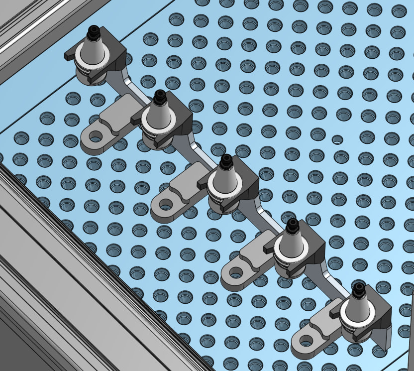

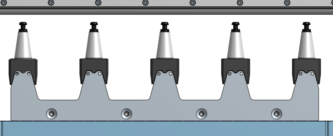

Oh man…went down a giant rabbit hole. Spent a bunch of time modeling this. I think I’m going to go with a 5 toolholder rack with standard Sienci spacing which is 90mm a part. It gives me the ability to make 2 of them and add a 2nd one when I need to. I did move the holder up by 5mm, but this is just optimizing at this point.
I’ve reached out to Sienci labs to see if I can get the actual tool rack clips STEP they’ve designed. For now I’ve just captured something to give me the critical dimensions for making the face plate.
 ![image](https://forum.sienci.com/uploads/default/original/2X/e/e89c4dd81fef6d9b84893a7e44ae59b88e5ad24b.png)

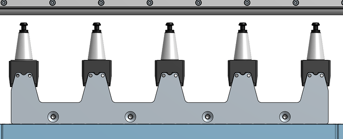

I havent finalized the “front plate” yet, but I might make it more of a shield, so the 4 notch down isn’t as low.
 ![image](https://forum.sienci.com/uploads/default/original/2X/8/88e328cf0dcb70a827595d62e7d17cddf8c43721.png)

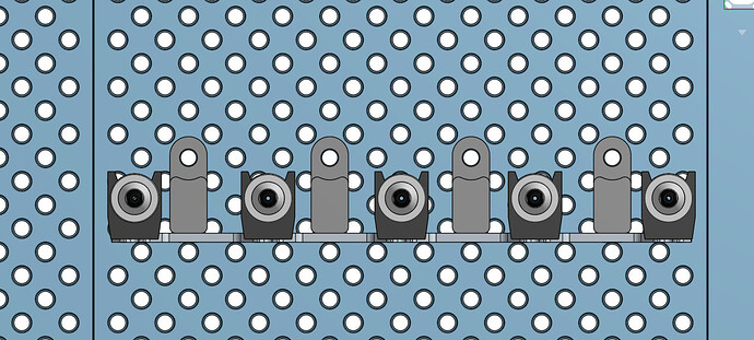

Below is how I plan to build the “hold downs” and fixture it onto the build plate. I might keep the “rack sensor” by putting it behind one of the hold downs by using 2 dowel pins for registration and quick removal when I need to remove the rack.
 ![image](https://forum.sienci.com/uploads/default/original/2X/2/29bd07898ea43b2cb50b2be63c5ad84cc6840db2.jpeg)

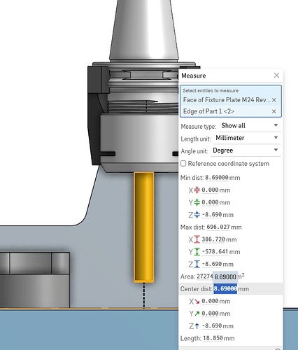

 ![image](https://forum.sienci.com/uploads/default/original/2X/1/1444c6590961f396b5fe9fdf9f8b7b0856b672ce.jpeg)

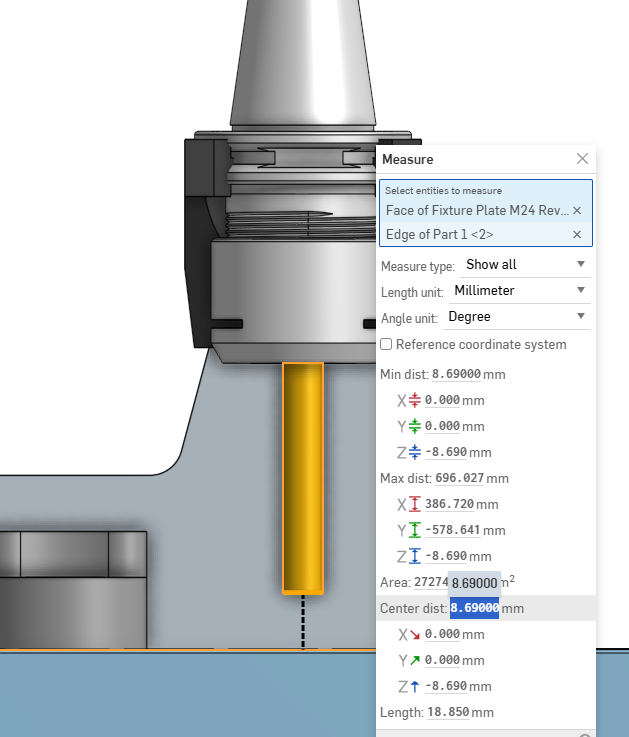

simulating a 35mm stickout on a 6mm endmill, still have 8.69mm of space.
 ![image](https://forum.sienci.com/uploads/default/original/2X/d/d1927d0282ef53b354104d60eb2590c2eb037826.png)

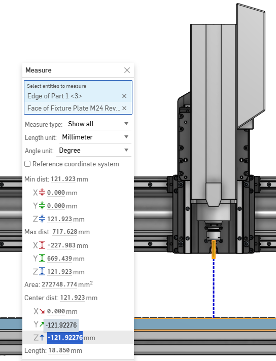

With the spindle all the way up, I still get 121.92mm (5.19") of Z area cutting with 35mm stickout on the tool. minus any fixturing.

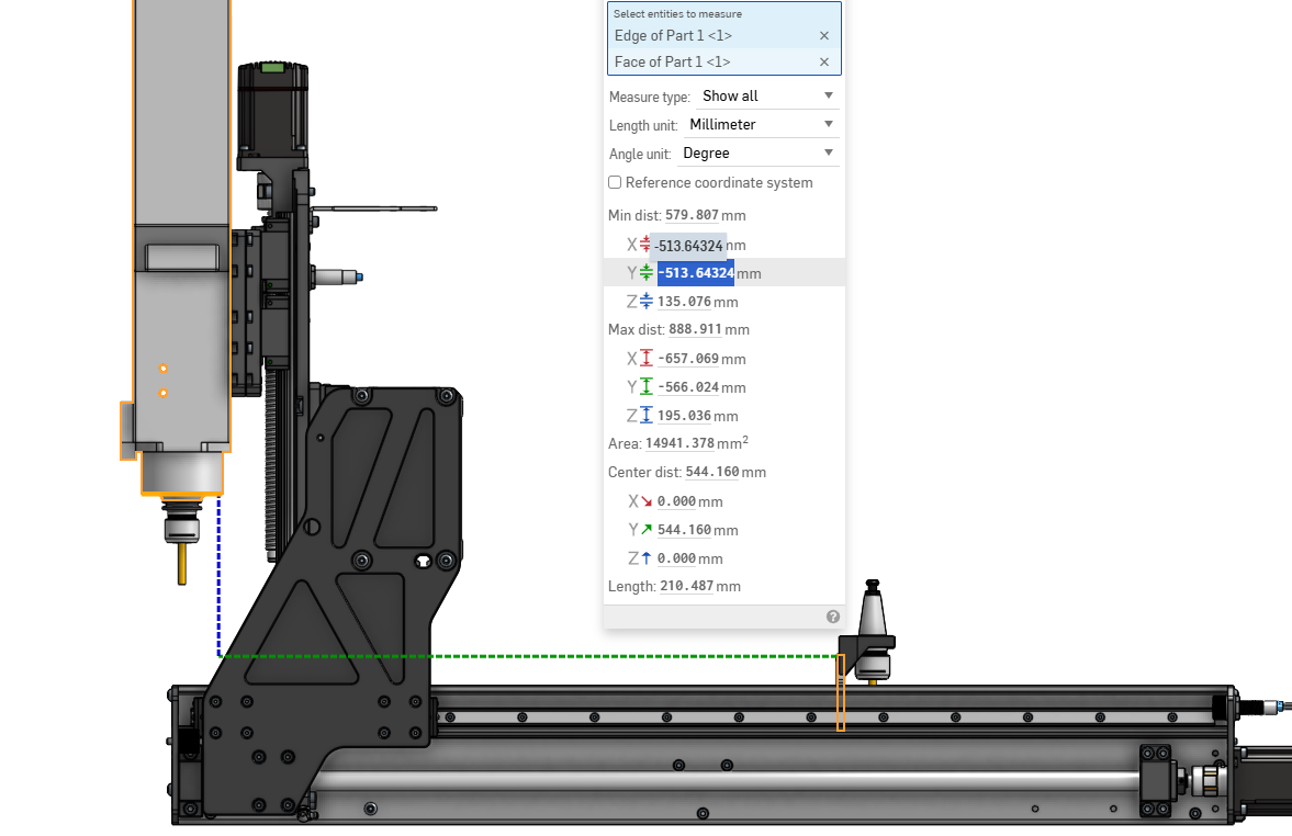

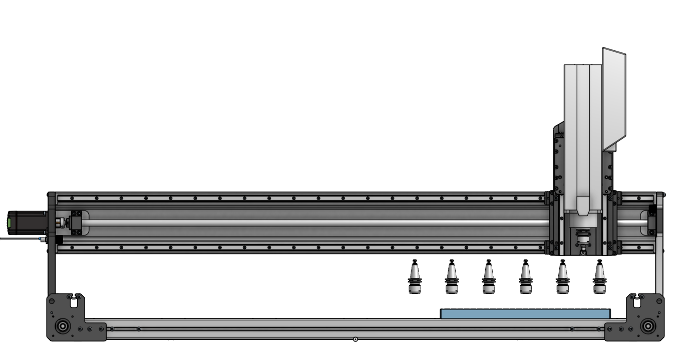

With the carriage all the way up front, The Y axis cuttable area on the stock OEM tool rack position 513.64mm (20.22") which is right around where Sienci Labs states their rack would reduce it to. with the fixture plate setup I could move the rack back by a fixture hole, which would give 31.75mm (1.25") extra space. in the Y. so I think if I’m really pushing for maximum cuttable space, it’ll be somewhere around 21.5"
 ![image](https://forum.sienci.com/uploads/default/original/2X/f/f4000dce6eee8c23ed99bb95b6c005a7c9e89d2d.png)

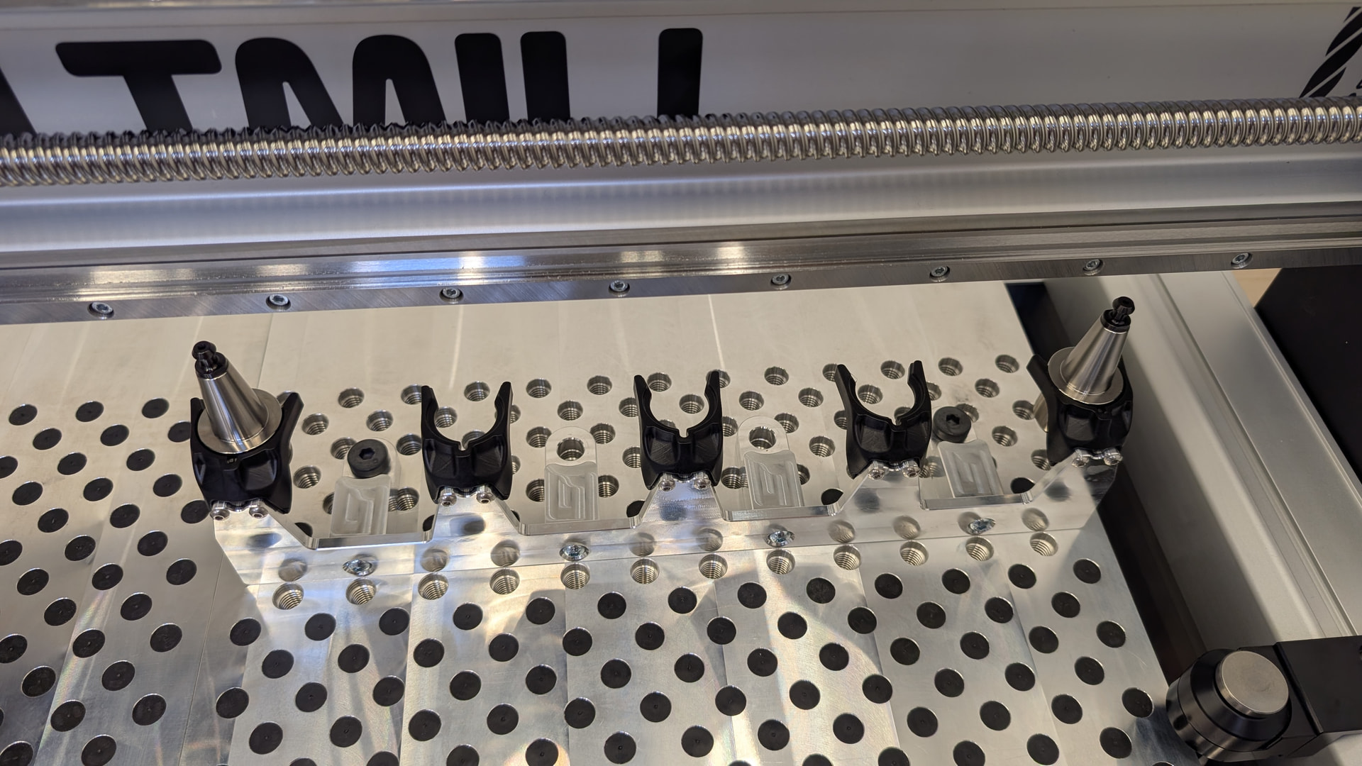

Had a friend help with getting the brackets and plate made while I was setting up the machine.
For those with a keen eye, don’t judge my cap screws in counter sunk holes, had to work with what I had at the time. Flat heads are on the way. 😄
 ![PXL20260520003929287](https://forum.sienci.com/uploads/default/original/2X/2/2d6b814921b2c0ad4861340d3683148079e6ec90.jpeg)
 ![PXL20260520003920751](https://forum.sienci.com/uploads/default/original/2X/7/7ef75fbeb74647e59011cb1bacdddf5013880f53.jpeg)

For anyone looking to setup their own custom tool rack. Here is the process to follow. (This process might change with software updates)
1. Start setup wizard
2. For **Rack Size** Pick 6/12 tool rack to setup
3. apply the controller settings
4. re home the machine
Up to this point, its all the standard setup
1. for rack position pick **manual**
2. Move the spindle directly over the taper (the menu will ask you to remove the pull studd, I did not) I centered and lowered the spindle so the tapers lined up. and left about 2mm gap.
below is the instructions by Sienci labs for this step
`In the setup wizard, use "manual" to define the position of the left-most pull stud (i.e. Have the spindle taper directly on top and enveloping the first pull stud, then set that as the location of your rack. You may have to try it a few times if you don't get the height right the first time around since the spindle drawbar will push the tool holder out by 2mm from the locked position and if you set the pickup location too low, the forks may not be able to soak it up.`
1. After setup is complete, turn off the controller, remove the SD card and find the P100.macro in the root of the SD card.
2. Open P100.macro and edit the field \<\_tc\_slots\> so that instead of 6 / 12 it equals to 5.
3. Reinstall the SD card, restart the controller and re-home (ideally from outside of the rack area to prevent crashes).
4. Try a tool change.
\*\*Inside the P100.maco you’ll also find other values to adjust such as the tool spacing, you’ll find the default of 90 in there.
One of the other thing I had to adjust is the tool change keep out area when the rack is installed and the sensor is active. I have my TLS at a location that was in that keepout area but I didn’t find any reason for it in my setup for now (this might change after the dust boot is designed). So I had to adjust the Y axis keepout value so that the probing sequence would work otherwise I kept getting an error 2 soft limits hit.
