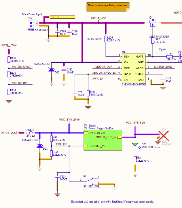

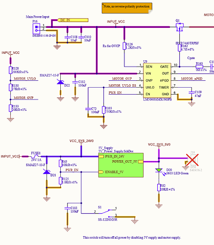

IT seems it does. According to the open loop SLB schematics designated FUSE1 protecting for amps, not for slightly higher voltages. Does the board do anuything at all or is it dead in the water without green powerlight?

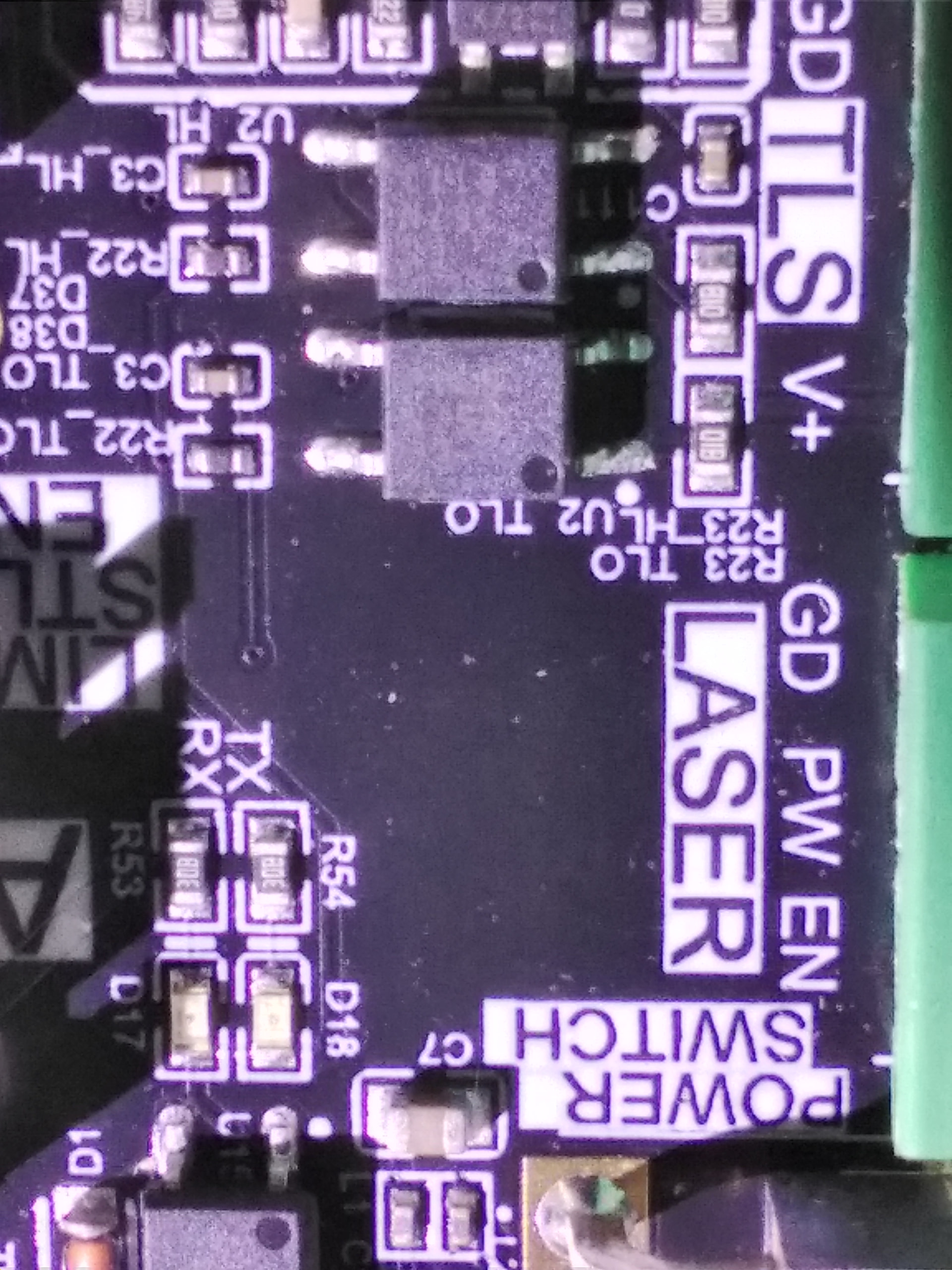

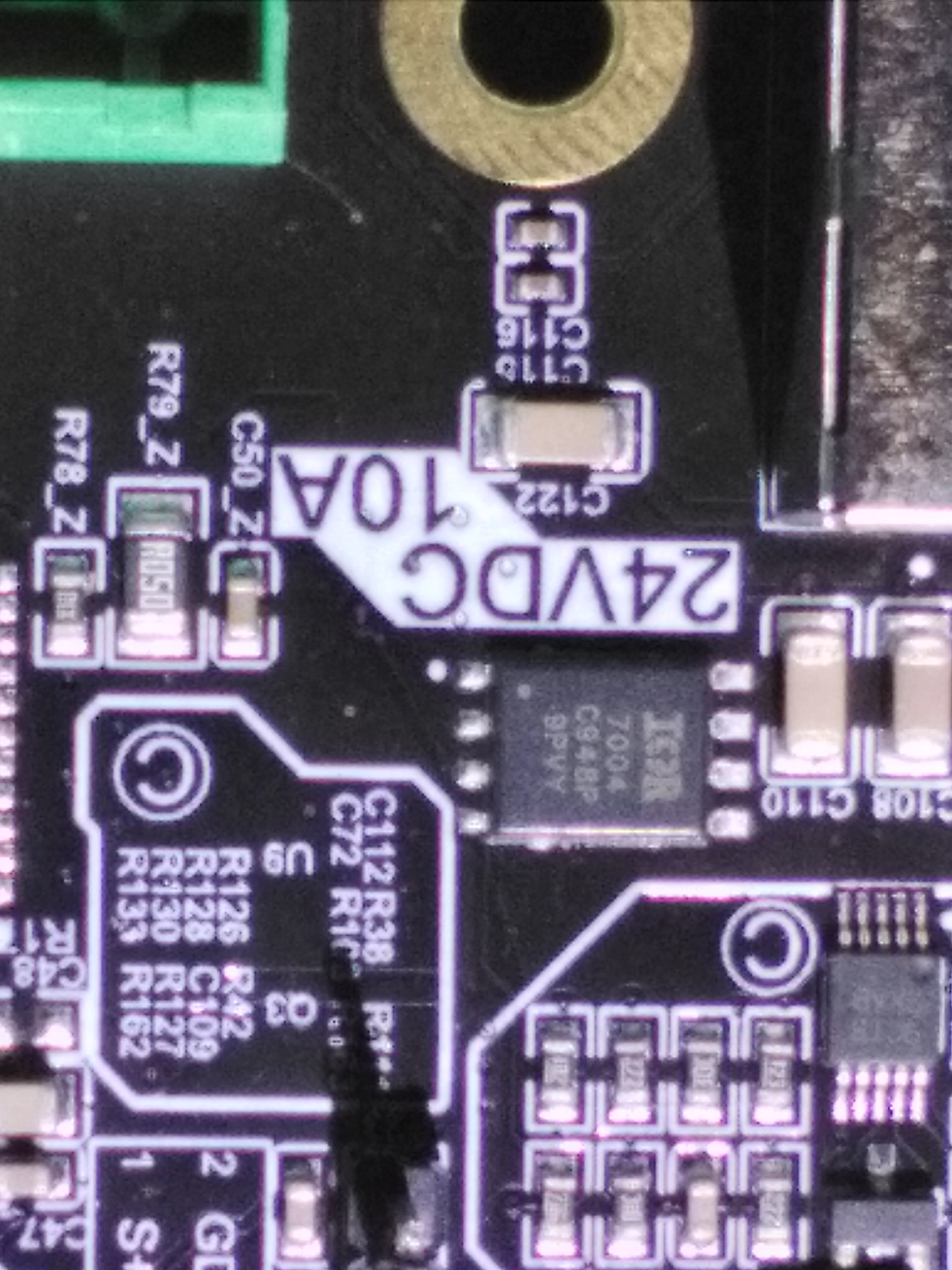

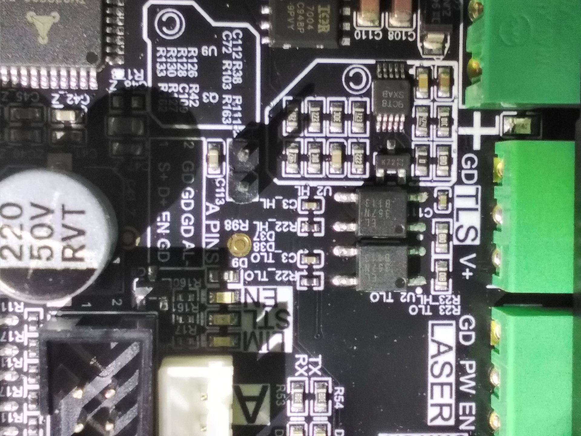

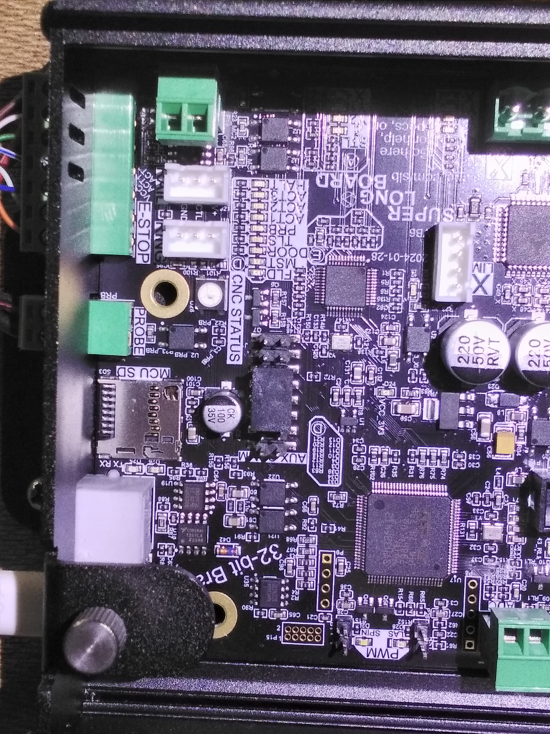

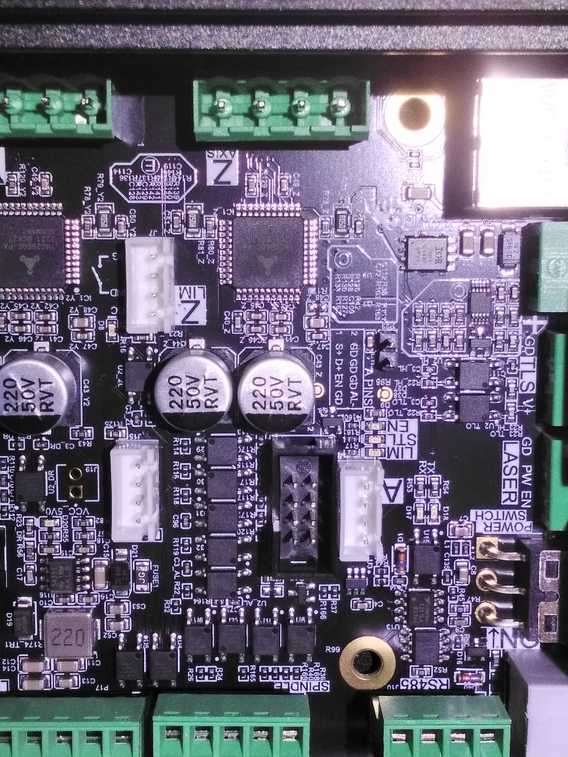

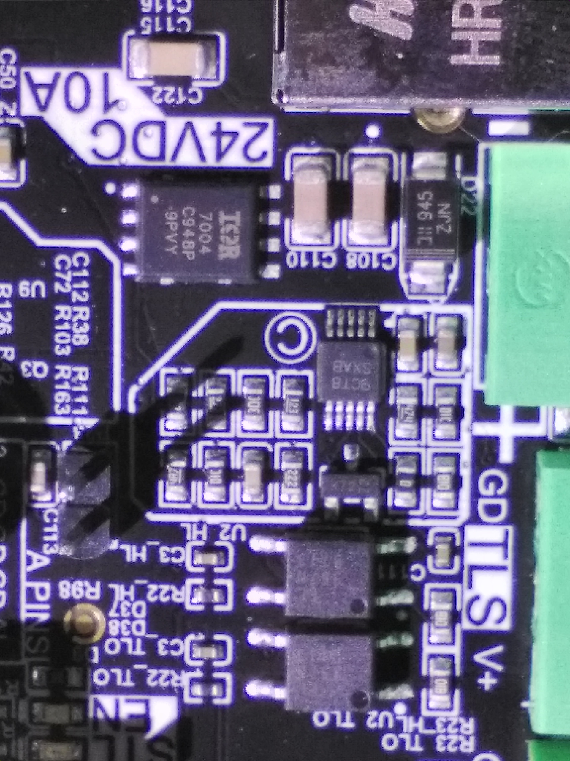

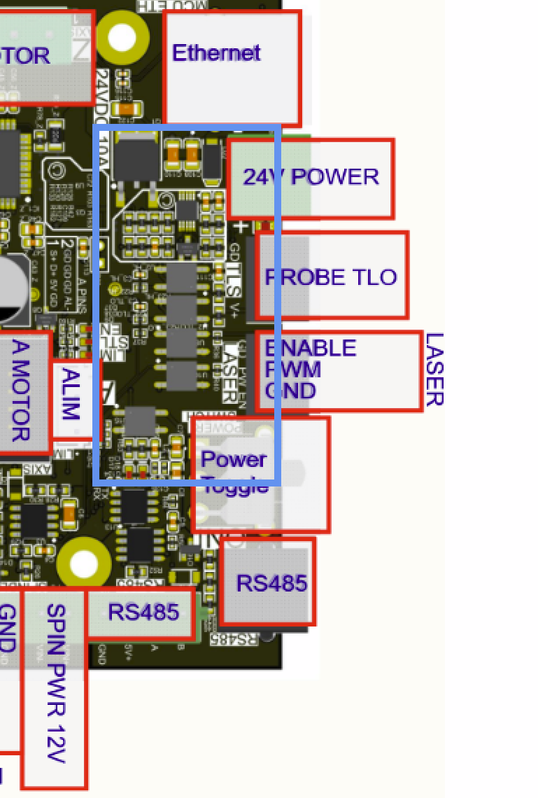

Since I donot own a standard SLB nor do I have access to better quality board picture, I cannot help l;ocate it for you other than show where I suspect it to be found. (blue square)
I don’t know if these are clear enough to help but I’m willing to take more if it will help. Just point me in the right direction.
Eyyy Michael,

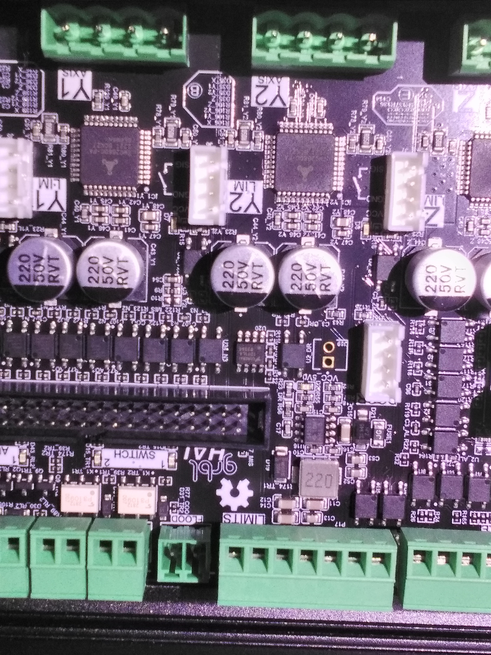

Oooh you have one. Zi don’t see a fuse like component in your pics. The ones I know are mostly white ceramic rectangles rather large in comparison to the resistors. A bit like the glass tube diode designated D1, almost visible bottom right in your third picture. Looking for the components R43, D21 and R125 to be near it. The component might just have F1 as designation.

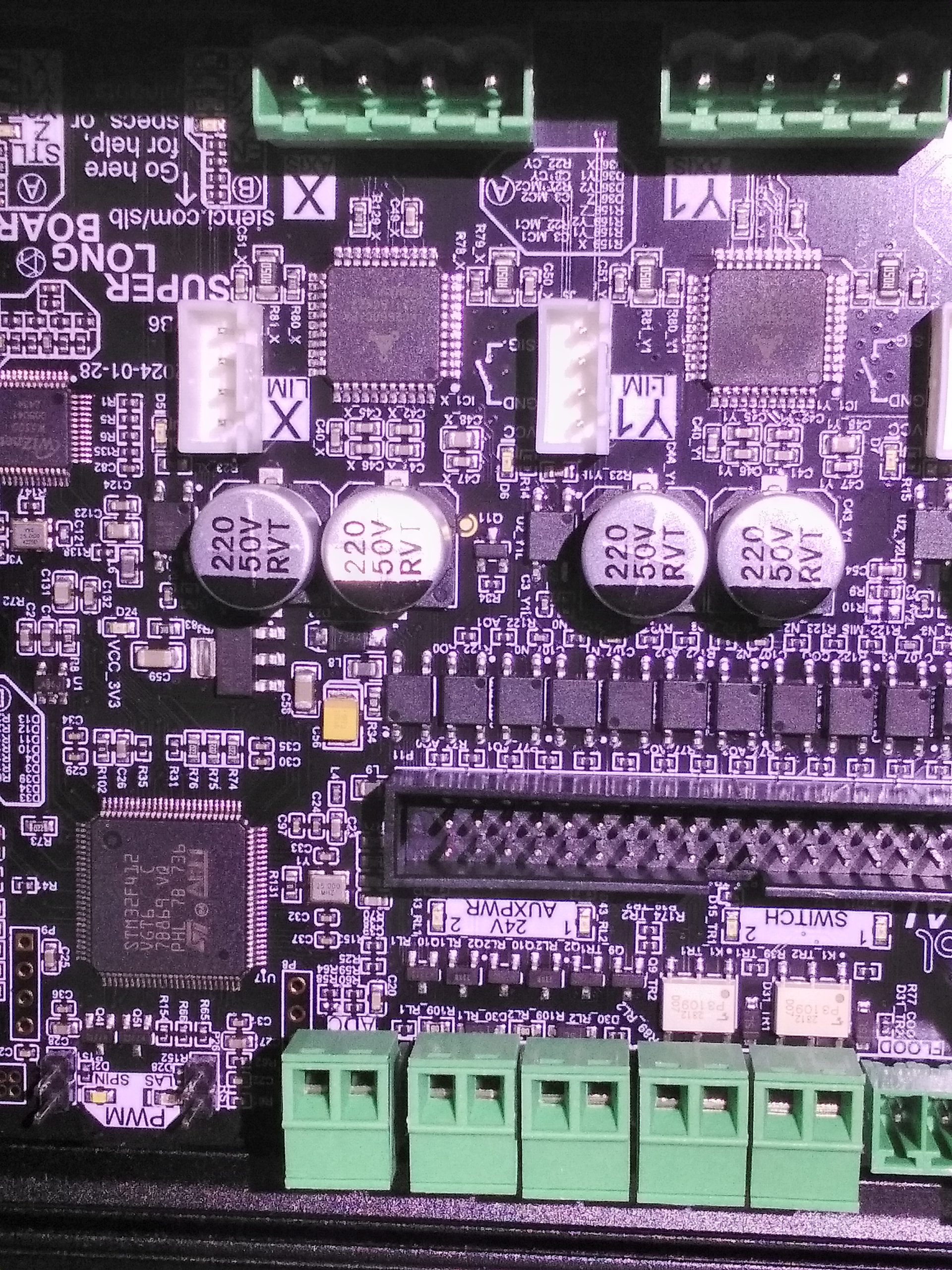

Could you make a few pics of the board right section progressing to the left while keeping the whole width of the board in frame? It seems to be not located in my suspected area.
I think these are in order.
EDIT: I see a fuse1 in the first pic. It’s roughly in the center of the lower left quadrant. D21 is there as well. It has JG on the actual component, I think.
Just found R43 and R125. They are just above the white connector in the same area.
Nice job Michael. When that fuse blowes, the power enable line is gone that is needed to start up the on board power supplys that power ics and stuff leaving the board blanck. Replacing that fuse might be not for all. There is an option to just short it with a gloob of solder, but that I leave to the one owning the board. It would not be my choise. At least not permanent. I might do if I need the board to work while the component ships.

It’s schrodingers controller and the only way to be sure is through the fuse. You measure it and if you cannot, you short it. The 36 Volts has been introduced on other parts of the board already. The fuse does not kill the input power perse, only the input power to the 5V section and a check line for other voltages (3v3, 12v etc) to come life, if it has the correct vallue.
