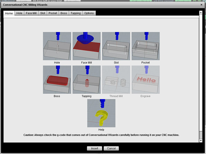

I think this is usually called a “conversational milling wizard”. I have a few of these as plugins in another Mach3 machine, and Tormach and other hobby/prosumer machines have similar. It’s basically an extremely simple GCode generator for some typical operations like ‘cut a circle’, ‘slot’, etc.
It’s not all that unlike the probing tab or similar, so something a gSender hacker could take a look at. I haven’t gotten around to getting a gSender build environment running yet, but will keep it on my list 😅
