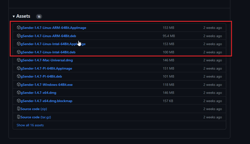

Good day all. Well I have my MK2 all put together but I can not down load the gsender on to my chrome book. I have LINUX on the chrome book but cannot find anywhere to down load to the chrome book. All of my firmware and the version is up to date.
Version 124.0.6367.154
I do not know what to do. Just fyi that I am not a computer whiz
Thanks

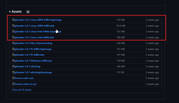

Hey @Ontariobud,
Welcome aboard! You can access several Linux versions of gSender [HERE](https://github.com/Sienci-Labs/gsender/releases/). Depending on if you are running Intel or Arm, there are a couple choices for you to match up to your system. You can give these a try, but they may not work for your setup, and Chromebook is not officially supported.
Check out [this thread](https://forum.sienci.com/t/gsender-run-on-a-chromebook/5123) where @chrismakesstuff and Nick Nalbone chat about having success.
 ![linux](https://forum.sienci.com/uploads/default/original/2X/0/04bbc91bf2b6e7302b6782254105e048f5b88a89.jpeg)
From our short section on Chromebook installs:
## Chromebook
You can run gSender by using Linux inside of ChromeOS. Setup Linux on your Chromebook with [these instructions](https://support.google.com/chromebook/answer/9145439?hl=en&fbclid=IwAR01u02vYLRXtjeB7EJOHFbsaIm2hsxFLbjK5zDSNhUE_F_Wn-ljnACo33k). Download the .appimage file from the latest release of gSender and double click to launch. You will need to have the g-code files you want to carve in the same folder too.
Hope this helps!
