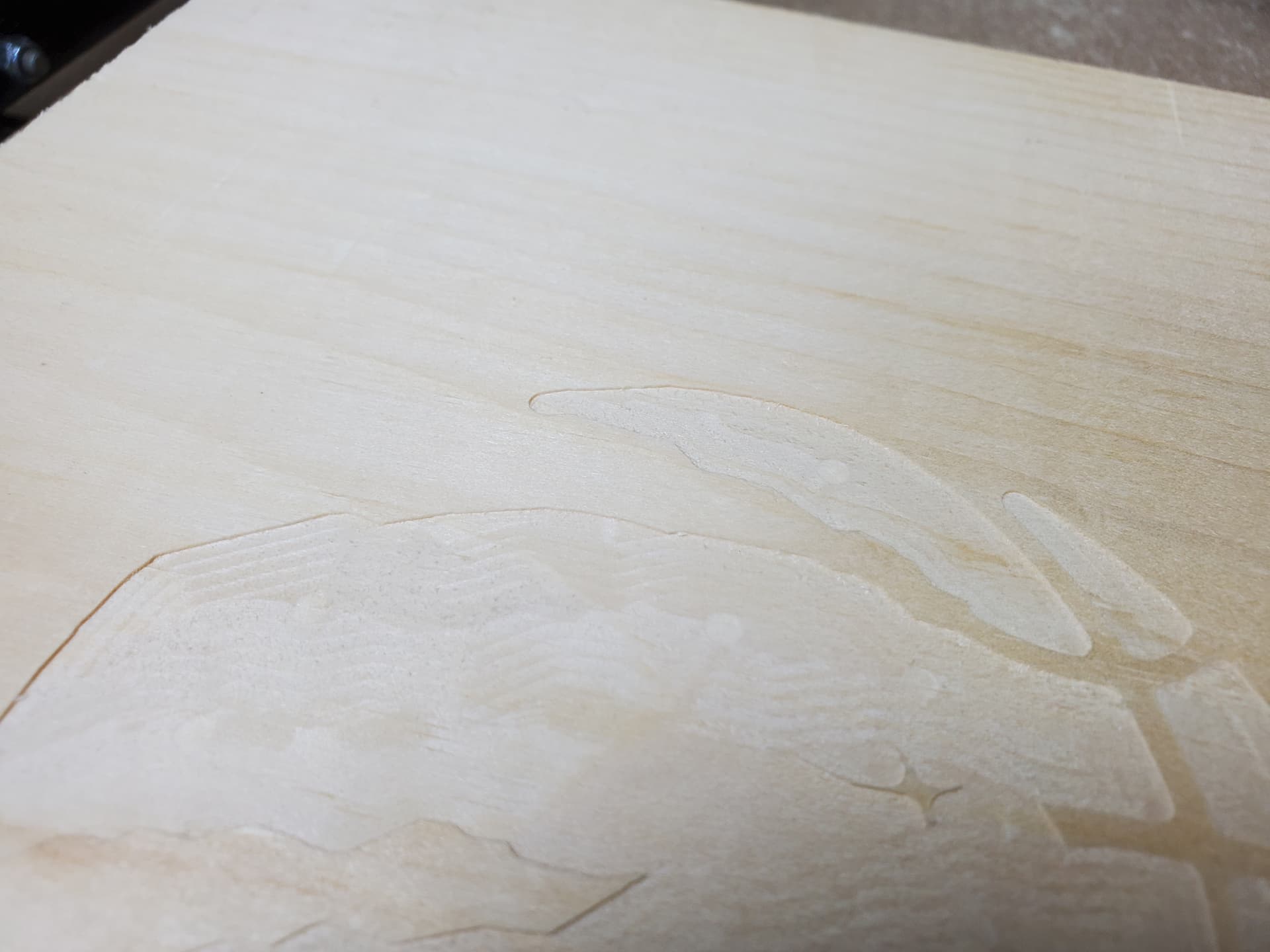

**Author:** ![Bizbrar](https://forum.sienci.com/letter_avatar_proxy/v4/letter/b/7ab992/32.png) [@Bizbrar](https://forum.sienci.com/u/Bizbrar)\
**Post date:** [August 7, 2022, 2:09pm UTC](https://forum.sienci.com/t/carve-lines-visible/6378/33 "2022-08-07T14:09:13Z")
So I have trammed the machine.
When I ran a test cut, i noticed round spots from the bit in various areas of the stock.
It natrually from the bit but why?

**Post date:** [August 7, 2022, 2:11pm UTC](https://forum.sienci.com/t/carve-lines-visible/6378/34 "2022-08-07T14:11:43Z")
@Bizbrar What bit did you use?
**Post date:** [August 7, 2022, 2:13pm UTC](https://forum.sienci.com/t/carve-lines-visible/6378/35 "2022-08-07T14:13:13Z")
I used 1/8 down cut bit.

**Post date:** [August 9, 2022, 5:35pm UTC](https://forum.sienci.com/t/carve-lines-visible/6378/39 "2022-08-09T17:35:08Z")
@Bizbrar The conventional wisdom is to use down cut bits for pockets. The rationale being that you will get a better surface on the bottom of the pocket. An upcut bit will, at best, leave fuzzies on the bottom since it is pulling the fibres up while cutting.
I guess, in your case, the conventional wisdom is not working out. I just re-read this entire thread. I understand that you tried Garrett’s method and it didn’t help. You’ve trammed your machine and it didn’t help. You’ve ensured that there is no movement in your Z gantry. **Am I correct in all of this?**
I don’t use Carbide Create, so I can’t try your file. I’m not much help there, obviously.
However, assuming that you have ensured that the machine is solid and true and assuming that you are running the finishing pass as recommended by Garrett, the only thing left is wood moving.
**Question: Is this happening with every job, or just this file?**
Here is an odd question for you. **Are you leaning on the table top when the job is running?** I know that sounds strange, but there was another use on here whose problem was that he was leaning on the table top to watch his job up close and personal. He had a problem similar to yours. When he stopped leaning, the problem went away. Strange, but true.
**Post date:** [August 15, 2022, 5:57pm UTC](https://forum.sienci.com/t/carve-lines-visible/6378/40 "2022-08-15T17:57:57Z")
@gwilki
I’ve checked the level again, and used a magnetic digital leveler and i’m at 89.7 degrees, i’m afraid to adjust it as it’s manual and may not be able to get any better than that.
I’ve changed my clamping method a bit, to ensure no movement.
No other changes were made, and I’m not leaning on the table or anything (made sure of it consciously).
My cut came out very nice now, although I can still see the movement lines of the 1/8 bit. I ran 2 passes at different step over, and there was an improvement.
There is one thing though that’s bothering me, maybe for another thread, but I generally wear my ear protection, and when I take it off and jog the machine, I notice it makes some noises that don’t sound very nice. Some sort of “grinding”, not the right word, but it’s mainly on the Y axis. I did notice on the X that the wheels are leaving a mark as well, I see some black residue, is this normal?
