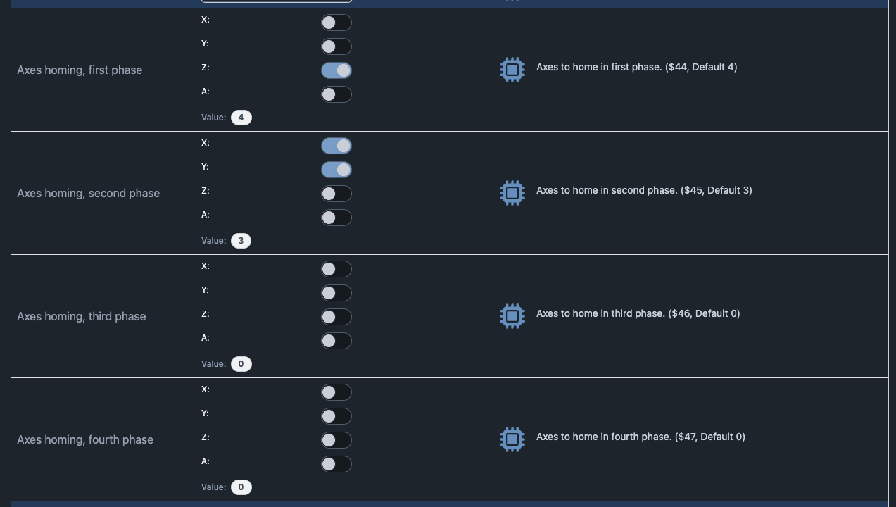

To be even more specific - for grblHAL machines you can configure the homing cycle within EEPROM:
 ![Screenshot 2026-09-10 at 9.59.30 AM](https://forum.sienci.com/uploads/default/original/2X/f/f9eb3a81dd0983b6d6634be63b56d9d1a3e254e8.png)
For grbl machines, this is a compile time option in the firmware and is not configurable past that. If your Shapeoko is a grbl controller (which I suspect) you will not be able to configure this within gSender.
