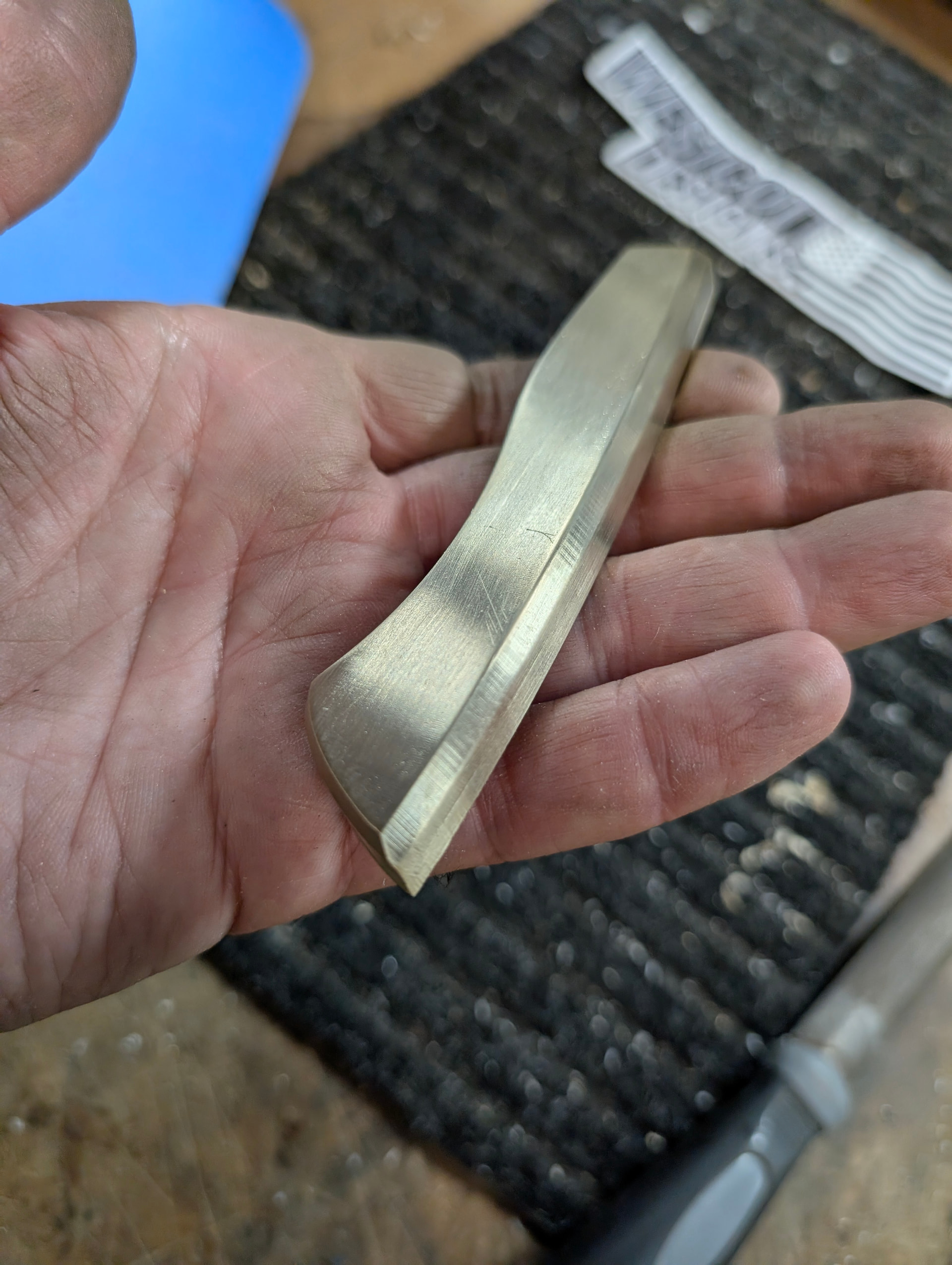

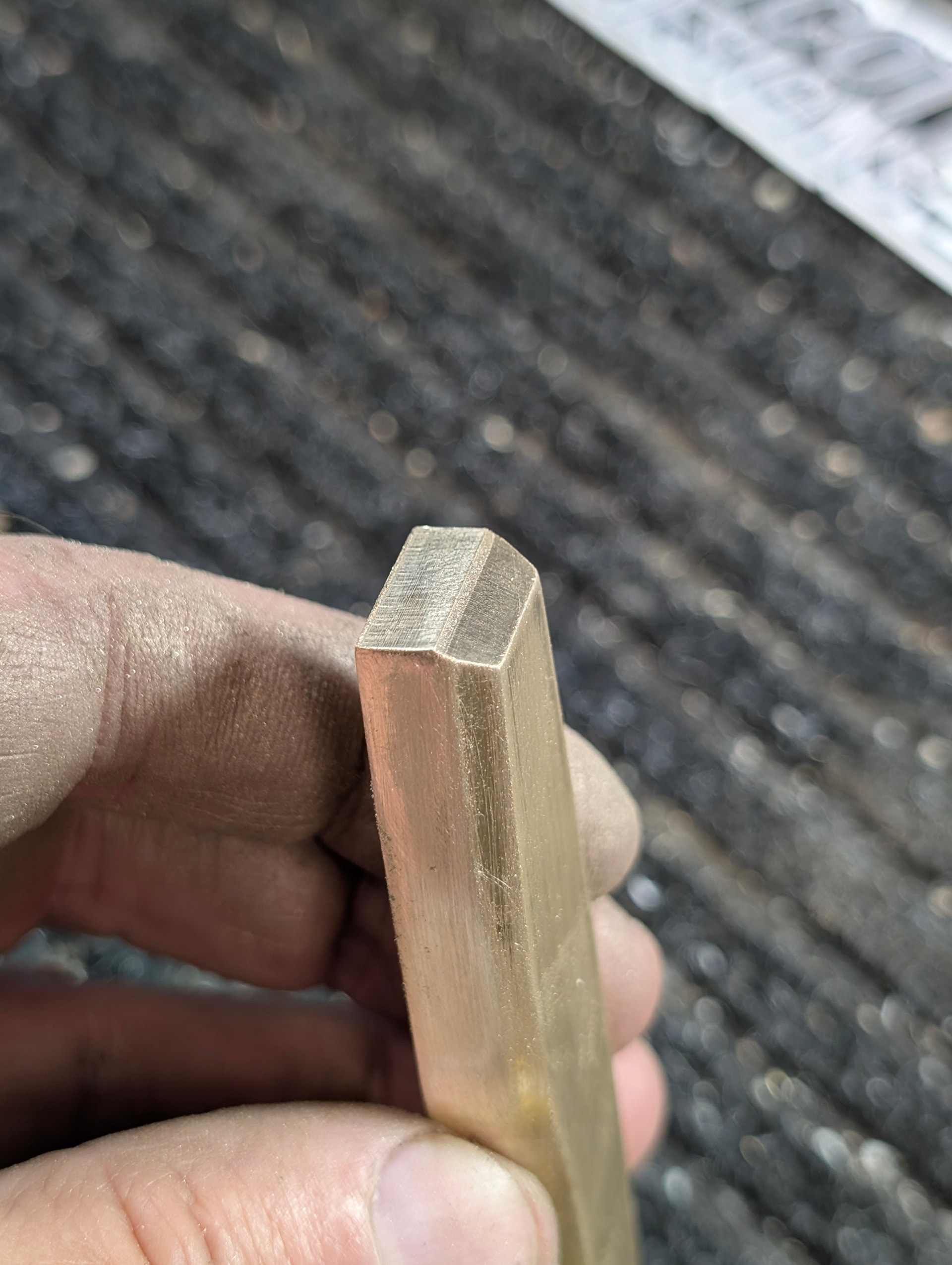

I was just commissioned by a big movie studio to make 6 chef knives for a major motion picture.
They want brass handles. I tried to talk them out of it but the director insists on brass.
I plan on making 2-piece handles with an internal slot to accept a “hidden” knife tang. I’m also considering some internal pins for alignment and additional strength. The will epoxied together and then surface finished.
This will be a double-sided job. I have little experience with double-sided and don’t have time to learn on my own with this project.
I’ve done some one-sided profiles and chamfers on the brass and it cuts really well.
If you would like to help I can afford to pay for your time.

![PXL_20260401_034648973.MP](https://forum.sienci.com/uploads/default/original/2X/8/8f4e3b5567a46950ad1a71f079c1a74e1e28b011.jpeg)
 ![PXL_20260401_034256106.MP](https://forum.sienci.com/uploads/default/original/2X/4/491936413024c11c1c738264921a2f9c8dc7cec5.jpeg)

Of the 6 knives- 3 will share the same design and the other 3 are unique.
The stock I will be milling from is 0.375” thick x 3” wide. I have a 6’ bar. I will be cutting the bar into more manageable size pieces, probably 2’.
I’m definitely considering some sort if fixturing. I have good 1/2” Baltic Birch on hand. One idea was to cut a shallow 3” x 2’ pocket into one of those woods so the brass bar would sit just proud.
My thinking is that would make it easy to clamp with just downward pressure and give me accurate repeatable X/Y coordinates. I’m not sure I would still need asymmetric pins if I went this route.
I would cut multiple pieces at one time and leave tabs so I could flip the material to do the other side.
