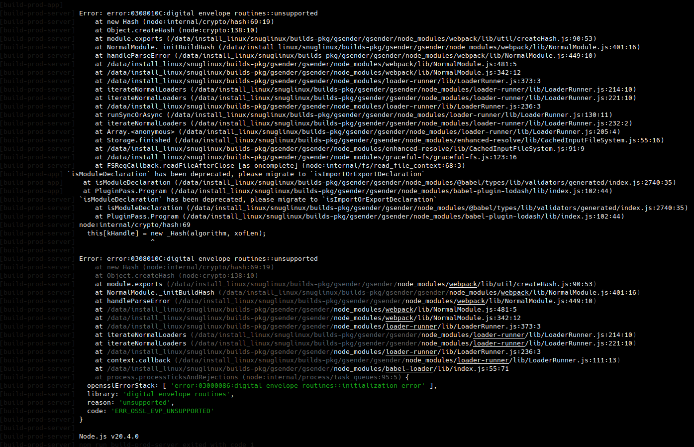

yarn install Executes without errors, and the command:
yarn build-latest
installed the missing dependencies and I see the AppImage and deb packages are assembled :slight_smile:
yarn build:linux-x64
зображення
The binaries were assembled, but the paragram was not executed. After comparing the files, it turned out that there are no app, server directories in output/linux-unpacked/resources/app. I copied them from gSender_1.2.2_amd64.deb and now everything works. Can anyone suggest what could be the problem?
