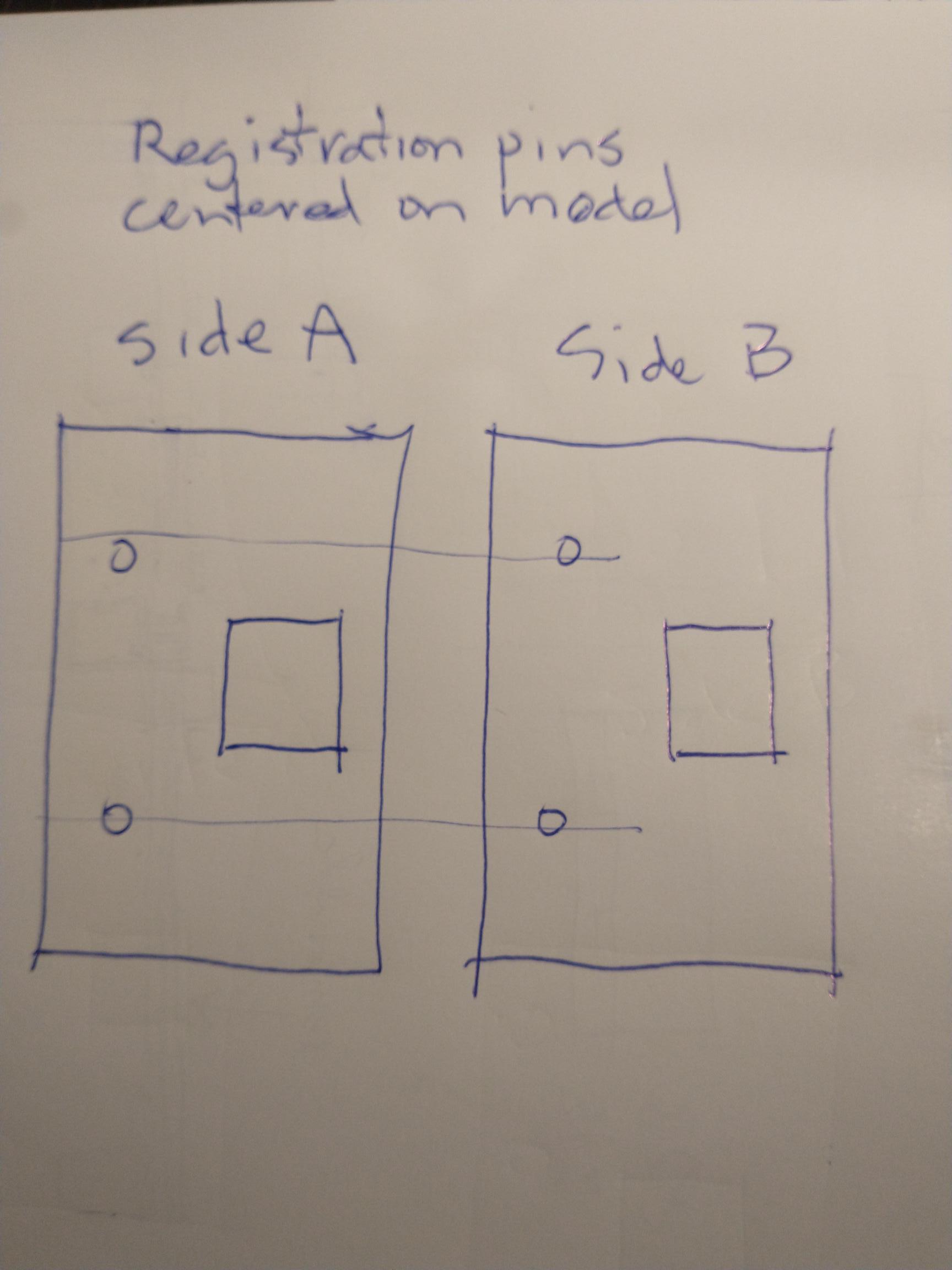

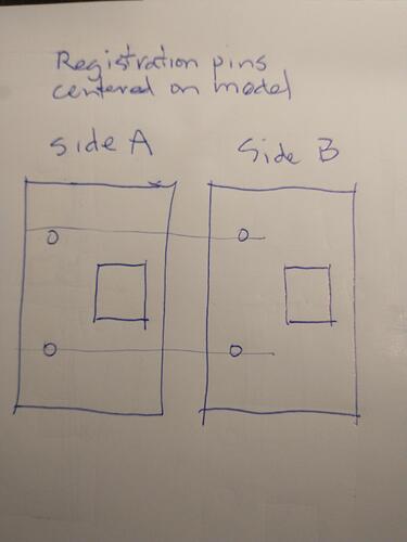

### Author: ![Chucky\_ott](https://forum.sienci.com/user_avatar/forum.sienci.com/chucky_ott/32/8692_2.png) [@Chucky\_ott](https://forum.sienci.com/u/Chucky_ott)
#### Post date: [October 13, 2025, 10:38pm UTC](https://forum.sienci.com/t/double-sided-milling-again/24613/2 "2025-10-13T22:38:50Z")
@Jens
Edit: I’m pretty sure the statement below is incorrect. In fact, I now think that the registration marks need to be centered on the workpiece. While easy to do on the model, it might be difficult to accomplish in practice unless you can position your workpiece fairly accurately on your spoilboard.
Original message:
I think I understand your explanation. I would think that the registration marks on the model would need to be centered on the model. Any offset would would show up when you flip it.

### Author: ![Jens](https://forum.sienci.com/letter_avatar_proxy/v4/letter/j/d2c977/32.png) [@Jens](https://forum.sienci.com/u/Jens)
#### Post date: [October 13, 2025, 10:46pm UTC](https://forum.sienci.com/t/double-sided-milling-again/24613/3 "2025-10-13T22:46:47Z")
Yeah, I am having a hard time figuring out what exactly needs centering and what not. After large magnification, I just found out that the registration holes were not quite on the centerline of the model and that could very well be the problem.
I will re-draw things and run another test but I am having serious issues wrapping my mind around this.

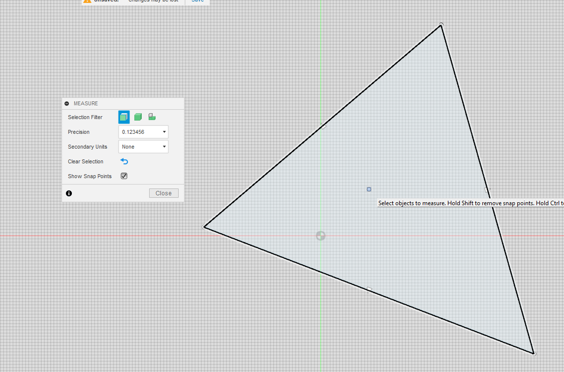

@Jens In Fusion, you can find a face’s centre by selecting “Inspect” and enabling snap points. You can then get an accurate value for the centre and move your model accordingly

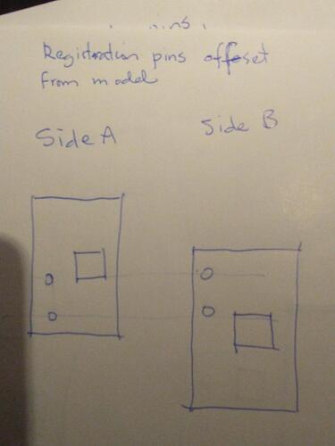

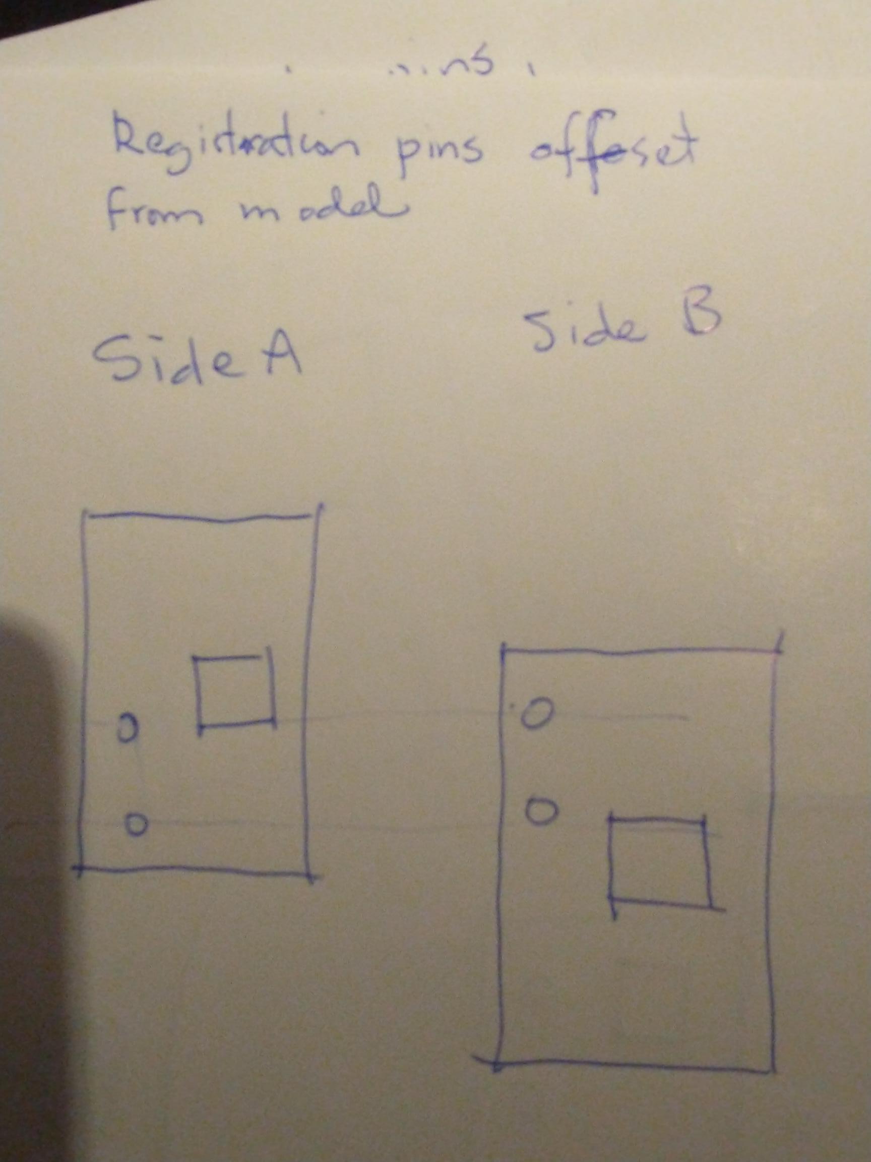

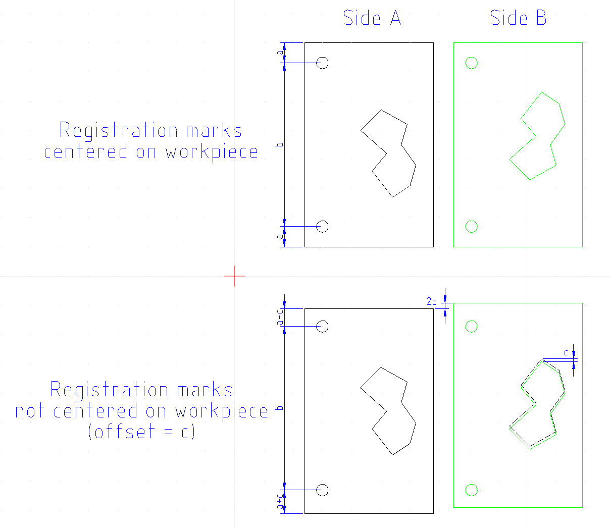

#### Post date: [October 14, 2025, 1:12am UTC](https://forum.sienci.com/t/double-sided-milling-again/24613/10 "2025-10-14T01:12:40Z")
@Jens, In trying to better explain it, I just confused myself more! LOL. Now that I think of it, it doesn’t matter that the model is centered on the registration pins. Doing it your way (hole through work piece and spoilboard), what IS important is that the registration holes are centered on the work piece. This essentially mimics the method Grant describes. The difficulty you might be having is likely caused by not being able to place the workpiece exactly as the model expects it to be. Any deviation would cause an offset in the flipped carve. Grant’s method essentially eliminates that error.
#### Post date: [October 14, 2025, 2:49am UTC](https://forum.sienci.com/t/double-sided-milling-again/24613/11 "2025-10-14T02:49:31Z")
This poses a problem. The whole concept for me was to take a random sized piece of stock and being able to flip it without having to reset x and y.
To put it another way, let’s say I have a chunk of plywood with irregular edges. I want to use that stock to make 4 sides of a drawer. What I have been doing is to put the stock on the mill table in any which orientation that allows me to carve out the 4 pieces. The initial stock can have a random x/y zero as long as all pieces can be cut from that initial piece of stock. Once the individual pieces are freed from the original stock, the second side CAM model has a very specific x/y zero spot - let’s say the bottom left side of each individual drawer side piece when turned over.
I can now mount each individual piece on my mill table, one at a time, line it up with a fence on the left side and a fence along the bottom and x/y zero is where the bottom fence meets the side fence. At that point I can cut the second side features because everything is lined up in a way the CAM system expects to see.
My problem with that arrangement is that instead of one piece of stock containing the four side pieces, I have to handle each second side operation for each part individually.
I might not be explaining myself correctly but this makes sense in my mind and has been done successfully.
What I would like to achieve is to take the random sized piece of plywood, as before, mount it on the mill, produce all first side features without separating the individual wall pieces from the stock including 2 registration pin holes. I would like to be able to turn the entire piece of stock over, mount it on the registration pins and cut all the second side features and only then cut each individual piece from the stock. Instead of 5 setups on the mill table (1 for the initial stock and then 4 for each drawer side piece) I only have two setups. All the first side features are cut in the initial setup and all the second side pieces are finished by flipping the initial stock and cutting the second side features including the profile cuts that free each of the drawer sides from the initial stock.
Can this be done using registration pins?

@gwilki, I will do some more research but on initially looking at this, Fusion has a ‘mirror’ feature which should be able to mirror the alignment pin holes somehow. I still need to get that clear in my head though..
#### Post date: [October 14, 2025, 3:02am UTC](https://forum.sienci.com/t/double-sided-milling-again/24613/13 "2025-10-14T03:02:18Z")
@Jens I think this can definitely be done using the method Grant describes. But in Fusion, you would need three models. First model is of top face and registration holes. Second model is a mirror image of the first model but only with the registration holes. Third model is of the bottom face without registration holes. Doing it like this, it would not matter if your wood stock is larger than the model (as long as your machine zero sits inside the wood stock and coincides with the model zero)
#### Post date: [October 14, 2025, 5:13am UTC](https://forum.sienci.com/t/double-sided-milling-again/24613/15 "2025-10-14T05:13:35Z")
I am absolutely elated being able to report that mirroring the dowel holes in the spoil board resulted in a perfectly centered two sided test piece !!! No x/y adjustment was required between front and back side milling.
The next test will be to do a piece of stock that has multiple individual pieces on it and see if the concept works for that
