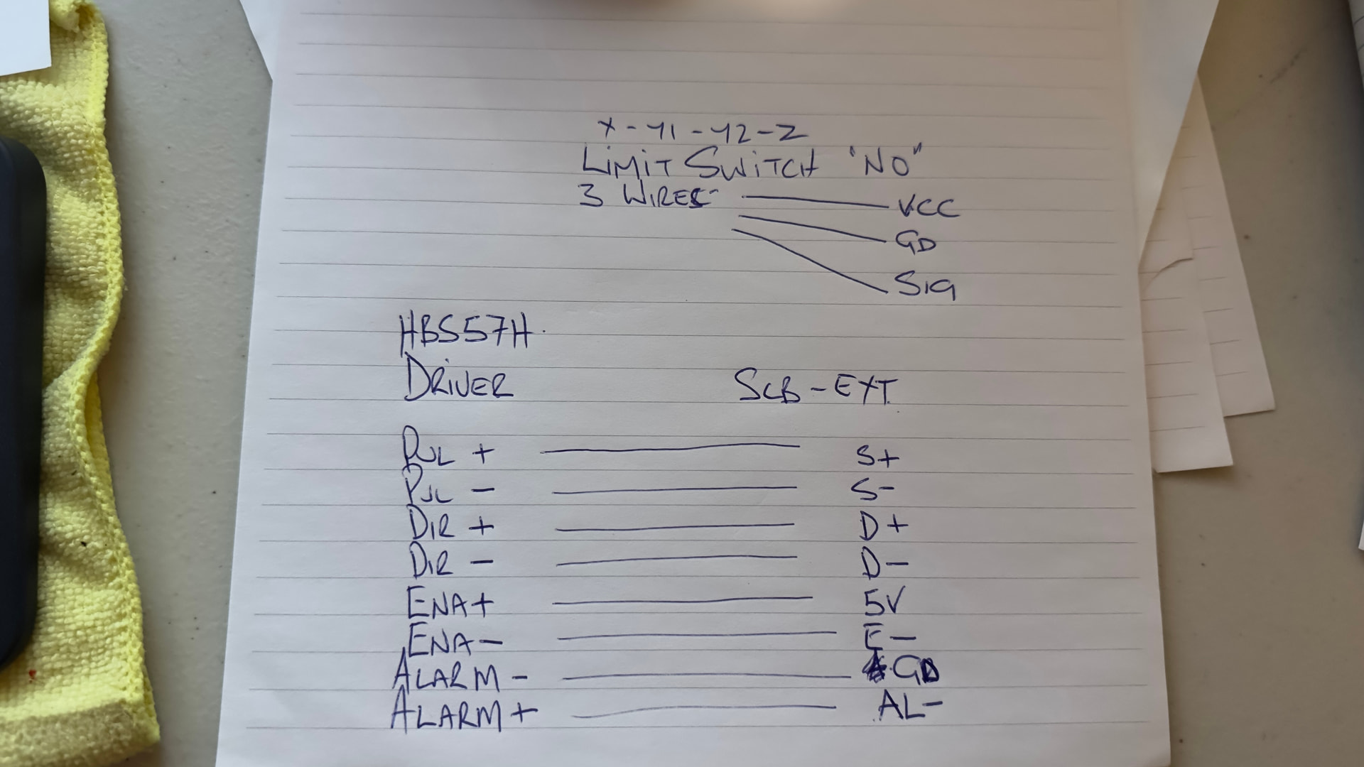

Hello, after many months planning this I’m so close to building my CNC and have opted for the SLB-EXT as my controller.
 ![IMG_4960](https://forum.sienci.com/uploads/default/original/2X/2/2725854cbefd8667afaa7989ba346886a6e19dc6.jpeg)
I’m using 4 Closed Loop Steppers with limit switches all all accesses incl both Ys
I forgot to order the drivers initially, but now arrived and i’m at the point of connection, avoiding risk at this point, can someone take a look at my drawing and tell me if I’ve made any mistakes.
Any guidance would be truly appreciated.
