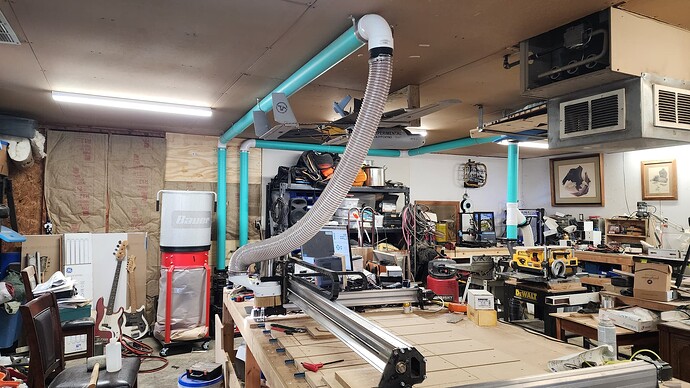

Welcome to the dusty conversation! I hung my hose high after making sure it didn’t restrict movement of my CNC in any way. Some people use an arm, I was planning on it but found it wasn’t necessary in the least. I’ll add a picture when I get out to the shop. It works fantastic except for when I surface things. I have a number of great suggestions from that thread!

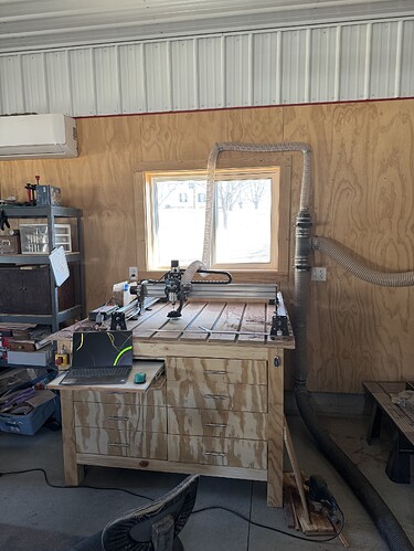

![IMG_0860](https://forum.sienci.com/uploads/default/original/2X/f/fdc77533151f00ef8ebde8ac12988c61a5e15b74.jpeg)
Here is my dust hose set up. It works well for me, no tugging, no pulling. I hope it helps!

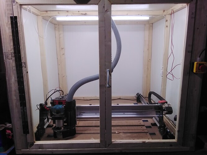

![image](https://forum.sienci.com/uploads/default/original/2X/c/c4365f20e9011666a887f3795b6119c17abdfb54.jpeg)
As you can see my hose is a regular vacuum hose suspended in the middle of my enclosure so it doesn’t pull on anything. I rarely use the dust shoe because the enclosure keeps everything inside. I just vacuum up after every carve. The one thing I want to use it for is surfacing my spoil board because MDF is so dusty but with the dust shoe on the mill can’t reach all the way to the right side.

Really love your table setup, with the drawers and pullout shelf for the laptop…

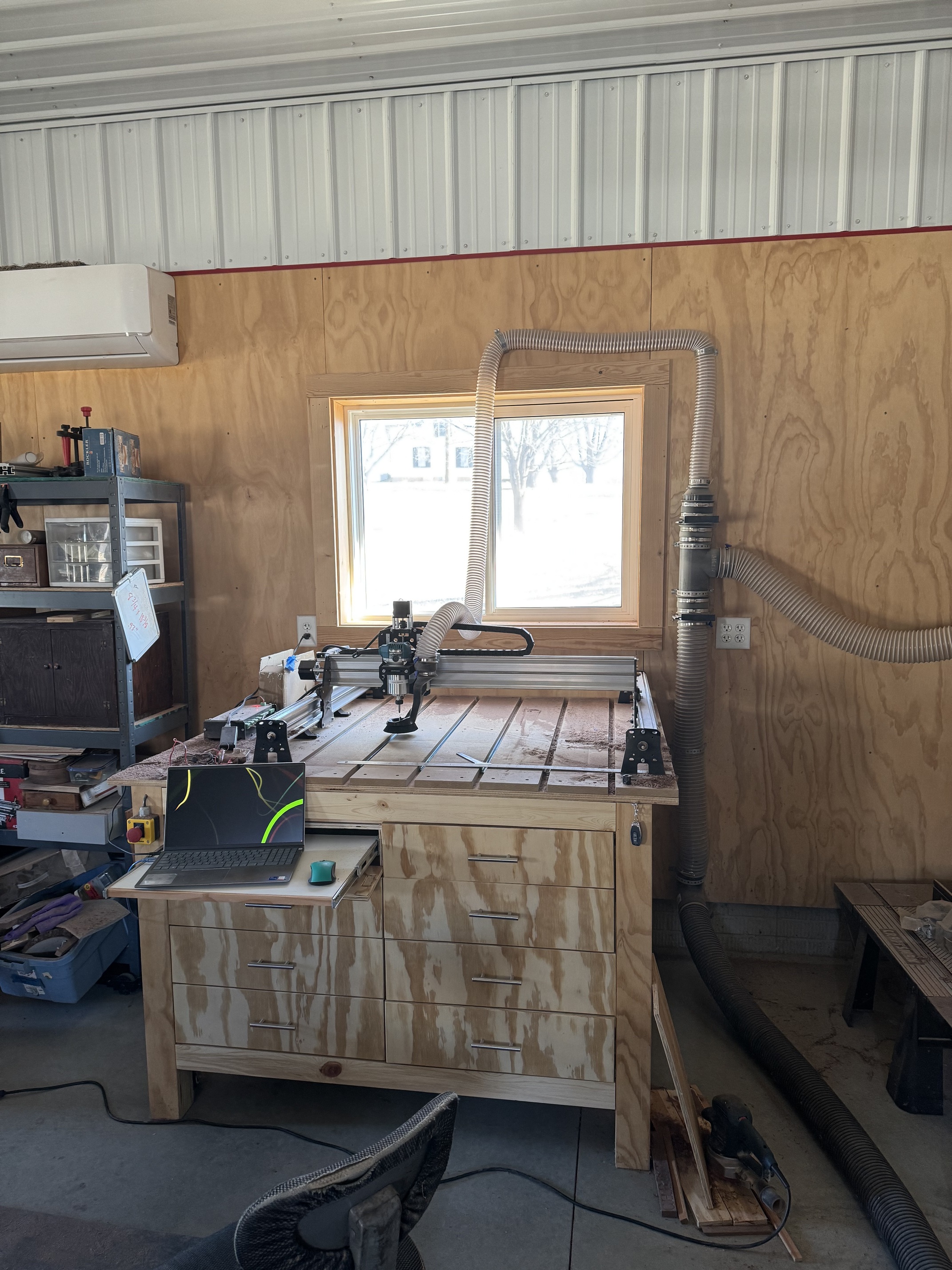

![20250122_152543](https://forum.sienci.com/uploads/default/original/2X/d/de56b1a8d2af2991a489d124195091c60a18f954.jpeg)
My GF got me a spindle for xmas which invalidated my shopvac/cyclone and pool hose dust collection. Decided to bite the bullet on something more skookum.

Thank you What’s funny is that is my design computer that I’ve been using for control of my CNC. I bought a new old stock Mac mini from 2018. I don’t have a handle on it yet, but I’m going to use a 32” flat panel television for the monitor. I will still use the pullout for the keyboard and mouse. I may move the mini to a remote spot in the shop. The keyboard and mouse are Bluetooth. I have a network cable and would only need a long hdmi cable to the monitor. Been busy keeping my bride happy with the remodel of the living room. Pulling carpet and getting ready for paint. Keep her happy may allow me to get a 4x8 altmill when they become available. Remember, dust is horrific for our health!

Hey Kerry,
How well does the PVC work for you? Did you run a wire inside to dissipate static electricity? What dust collector are you using?
I go back and forth between PVC and metal for ducting.
I like the install a lot. It is clean and hopefully works as good as it looks.

I have not grounded it yet. I get zapped removing the dust boot pretty frequently. You don’t need to run wire on the inside. I’m going to insert screws every 18 inches or so and run a wire along those. Just haven’t found the uninsulated wire I want to use yet. PVC works just fine and is much more economical than metal. The flex hoses are a little spendy. The dust collector is Harbor Freight’s new one. All in it cost me about $900 US

That’s not bad considering all you got going for you with your set up! I got a grounding wire from a local woodworking store. Essentially, it is 14g stranded wire. I was thinking I’d have to run it inside the pipe and I vapor locked. Never thought of a grounding screw and running it outside. Appreciate that! I have a Jet 1100 single stage chip collector, hooked up to a cyclone from ornida air. 4” hose everywhere! There has to be a better way!
Upgrades to the dust collector, a 1mm canister filter is in order, expensive? Yep. Better than the 35mm bag filter? Absolutely!
I got a Jet dust scrubber off eBay for 1/2 price. It automatically turns on when the onboard sensor decides it needs it. Haven’t gotten it installed yet though. My bride has me remodeling the living room (which it needed). But new house flooring should mean I get either my AltMill 48x96 or flooring for the shop. A win in my book.

I neglected to reply that your setup is basically my dream. Truly blown away by the ingenuity. So, totally self-contained? No real need for a robust DCS because everything “stays inside”?

Yup! You could argue that using a dust shoe would keep more dust away from the router’s motor but it’s not too bad with anything other than MDF in my experience. I like the unobstructed view that I get without the shoe so I don’t use it very often. The vacuum hose fits just loose enough that I can push it onto the top of the box and it hangs out of the way. Then I just pull it down and vacuum after each job.
The enclosure is 2x4 construction with some ripped to 2x2. The skin is inexpensive ‘hard board’ that comes white on one side. The hardest and most expensive part was making the bifold door. Each of the door panels has two frames, one notched, that sandwich the plexiglass. I made it tall so I wouldn’t bump my head but having it tall really helped with managing hoses and lighting.
Since that picture was taken I have added a door in the back that is about 1/3rd the height of the enclosure. It swings up to allow easier access to the Y motors and allows pass through work to still be done. I also added a 6" hose for my laser exhaust that hangs down from the top. That goes to an inline fan and is vented outside.
I’m glad you like my enclosure, it’s worked well for me so far.
