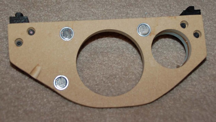

I wanted to modify the dust shoe to make it a easier to get at the collet nut and the bits.
I made two copies of the plywood part out of 1/2" mdf, since I wanted something a bit thicker to hold magnets. Then, I attached the upright supports to one of the new pieces and the brush to the other. I mounted disc magnets into both the part holding the supports and the part holding the brush.
Now, to remove the brush, I just unclip it from the top piece, which stays on the machine.

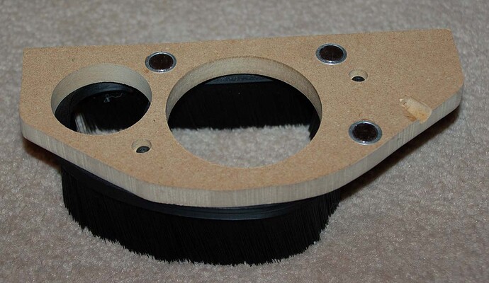

Attached are pics of the dust shoe mod.There is not a lot to see, I guess.
I traced the plywood “top” that came with my LongMill onto 1/2" MDF. I cut out two copies on my bandsaw. (I suppose that I should have used the LongMill, but my skills with a bandsaw and drill press far exceed those on the LongMill.)
I have a 2 3/4" forstner bit, so I used that to drill out the hole for the router. Likewise, I have a 1 3/4" forstner bit that I used to drill out for the dust collector hose.
On the top piece, I drilled out for the screws holding the brackets. On the underside, I counter bored for the heads of the bolts so that they are sunk below the surface of the MDF. I used a scrap piece of Corian (the mint coloured piece in the pic) give a bit more thickness to plug the dust hose into. I expoxied that to the MDF. It won’t wear from inserting the removing the hose like MDF would.
On the piece holding the brush, I drilled the two holes holding the brush to the MDF. Again, I counterbored them so that they heads of the bolts sit below the MDF surface.
I had on hand 1/2" rare earth magnets. I get them locally from Lee Valley. I also had the cups they fit into. I went with three magnets in each piece of MDF. The holes for the cups are 5/8 and are drilled about 3/8" deep. The cups are epoxied and screwed in place.
My original plan was to simply make a top plate from MDF and put magnets in it and in the brush itself. But, there is not enough meat in the brush frame to hold magnets. It may well have been strong enough to simply put magnets in the top MDF and wrap steel wire around the brush frame, but I wanted more surface and went with the second piece of MDF. That could well prove to be overkill.
I drilled a notch in the two pieces of MDF that will allow me to put a screw driver in between to pry the pieces open, in case it’s too tough to simply pull it off.
That’s it. Long winded, I know. If you have any questions, feel free.
 ![top%20of%20brush%20plate](https://forum.sienci.com/uploads/default/original/1X/505b25f18f319f8a0f8f870dbf9ad82c47e13da3.jpeg) ![top%20of%20top%20plate](https://forum.sienci.com/uploads/default/original/1X/d87e62cfe86eb84b551b1fc4a00331b2338b2a25.jpeg) ![underside%20of%20top%20plate](https://forum.sienci.com/uploads/default/original/1X/d12c29607c03485046e68547228ec38555d67893.jpeg)
**Post date:** [January 2, 2020, 11:50pm UTC](https://forum.sienci.com/t/dust-shoe-modification/472/6 "2020-01-02T23:50:13Z")
Mike: That’s not a bad idea. I’ve not run a job with this yet, but I can say that the magnets are too strong to simply pull the two piece apart. I need to use something in the lateral notch that I drilled to pull them apart.
That said, they are not as strong in shear as in direct pull, so hitting something could move it. Time will tell, I guess.
Thanks for the idea.

I like it, I’m thinking I would make it pretty close to the original, but bring in the router hole diameter closer to the body of the router to stop chips coming out that hole. Can pull in the part from on shape and convert to a dxf or something to cut with, I would imagine - that is where I sometimes get goofed up with the cnc. if it was a 3d printed part I could just take the STL and print it on my 3d printer but getting the files to the CNC sometimes confuses me yet.
Really like that idea though, looks great and solves a problem I have as well!
Mike
**Post date:** [January 3, 2020, 1:22pm UTC](https://forum.sienci.com/t/dust-shoe-modification/472/9 "2020-01-03T13:22:44Z")
Tks, guys.
Mike: The router hole in mine is smaller than the stock one. I happen to have a 2 3/4" forstner bit, so I used it. The hole could still be a bit smaller, but not much, really. Maybe when I am a bit more competent in the CNC, I’ll route a new one with a more precise fit.
Likewise with the hole for the dust hose. The stock one never worked for me. The adapter was not close to fitting in the odd-shaped hole. Initially, I glued and siliconed it in place. Then, it was just easier to make something with just a round hole that my vac hose would friction fit into. Again, I happen to have a 1 3/4" forstner bit. With that and a bit of sanding, my vac hose fits snugly. I used corian as it won’t wear from removing the hose often. I need that hose for my vacuum. 🙂
I don’t mean any of this as a criticism of Andy and Chris’ design. They needed to design for a range of routers and vac hose sizes. I can design just for my equipment.
