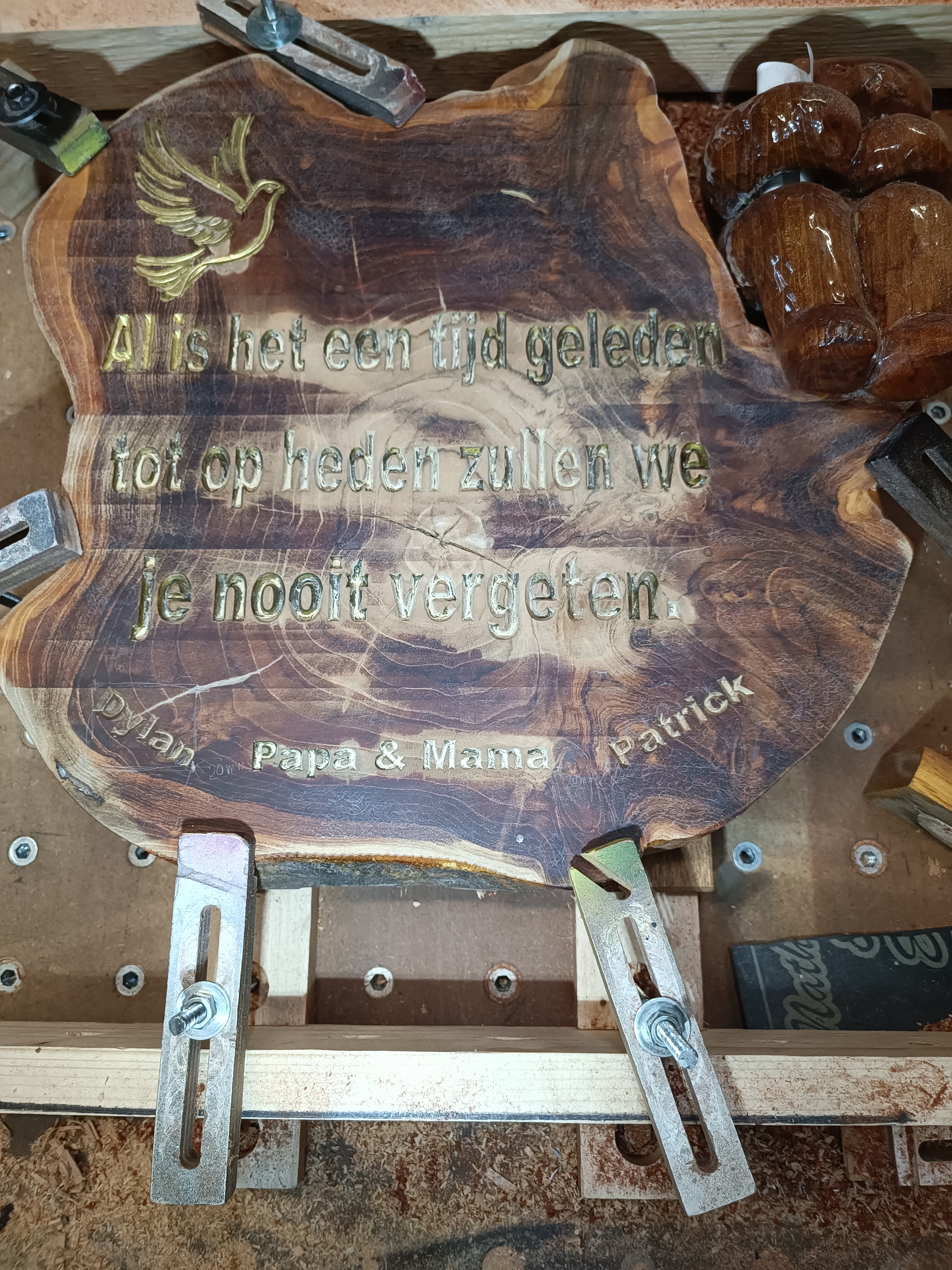

4 years ago, I made my clamps out of ply which was a mistake because they tend to crack when used with force. I however still use the same clamps I made as a simple starter project. They are not much to look at, just some rectangular pieces 100mm long, 20mm thick, and wide of ply with a slot to fasten them and give them freedom of reach. A pocket at the front gives it a way to lock stock in place.
Simple, effective and not corrosive for endmills when they strike them. (Wich I did a lot.) Here’s a pick with a bunch of them in various state of destruction while still working like charms.
