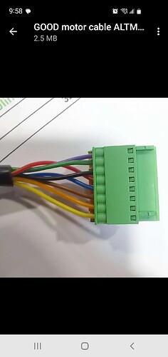

Are you sure the stepper motors are all properly connected at both ends? With those errors, that would seem to be something to look at.
Seems pretty hard to mess up the wiring of the motors. I did double check though. They have a green indicator light that is lit. They are powered and won’t freely turn.
The signal and feedback connector only goes in one way.
Nic
Problem solved.
The wiring harness for each of the steppers was wrong. I’ll attach the photo that was sent to me by Sienci Labs. I matched up my wires to look like the photo.
Thanks for all the help and suggestions.
