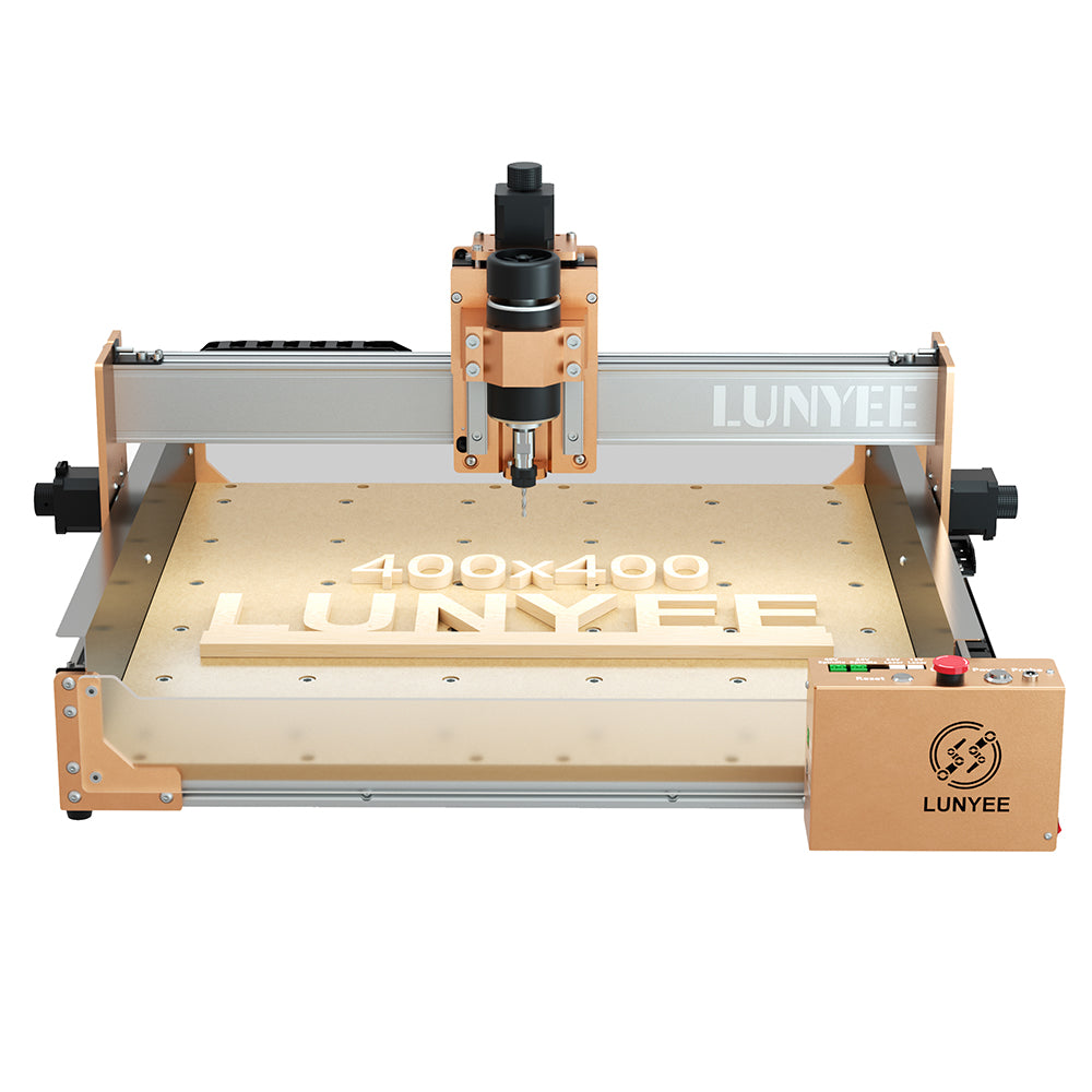

I export my gcode from Esal to gsender, with a feed rate of 4000mm per minute, but gsender works at only 300 mmper minute…
Please help me understand why…

What CNC are you running? What are your $110, $111 and $112 values in gSender?
I have a Lunyee 4040 Pro.
$110, $111 and $112 are all at 200
@Delio That is most likely the root of your problem. You can put any feed rate you want into gcode, but it will not override your eeprom settings. According to this page
your max can be 5000mm/min. You have it set to 200.
In Easel it runs at 4000 mm per minute
Thanks a lot, I will edit those values…
