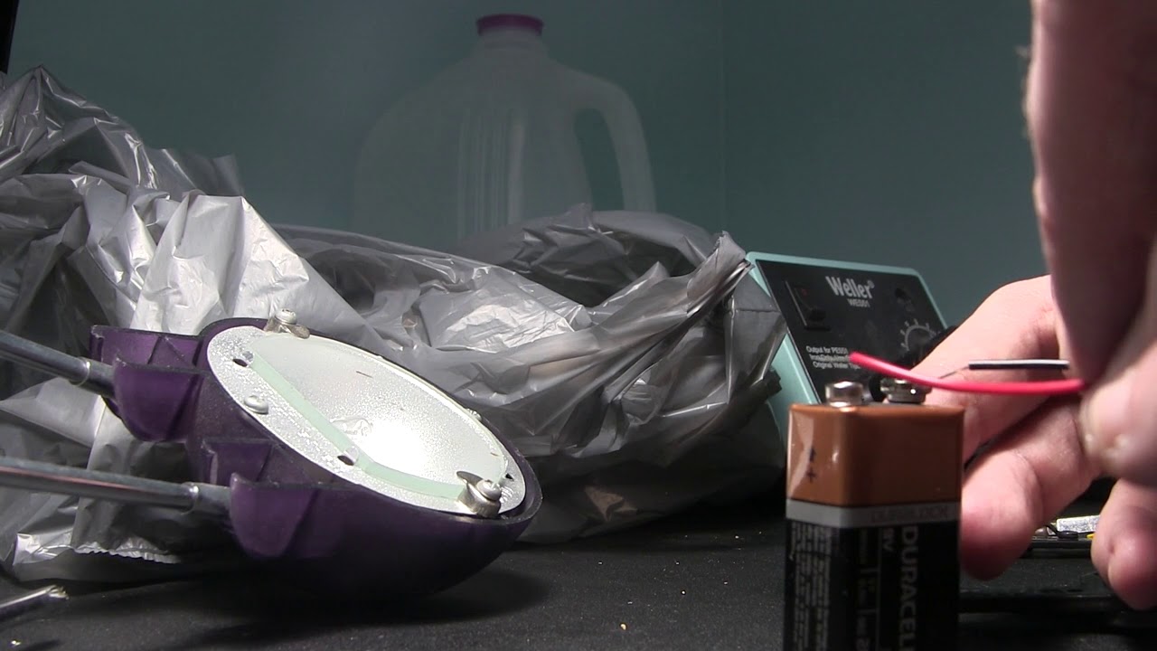

I have not done this with my CNC yet but I have done it to control motors on other projects. You can get a 120 volt AC SSR for about 20 bucks and wire it to an outlet that you want to control, then control the relay with the CNC controller. I wish I could tell you the g code for turning it off and on but I have not gotten that far yet. I bet there are people on here that can tell you. Anyway, take an extension cord and you will cut the hot wire and attach it to the load side of the ssr then hook it to the outlet you want to control. With the right SSR you can control both a shop vac and the router. Hook the signal wires from the CNC controller to the signal input on the SSR (again someone here can tell you which signal output to use from the controller), tell the controller to activate the switch when you start the cut and turn it off when the cut is done and you should be good to go.
This video is not the best but he got it right. Good luck.
[![](https://img.youtube.com/vi/yfviIaPxLeg/maxresdefault.jpg "Solid State Relay to open/close 110V AC outlet") ](https://www.youtube.com/watch?v=yfviIaPxLeg)
