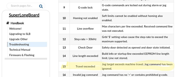

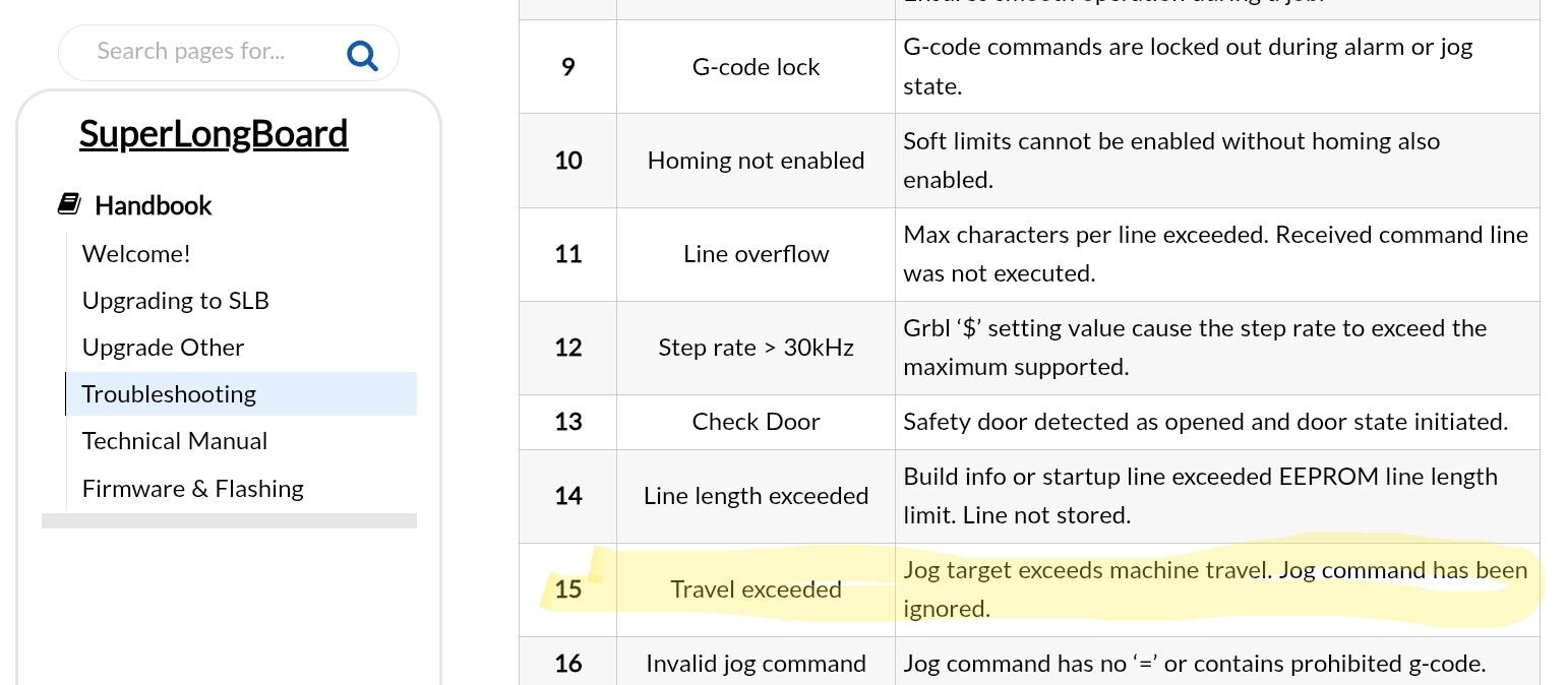

The explanation for error 15 in the error list is this:
 ![Screenshot_20250421-223444_Chrome](https://forum.sienci.com/uploads/default/original/2X/e/ec6739269133390570c8a5f07d34817e88528cc8.jpeg)
Found here:
> **[Troubleshooting - SuperLongBoard](https://resources.sienci.com/view/slb-troubleshooting/#errors-list)**
> See more on SLB settings and troubleshooting, especially useful on DIY CNC setups to better understand how to configure your SLB for your machine.

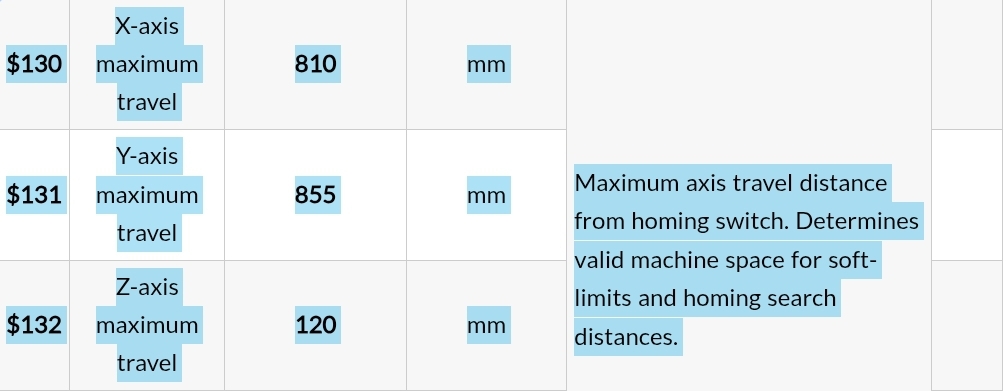

I have looked up what settings might trigger this error and found these to be something to look at.
 ![Screenshot_20250421-223306_Chrome](https://forum.sienci.com/uploads/default/original/2X/c/ce42dad73f70408312069cf247e4b99cc2b40839.jpeg)
Found here:
> **[Firmware & Flashing - SuperLongBoard](https://resources.sienci.com/view/slb-firmware-flashing/#settings-descriptions)**
> Page Suggestions? Your board will likely ship with the latest firmware already installed, but we occasionally make updates to add new features or address any discovered issues. You may also choose to re-flash the firmware onto your board if you’ve...

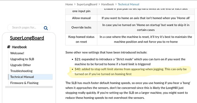

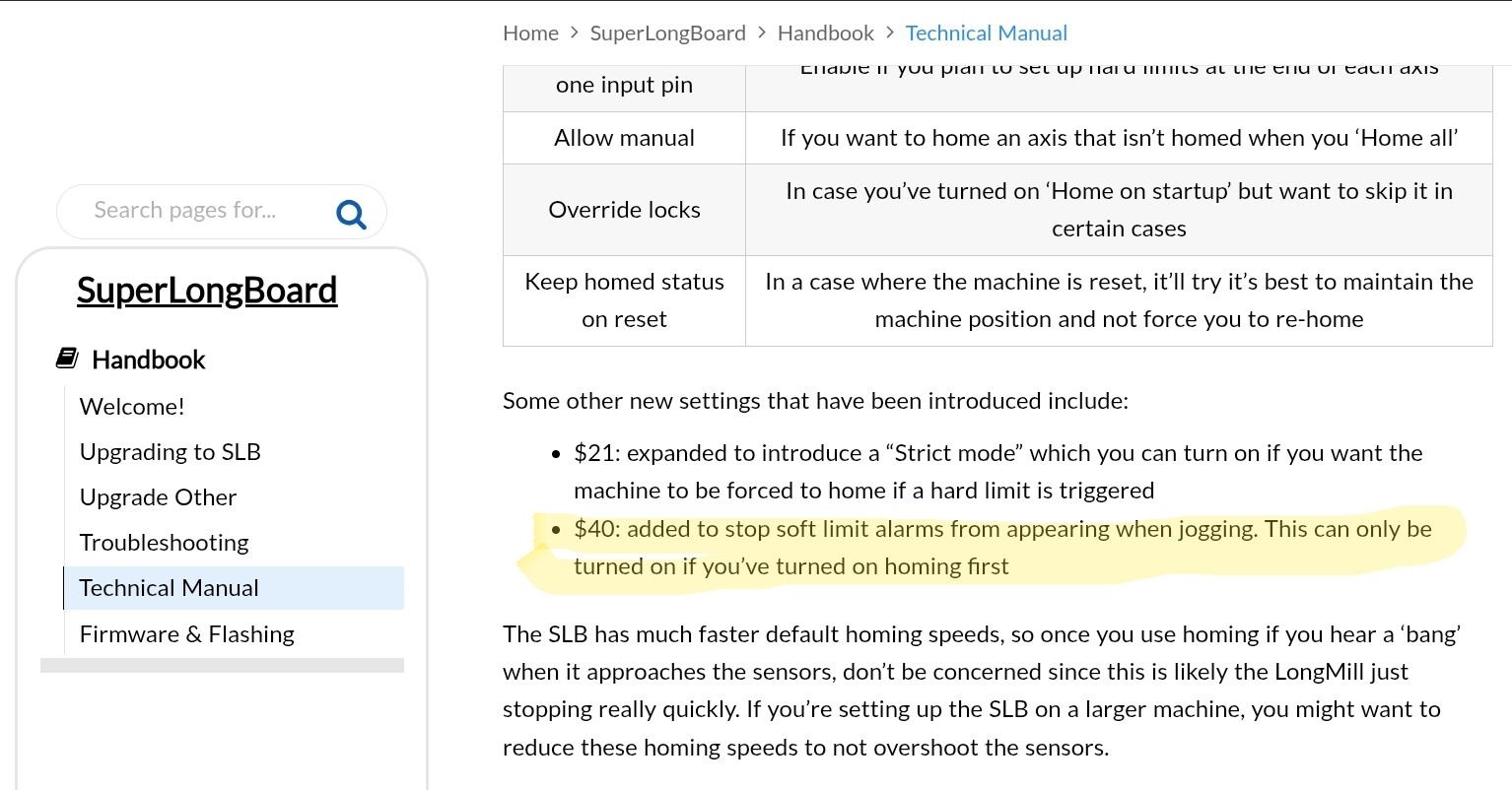

And finaly, maybe this setting is helpfull.
 ![Screenshot_20250421-224551_Chrome](https://forum.sienci.com/uploads/default/original/2X/6/6503db4396175a0b2745215c3c5379c0ff9b299d.jpeg)
> **[Technical Manual - SuperLongBoard](https://resources.sienci.com/view/slb-manual/#limits-settings)**
> Documentation for the SuperLongBoard, a next-generation, 32-bit control board for the LongMill and other CNC routers. Includes electrical and mechanical specs.
Chances are yall know about this and I am just yapping basics everyone with switches knows. If that’s the case, just ignore this post, smile and wait for the real smarties to help yall along.
**Author:** ![Chrisp](https://forum.sienci.com/letter_avatar_proxy/v4/letter/c/87869e/32.png) [@Chrisp](https://forum.sienci.com/u/Chrisp)\
**Post date:** [April 21, 2025, 9:21pm UTC](https://forum.sienci.com/t/error-15-when-jogging/16948/5 "2025-04-21T21:21:26Z")
Well, enabling $40 seems to fix it! Thanks!
