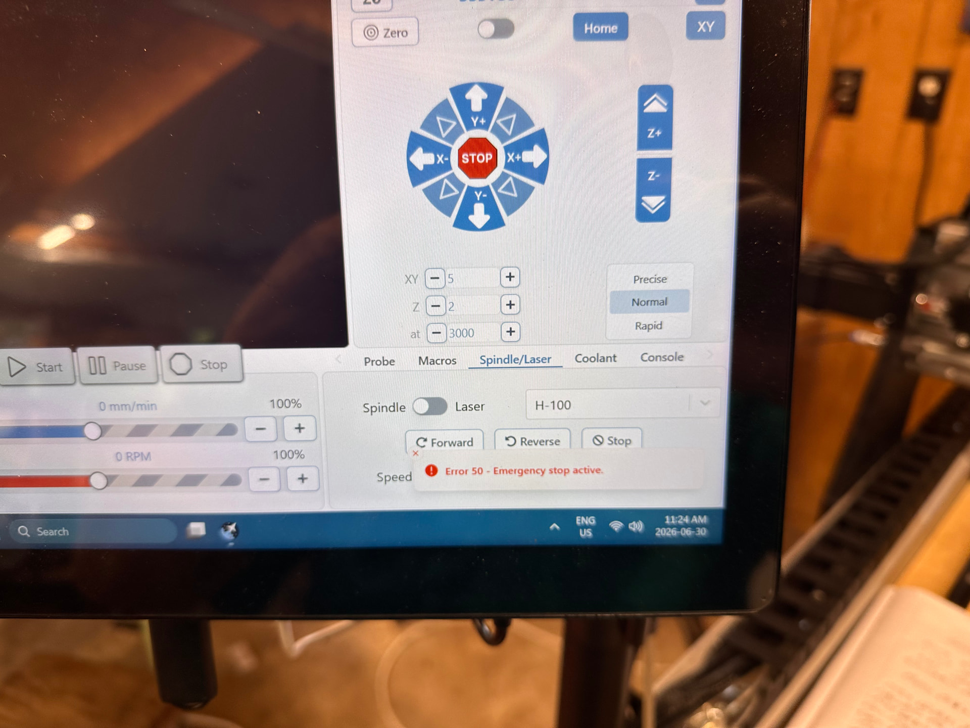

I am new to this machine and have been anxious to get it going. I’ve gotten my machine together and have been trying to get it to run. I have an error 50 message that the E stop is active, and I have not been able to clear it. The two red lights on it are not on. I have checked the wiring and connections, and everything seems to be correct. I had the machine jogging around and going to home, but it will not do any of that now. I sent a message to Scienci several hours ago but have not heard back from them. I would appreciate any advice.

That’s strange. Don’t even see 50 listed [Alarms List – Sienci Labs](https://sienci.zendesk.com/hc/en-us/articles/33321741516436-Alarms-List) or [Errors List – Sienci Labs](https://sienci.zendesk.com/hc/en-us/articles/33321836887700-Errors-List) . I assume you have tried powering everything off and back on?

Silly question - you did check that the estop button was released right? (twist knob to let it pop out)

When you checked all the connections, did you check the connections on the motors? Did you check the connectors on the controller (they have a nasty habit of coming undone). Did you try unplugging and re-plugging all the connections? Did you examine the motor connectors for a possible loose wire? I don’t know if this would work but maybe see what happens if you disconnect the estop cable at the controller.
BTW, all my suggestions are based on your mill being an Altmill … if this isn’t the case then please explain your setup in detail. The error 50 that is not supposed to exist is a puzzler!
### Author: ![gwilki](https://forum.sienci.com/user_avatar/forum.sienci.com/gwilki/32/366_2.png) [@gwilki](https://forum.sienci.com/u/gwilki)
#### Post date: [June 30, 2026, 11:03am UTC](https://forum.sienci.com/t/error-50-e-stop-active/26648/6 "2026-06-30T11:03:28Z")
@Roysecreekdesigns Welcome to the group, Darrell.
Can you post a screen cap of the error you are seeing? Generally error 10 is the estop-related error. As the others have said, error 50 does not seem to be on the list.

 ![IMG_2953](https://forum.sienci.com/uploads/default/original/2X/0/09829b7940dd0563b38a44ec29effe0d03127c50.jpeg)Good morning Gwilki, I tried to respond to your and others messages about my problem the day before yesterday and yesterday, I got the message on Monday that because I was new to the group I had exceeded the number of responses I could make and that I needed to wait 24 hours to respond to send another response. Yesterday I tried to respond to you but got the message that because I was new to the group that I could not respond for 10 more hours, So I will try again this morning. I did get in touch with Danial at Scienci and he is helping. It seems the 50 e stop active is related to a software issue. I have a PWN 2.2kw 80 mm 220-volt water cooled spindle on my CNC and there needs to be some changes made in Gsender to make it go in automatic mode. Hopefully Danial can help me figure this out and hopefully I will be able to post in this forum. I have been using a much smaller CNC for a few years and wanted to upgrade. I am still learning this CNC stuff and look forward to being a part of the group. Thanks, Darrell

@Roysecreekdesigns Thanks much for posting that. It’s an error that is not listed on the Sienci site so I was no help at all. 😀 I’m sure that Daniel will get you fixed up. Please report back when your issue is resolved and what the resolution was. It will help others going forward.

#### Post date: [July 17, 2026, 12:28am UTC](https://forum.sienci.com/t/error-50-e-stop-active/26648/9 "2026-07-17T00:28:00Z")
