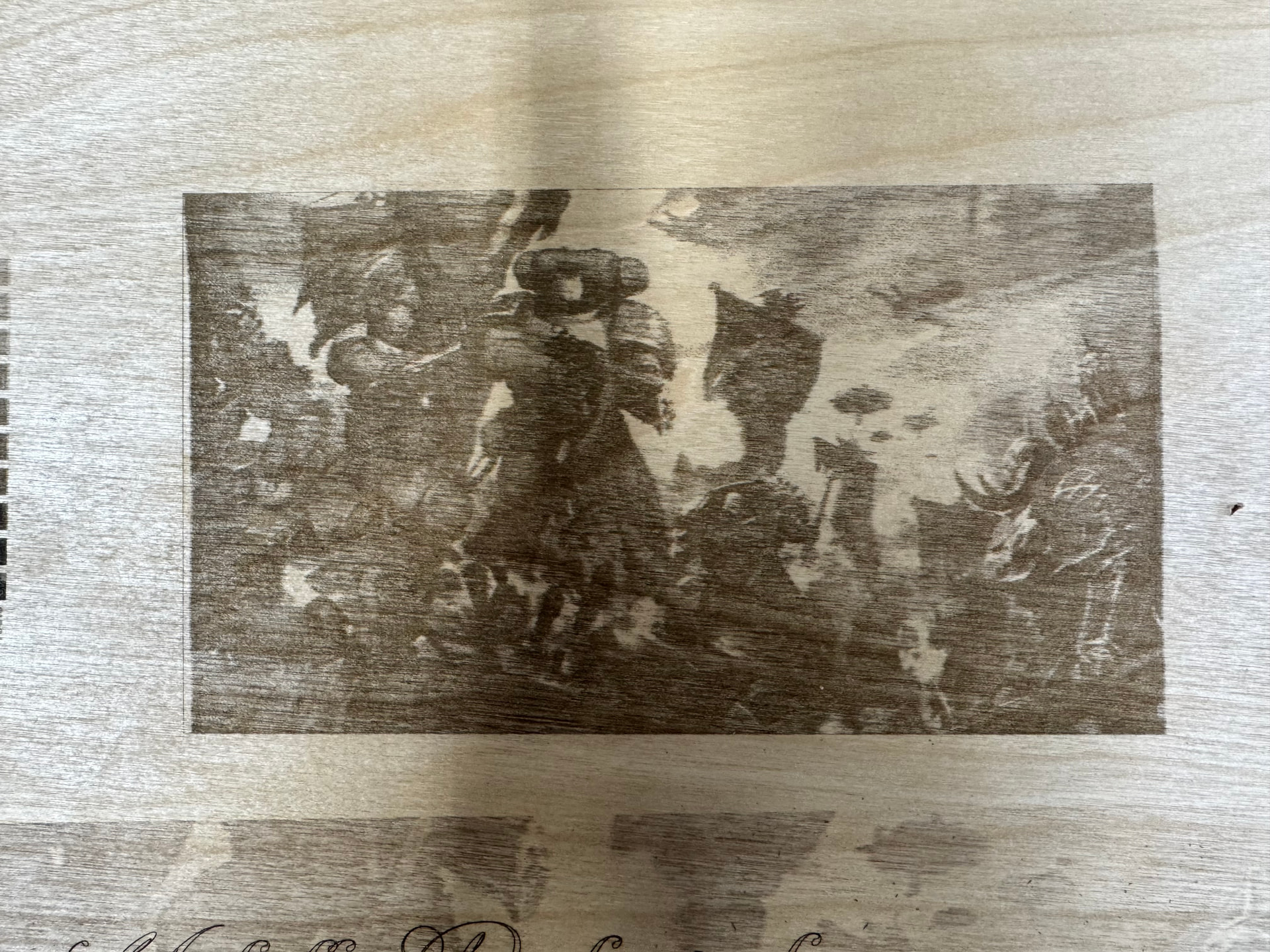

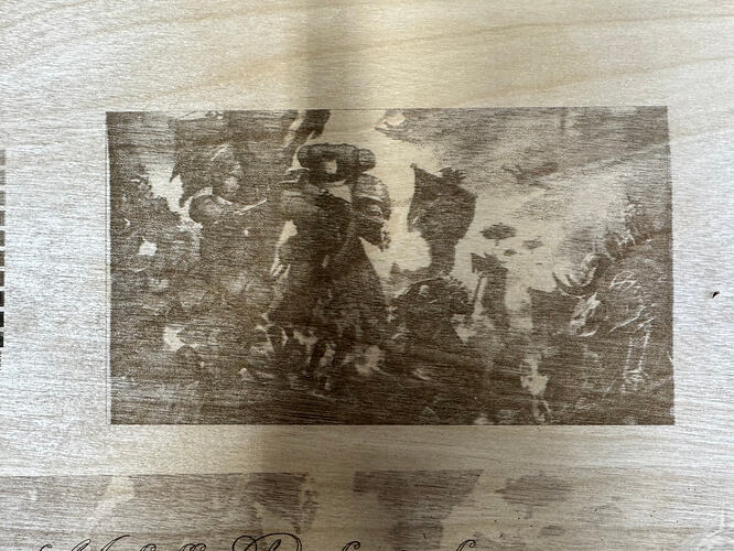

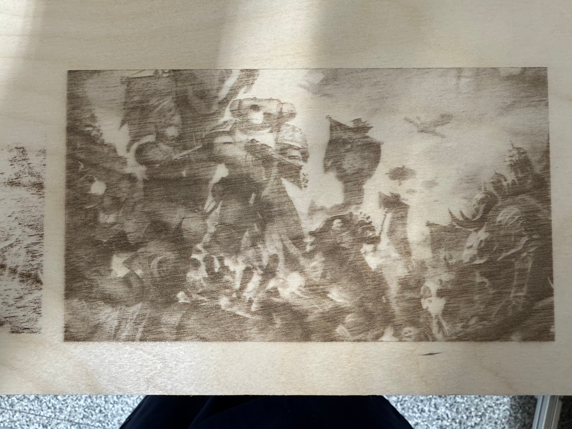

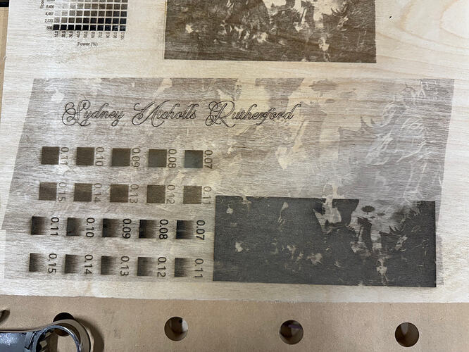

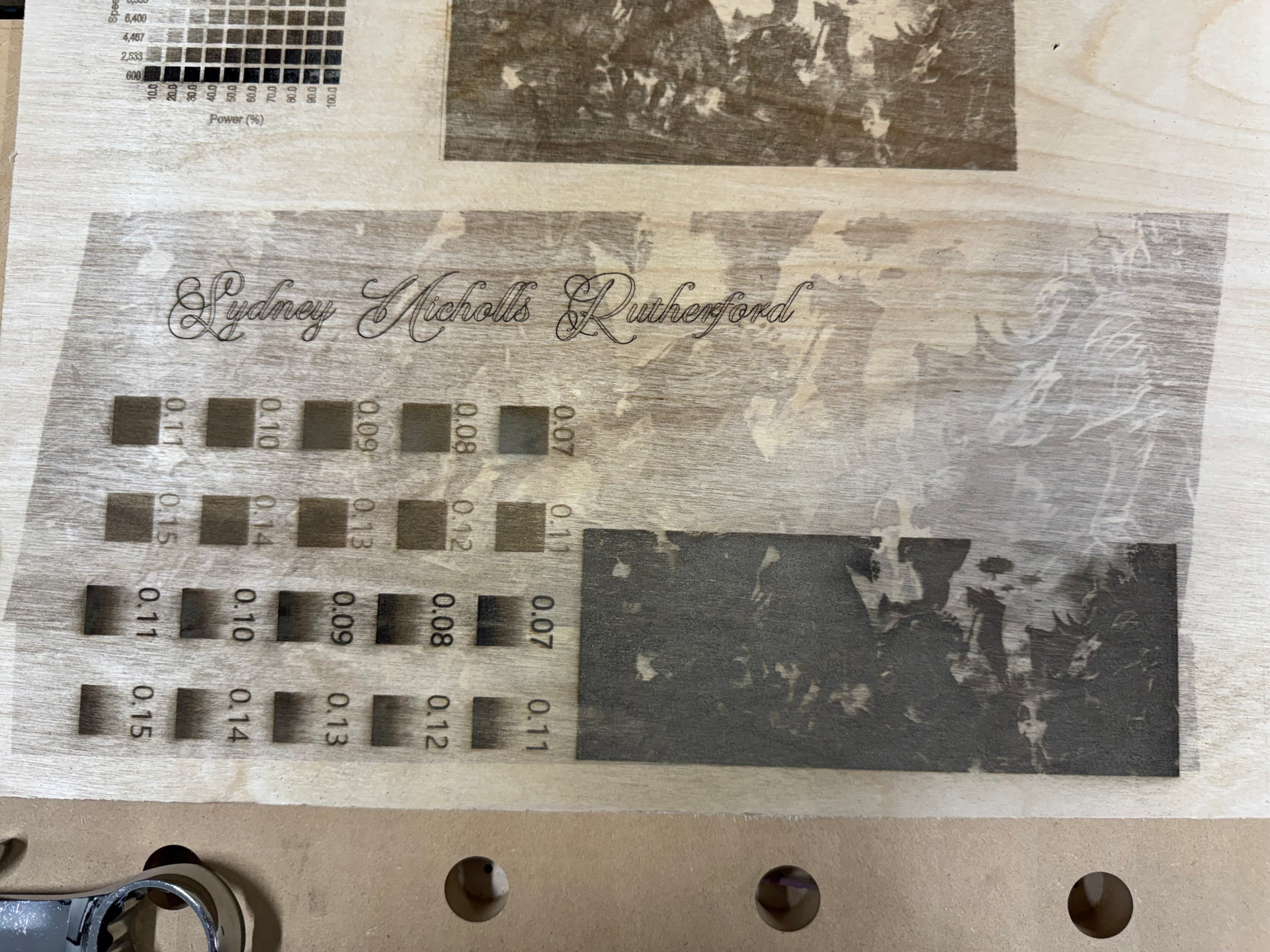

Let me know how much luck you have. I’ve done some simple stuff with writing, etc. that has looked pretty good. I believe I used pretty near the 60 mm height +/- 0.5 mm or so with good results. 40% or less, speeds of 3,000 mm/min max. A lot of things I saw suggested to do more like 100-300 mm/min but that would take FOREVER if you’re doing a photo. I have a lot more fiddling to do. Here’s some of my tests:
