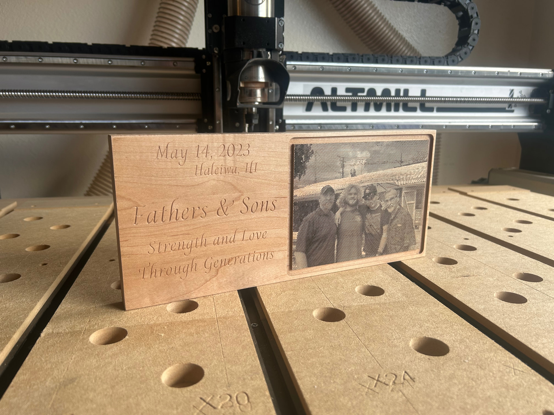

First time attempting the Photo Vcarve. Made in honor of my father’s passing last year. Nothing crazy fancy, but I’m pleased with how it turned out.
I can see me doing a lot more of these types of carves. The Vectric software makes me appear far more skilled than I actually am!!

Very nice! what settings and bit did you use?
**Author:** ![Sawdust\_Manufacturer](https://forum.sienci.com/letter_avatar_proxy/v4/letter/s/6bbea6/32.png) [@Sawdust\_Manufacturer](https://forum.sienci.com/u/Sawdust_Manufacturer)\
**Post date:** [December 9, 2025, 1:13am UTC](https://forum.sienci.com/t/first-photo-vcarve-project/25142/3 "2025-12-09T01:13:41Z")
Thanks! I used a 60 degree vbit for the photo and wording and a 1/4” downcut end mill to frame and highlight the photo. Then just used a block plane to knock off the sharp edges.
For the settings, I used 0.04” max depth of cut, which gave me decent detail while not being too fragile to sand down.
