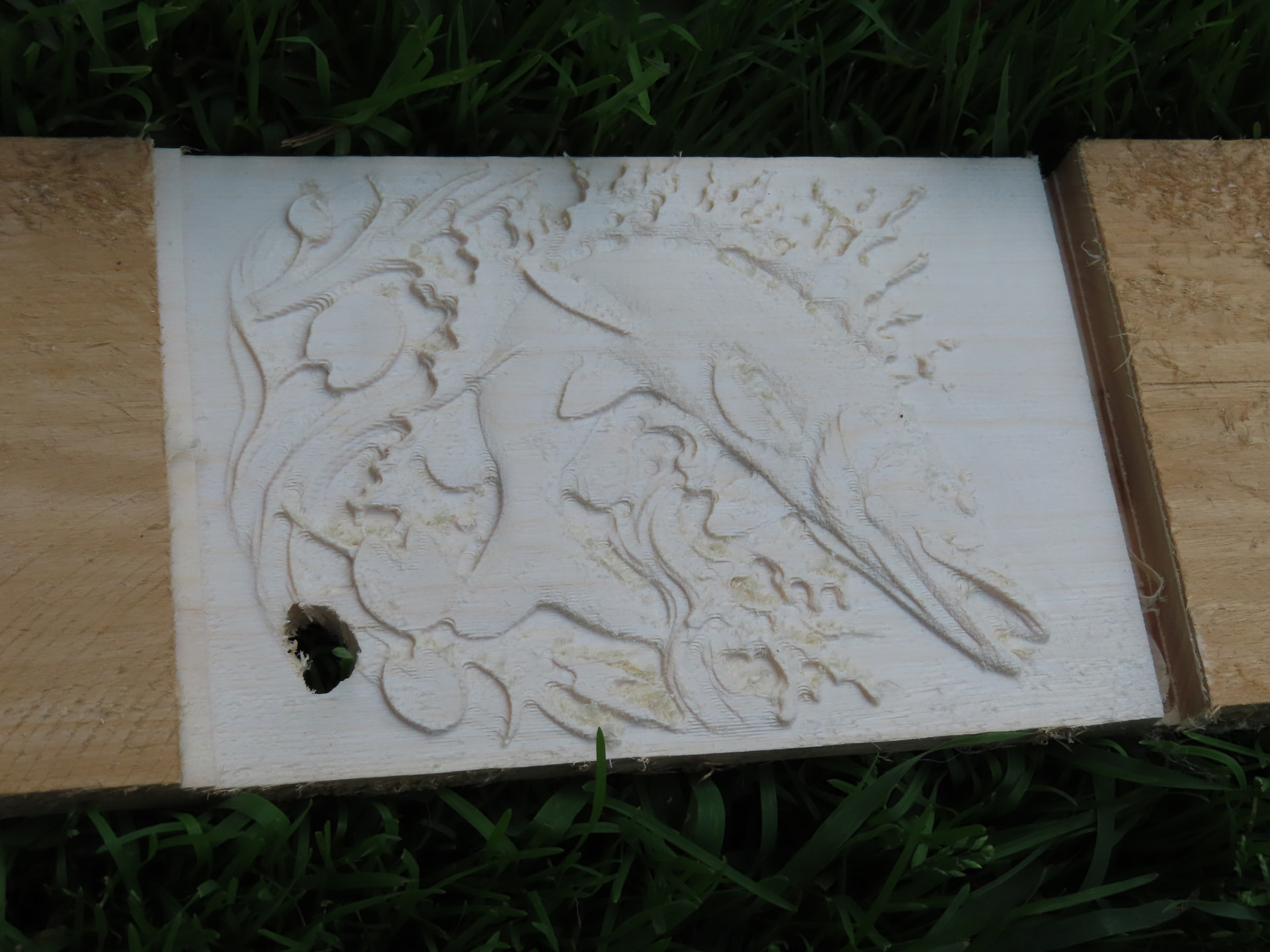

I got a file from Etsy (an STL that I imported into Fusion). I was a little surprised that the STL file had almost no depth compared to the image they showed in the store. Is that normal?
In any case here is the results. It was on some softwood pallet wood. A lot of it was good learning exercise. The big hole is when I was only using double sided tape and piece came loose. Backside was also not completely flat so I’m sure that didn’t help.
The finishing pass was with a 1/8" flat end mill because I currently don’t have anything smaller or different of that size. The finishing passes also went in parallel with grain of wood which I’m wondering if it was a mistake. Sometimes there would be long strings of wood from a pass that would even get wrapped around the bit. There was a lot of fuzziness and even “stringiness” left on the piece.

> [@DavidB](#):
I had that when I did the roughing pass on my basswood blank. Lots of them actually. I think the finishing pass was fine.
As for the height of your model, Vectric vCarve can adjust that. I assume Fusion can too.
**Post date:** [July 3, 2026, 2:01am UTC](https://forum.sienci.com/t/first-test-project/26667/3 "2026-07-03T02:01:20Z")
@DavidB You may have better luck if you can set your passes to go 45° to the direction of the grain. I don’t know if that’s possible in fusion. I use VCarve exclusively. If you can’t do that in Fusion, consider rotating the material 45° for the model carving.

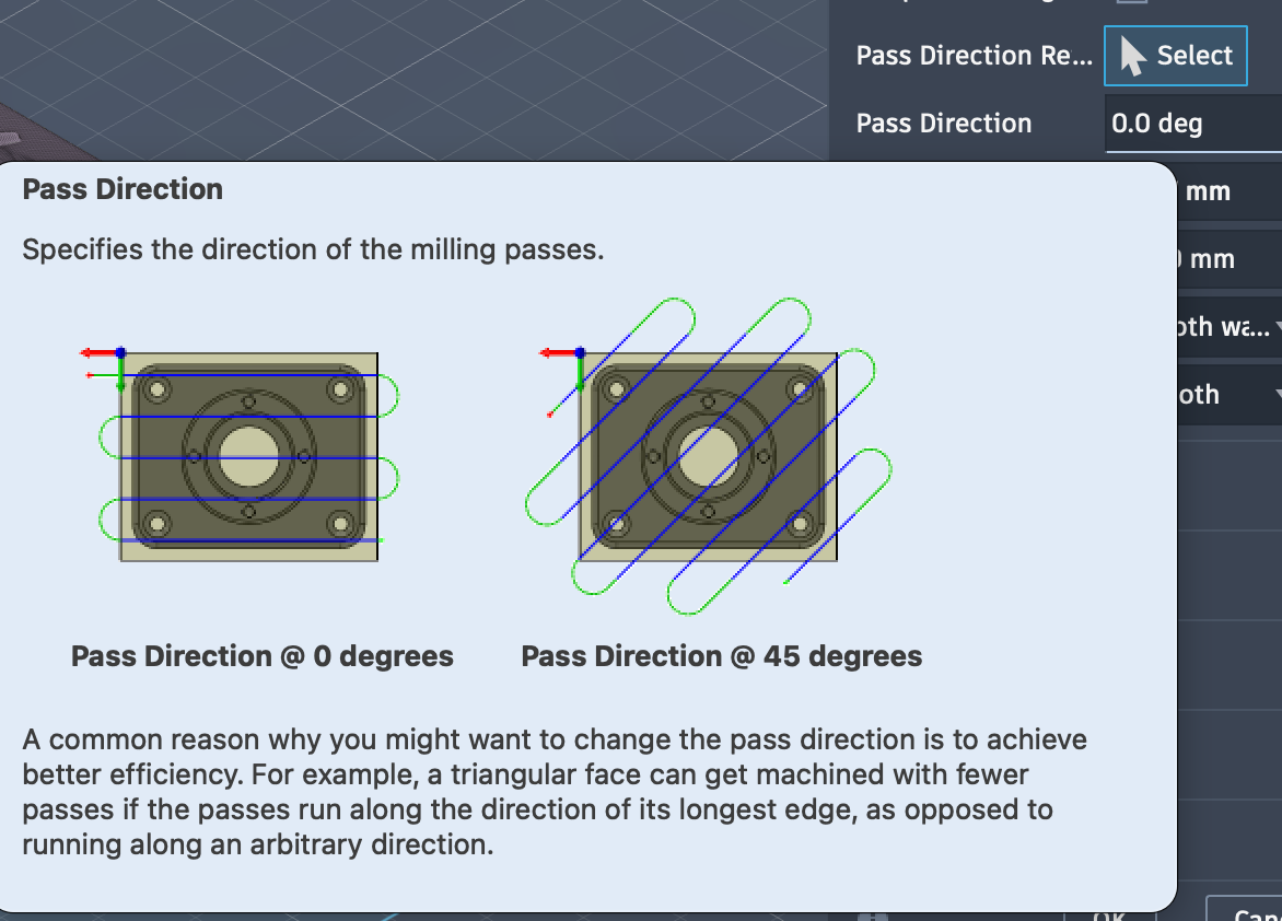

**Post date:** [July 3, 2026, 3:19am UTC](https://forum.sienci.com/t/first-test-project/26667/4 "2026-07-03T03:19:06Z")
> [@gwilki](#):
Just saw this:
 ![Screenshot 2026-07-02 at 10.15.02 PM](https://forum.sienci.com/uploads/default/original/2X/0/0e6b46ab805faad5ecd79eec488526f9def50829.png)
Maybe not using a ball nose contributes to the stringy wood?
@Chucky_ott I forget if your basswood tests were going at an angle or not for finishing pass?
**Post date:** [July 3, 2026, 8:01am UTC](https://forum.sienci.com/t/first-test-project/26667/5 "2026-07-03T08:01:31Z")
@DavidB Test results are here: [Feeds and speeds - the topic that just won't die - #12 by Chucky\_ott](https://forum.sienci.com/t/feeds-and-speeds-the-topic-that-just-wont-die/26561/12)
The 45° finish pass have the worst results.
FWIW, you’ll definitely get better results when you switch to a TBN. A flat end mill for a finish pass on a 3D carve will not give a great finish.

I would concur with everyone else cutting at 45 deg solves a lot. The other I would make 2 toolpaths i using 1/8 flat end mill as a rough cut then 1/8 1mm tapered ball nose as the finish cut to get a cleaner smoother cut. I use Carveco witch allows you set height and width and depth of the cut. So you get more 3D detail.
