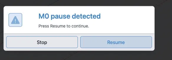

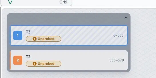

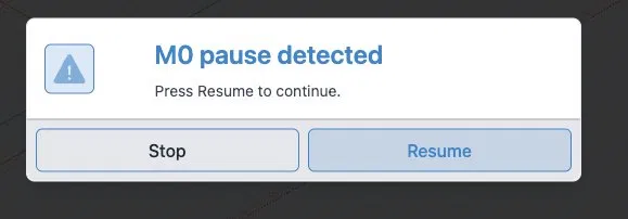

Thank you — I just tested these items against Edge-5. I use AI to help keep notes so I can keep all of this straight, so please don’t judge me for the organized format — I’m a real person who really wants to stay away from Carbide Motion, and I suspect there are many others in the same boat.
Regarding 1.6.1 stable on Mac — the Intel-only build runs under Rosetta 2 on Apple Silicon (M4) which causes 10-15 second lag between operations and jog buffering that drives the endmill into the spoilboard. That’s why I’m on Edge arm64.
I tested all three issues against Edge-5 on the same machine (Shapeoko 5 Pro, Grbl 1.1h, macOS arm64). Here’s what I found:
**Still present in Edge-5:**
- Fixed Tool Sensor “Probe Changed Tool” button still greyed out after initial probe completes
- MSG comments in Code strategy M0 pauses still not displaying in the pause dialog — both pauses show generic “M0 pause detected”
- Unprobed badge still not updating after successful probe via Code strategy
**Positive improvement in Edge-5:** The tool timeline showing both tools (T3 and T2) with line ranges is a really nice addition — much easier to see where you are in a multi-tool job.
I’ve attached screenshots for each issue. Thanks for all the work you’re putting into gSender — the Code strategy workaround is running reliably on my machine and the arm64 build is a huge improvement over running 1.6.1 under Rosetta. Happy to test any fixes when they’re ready.

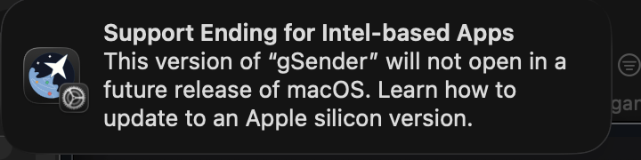

**Post date:** [May 14, 2026, 12:56pm UTC](https://forum.sienci.com/t/fixed-tool-sensor-probe-changed-tool-button-permanently-greyed-out-edge-4-grbl-macos/26385/9 "2026-05-14T12:56:11Z")
> [@KGN](#):
> Mac-Universal is Intel, Mac-Silicon is ARM64.
This is not the proper terminology for Macintosh applications (being a macOS developer myself) which is why this is causing problems. Universal means it has BOTH Intel and “Mac silicon” so that when a user downloads a universal app it automatically runs the proper architecture no matter which Mac you have. The “universal” that is currently there should be named “x64” or “intel” which it was before it was improperly changed 2 months ago.
Please see this: [Building a universal macOS binary | Apple Developer Documentation](https://developer.apple.com/documentation/apple-silicon/building-a-universal-macos-binary)
I opened a support ticket to ask someone to fix this since this is wrong and causing issues for people who think they are downloading a “universal” app. On macOS 26.5 and newer you even get a warning now when you run the gSender “universal” app:
 ![Screenshot 2026-05-13 at 5.04.20 PM](https://forum.sienci.com/uploads/default/original/2X/d/dc7697c906bee1ae6651c1eafbd1a9de2c730e56.png)
