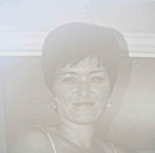

@Jens That definition in wiki is very incomplete. I’ve done lithophanes on my Long Mill, using Vectric applications. There was no moulding involved. I carved them as relief carves. Vectric has videos on how to do them for anyone interested.
This is the first one that I tried. It’s old, but you get the idea.

**Post date:** [February 2, 2026, 1:34pm UTC](https://forum.sienci.com/t/freecad-3d-relief-carvings-made-easy/25585/7 "2026-02-02T13:34:19Z")
I stand by my original statement that lithopanes are not relief carvings.
You could argue that you can generate a lithopane using relief carving methods but they are fundamentally different things. Lithopanes are meant to have a light shine thru them to provide a good outcome while a relief carving produces it’s beauty without light.
You perfectly demonstrate this with your example pictures - without light shining thru your example it is rather dull and dare I say ‘ugly’ … get some light flowing through it and you get a beautiful picture.
Having said all that, I have never generated a lithopane and have no desire to do so but I have generated relief carvings and love the end product.
**Post date:** [February 2, 2026, 1:49pm UTC](https://forum.sienci.com/t/freecad-3d-relief-carvings-made-easy/25585/8 "2026-02-02T13:49:28Z")
@Jens We can agree to disagree. You are correct, without the light, my first-carved lithophane is far from attractive. Athough, they can be much more attractive than the one that I posted. However, I’ve seen some very “ugly” moulded ones, too. 😀

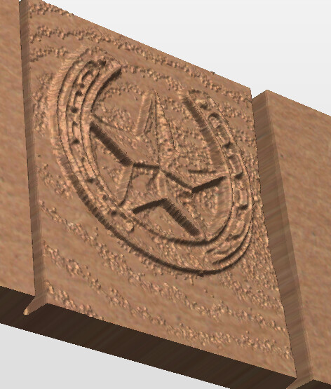

@Jens Lithophanes may not be relief carvings, but in this instance I’m just using the produced lithophane to produce a relief carving.
From that video, what you end up with after the export is an stl file.
Then import that stl file into Vcarve as a 3D object. When importing, the first question you’ll be asked is about size and position. In the size piece, what I found is first, with the “lock xyz” check, select either an x or y for the piece of wood you want to carve. That will actually also modify the “z” which is what will become your relief depth. So after you get your x/y set, then uncheck the “lock xyz” button and change only the “z” setting. For a 3/4” piece of wood, I like to change it to something like 0.4 or so. Again, this will become the depth of your relief carving.
Once you get that set and “ok’d” the next page will let you select the position of the import relative to the top of your material. It will default to whatever you set “z” above, which is what you want.
That will complete the import. Now go to toolpaths and select a finish 3D finishing toolpath to create the toolpath.
Here’s a couple of snips from the rendering in Vcarve of a couple of pictures I’ve done this way.
The depth of the carve for each of these is 0.4 in. So that’s how deep the relief will be. If you want them deeper or shallower, adjust the “z” when you import the STL file. Also, if you don’t like how it does the background parts, modify you’re pic prior to doing the lithophane in freecad to either remove the background or convert it to a solid color.
I’ve taken the same photo and imported into the Vectric AI tool. The results are just about the same as this method. But no credits required to run through many iterations to get what you want.

**Post date:** [February 2, 2026, 3:38pm UTC](https://forum.sienci.com/t/freecad-3d-relief-carvings-made-easy/25585/10 "2026-02-02T15:38:59Z")
OK, maybe I am getting hung up on semantics.
Your first pic looks like a relief carving, the second looks like a lithopane but I can see the different levels of thickness so maybe I am wrong.
Neither one of these examples, IMHO, is something that I would consider a relief carving but yes, there is relief and it’s carved so hey, what do I know …

**Author:** ![gabo](https://forum.sienci.com/letter_avatar_proxy/v4/letter/g/54ee81/32.png) [@gabo](https://forum.sienci.com/u/gabo)\
**Post date:** [February 2, 2026, 6:53pm UTC](https://forum.sienci.com/t/freecad-3d-relief-carvings-made-easy/25585/11 "2026-02-02T18:53:22Z")
Yep, the pic you posted is certainly a relief carving. And with a little tweaking, the pic above of the horseshoe and star can get pretty close to as clean as the one you posted.
There are several challenges in taking a photo and creating the clean relief carving like in your photo. The AI version from vectric has all the same problems. In Vectric Vcarve there are several ways to do these things. The photo vcarve toolpath, which is a much shallower rasterized version, but has a little depth to it. I’m not as fond of that style for most things, but it has its uses. Then there is the Sketch Carving toolpath, which is a bit more of a relief style carving, but I was also having trouble making that have the depth and look I wanted. Then there is the 3D toolpath, which just takes whatever 3D object you have and carves it however it is drawn in 3D space. Both the photo carve and Sketch carve methods work with 2D things and convert it to 2.5D with the tools you choose and the settings in those tools. The 3D toolpath carves whatever depth the 3D drawing you give it has.
To get the first two 2D methods to do a nice smooth relief carving like you’ve posted is pretty difficult. There is a very old thread on the forum here from someone who was fairly successful at it by really manipulating the photo. I tried some of that and I found it very difficult to make it work.
The method from the AI tool the Vectric offers, and from the lithophane tool are both actual 3D drawings. So both of those offer up something that can be controlled a bit more.
Relief carvings of things like flowers and ornamental things is easier, full picture relief carvings are a bigger challenge. Hopefully with refining the techniques a bit I can get to something that looks more like Mount Rushmore and get it done without spending a huge amount of time.
