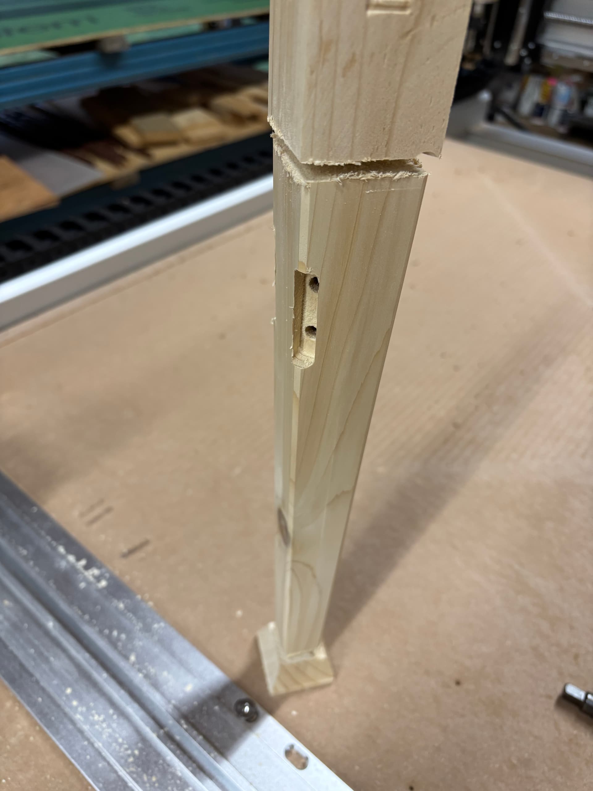

I recently bought an Altmill and Vortex rotary to go along with it. I use fusion at work, and find the machine simulation really handy, especially if you do any low clearance machining on a rotary. While setting it up I didn’t see much info on 3+1 or full 4 axis machining with the Vortex, or whether or not the standard fusion grbl post would handle an a-axis or machine sim. I just ran a test part and it handles both. I didn’t have to modify the post to get 4th axis functionality and the machine simulation worked pretty well out of the box. I had to do a little rearranging of sub-assemblies, but otherwise the files were as-provided from Sienci’s Onshape files. Overall, super stoked with everything so far!
This was just a made up part as a basic functionality test.

This was done on the subscription version of fusion without the manufacturing extension. To do simultaneous 4-axis machining you’d need the manufacturing extension, but you can do quite a lot with a 3+1 approach.

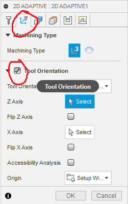

Added: I think I just don’t understand the 3+1 concept. I did some digging and it seems that in 3+1 machining you in effect ‘tilt’ the stock but the machining is still done as a plain 3 axis job? Looking at your picture, it looks like nothing requires the A axis to turn at the same time as X and Z is moving. The short movie bit you posted doesn’t make it clear to me what is happening.
This pretty much nails it. In this case the rotary is used as a positioner while the machining approach is the same as your normal 3-axis xyz job. This doesn’t seem like a big deal, but it can be a huge time saver!
I think it’s tempting to think of a rotary as a tool to make lathe parts on a mill. But I would argue that it is more a tool to reduce setups (ideally to 1) of more traditional mill parts. You can use it like a lathe by utilizing the “wrap toolpath” feature in fusion, though I have little experience with that. Almost all of the 4th axis machining I do is on tombstones and the wrap feature has little use if your part is not centered. (This is not on an altmill)
If you have a solid handle on 3-axis setups and strategies, then it’s a pretty small jump to using a rotary for 3+1 machining. In fusion you’ll notice there is a “multi-axis” tab when you are editing a toolpath. If you select the tool orientation box then you can just re-orient the wcs and machine from a new position. Don’t change the wcs origin.
For your setup you will want the wcs origin to be centered on the axis of rotation of the rotary. You have some freedom where it is along the x-axis. Your part does not necessarily need to be centered on this axis.
