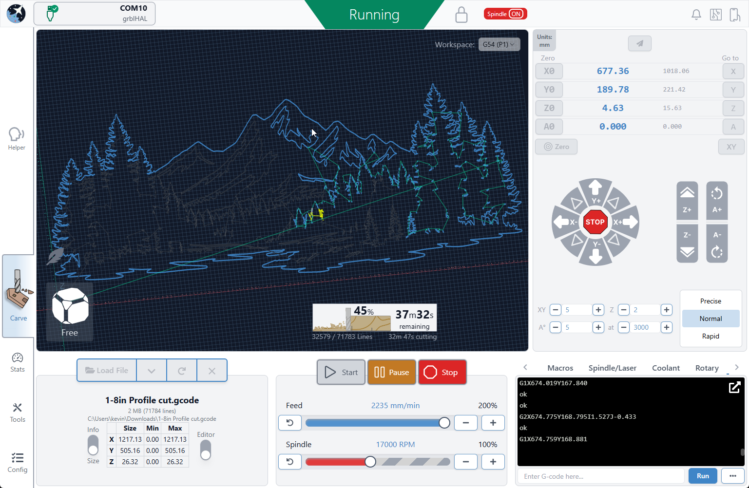

While trying to help a user who had problems running a g-code file, I observed the g-code would crash my system when running the file check. Details are in the other thread.
Diagnostic file is attached
[diagnostics\_3-2-2026\_10-05-34.zip](https://forum.sienci.com/uploads/short-url/qHcLvaaGhUBYBvVxCXupDNXFUiF.zip) (1.7 MB)
**Post date:** [March 2, 2026, 3:35pm UTC](https://forum.sienci.com/t/g-code-causes-job-to-crash-slb-requires-reboot/25832/2 "2026-03-02T15:35:24Z")
So I was looking into this and it seems to be not a gSender problem but a firmware issue.
I was able to recreate it on the SLB using gSender 1.5.7
For kicks, I ran the file through ioSender - exact same behaviour, idles at line 31186.
 ![ioSender_6RfMIUFRYQ](https://forum.sienci.com/uploads/default/original/2X/1/19608c748d9c0596a9f14cac9d498a43546952b7.png)
I’ll test the latest firmware/slbEXT on ioSender and gSender but it seems to happen regardless of sender, so not a gSender specific issue. I’m wondering if there’s an issue with planning the small movements on the firmware side.
**Post date:** [March 2, 2026, 4:20pm UTC](https://forum.sienci.com/t/g-code-causes-job-to-crash-slb-requires-reboot/25832/3 "2026-03-02T16:20:12Z")
SLB-ext and a later internal firmware (20251111) doesn’t hang the file. It does seem to be sienciHAL specific issue.

Closing this since it’s outside our control (firmware) and also fixed in modern grblHAL versions. Thanks to everyones hard work in the original thread in helping him clean up his toolpath.
