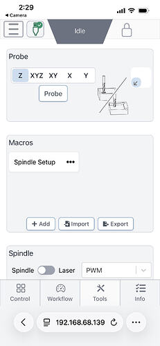

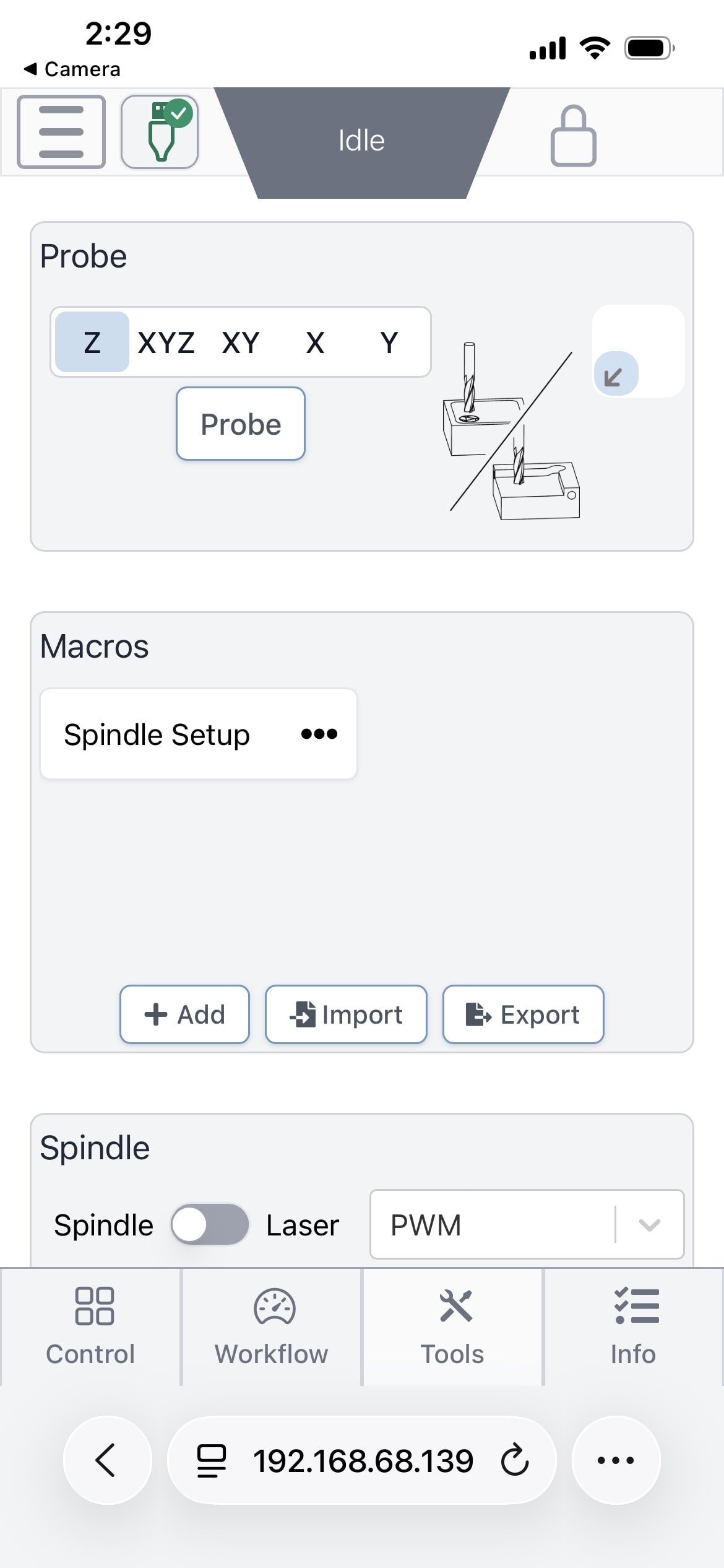

**Problem**
- On **iPhone Safari/Chrome** , the UI shows the Macros section under Tools, but no Macros display.
- If I use iPhone Safari to **add a new macro** , it appears to save (no error), and I can then see that new macro on the **laptop** (Safari/Chrome) and in the Pi JSON config file.
- However, the Macros list on iPhone Safari/Chrome remains empty the whole time, even after reloads or reconnects.
So: macros are clearly being saved centrally on the Pi and read correctly by laptop browsers, but **iPhone Safari/Chrome Macros view does not render any of them** , including ones created on the iPhone itself.

**Post date:** [April 23, 2026, 6:30pm UTC](https://forum.sienci.com/t/gsender-1-6-0-edge-5-on-headless-pi-iphone-safari-macros-tab-empty-but-laptop-shows-all-macros/26155/2 "2026-04-23T18:30:50Z")
Thanks, should be fixed as part of 1.6.1.
