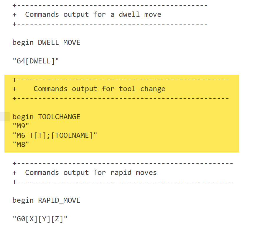

Actually Grant, you can have multiple tools in one file using the grbl post processors in VCarve. You just have to add the following to the Post processor:
 ![image](https://forum.sienci.com/uploads/default/original/2X/4/46843812cd2b893ff5d52841490911a1c95d165e.png)
Doing so allows you to save multiple toolpaths with different tools to the same file.
I’ve been using gSender with a Tool Length Sensor and a single file that contains multiple tools for quite a while now. It sure saves a lot of time saving one file per toolpath and loading all those files in gSender. It also eliminates the need to name them in a way to remember which is which and in what order (like when doing clearance passes. Eventually I’ll ante up and buy myself automatic tool changer…
You’ll notice that I added M9 before, and M8 after the tool change (M6) command. This was because my vacume wouldn’t turn off during the tool change. I added them to the Post processor because the tool change doesn’t seem to trigger gSender’s ‘Program Pause’ and ‘Program Resume’ events. It wasn’t a huge deal but it was annoying to have the vacume running for nothing 🙂
