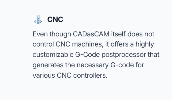

Looking at the sell point page of this software I notice this section.
 ![Screenshot_20260711_153340_Firefox](https://forum.sienci.com/uploads/default/original/2X/8/87e180e2c214bdf47a13ee76a02c6a44cfd61d57.jpeg)
That promisses some adjustability. Maybe look into editting the post processor either by trial and error or maybe asking it in their dedicated forum?

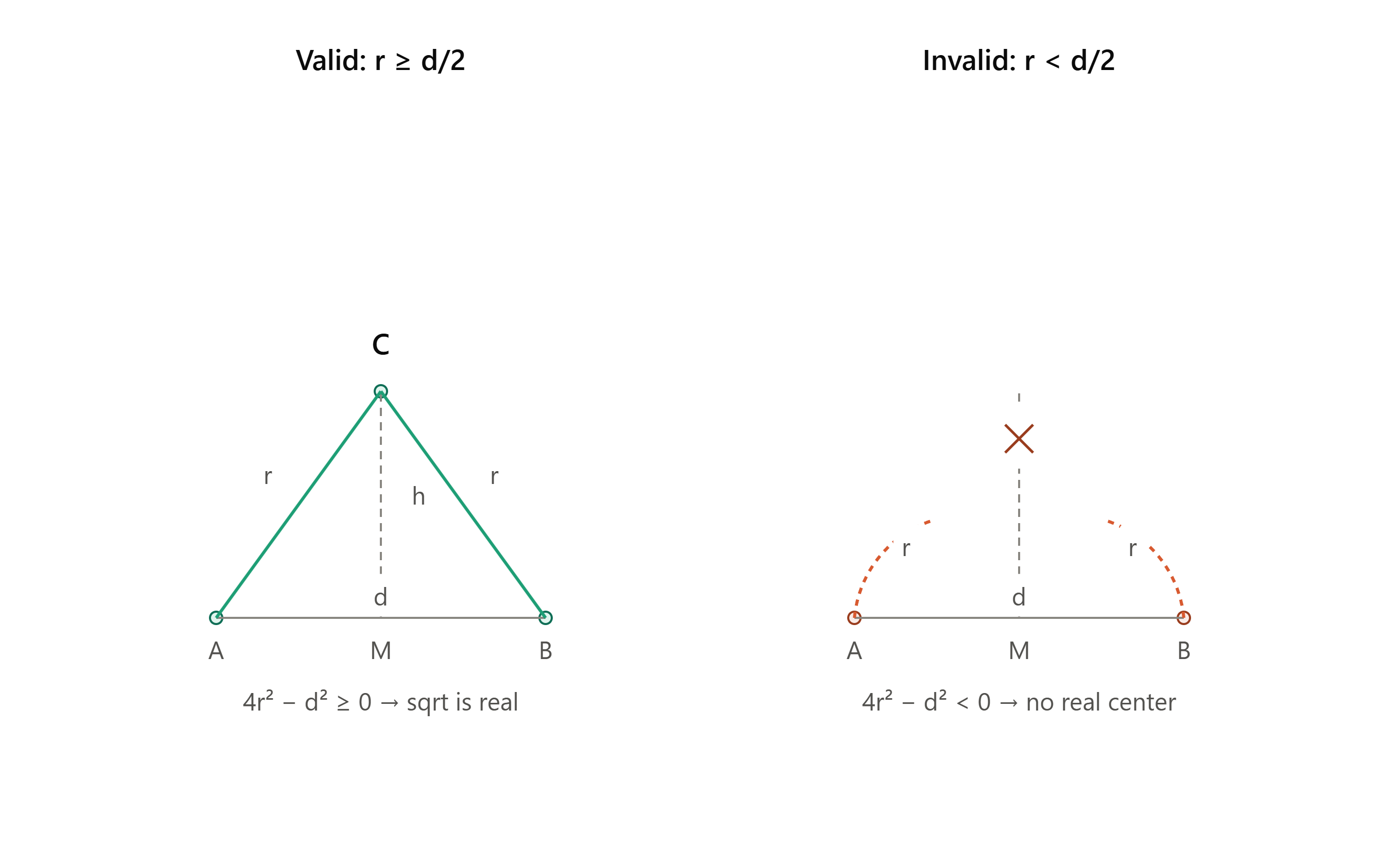

To clarify, gSender has nothing to do with parsing/handling the g-code, that would be the firmware.
There is a hint in the error message for your radius - you are failing the grblHAL internal validation on whether the R would bridge the chord of the movement, likely because the requested radius is too small or C thinks it is due to float imprecision.
ihttps://github.com/grblHAL/core/blob/09f8ba597abf54bc23da2bf2176065b84c94a4d2/gcode.c#L3511
 ![image](https://forum.sienci.com/uploads/default/original/2X/2/2dc69862b93f52968a95077c2147d26ed2af2ae8.png)
Just in general, grblHAL prefers arcs determined using plane (G17/18/19) and IJK movements if it’s possible to update the postprocessor in this software (or if it’s a configuration option)
