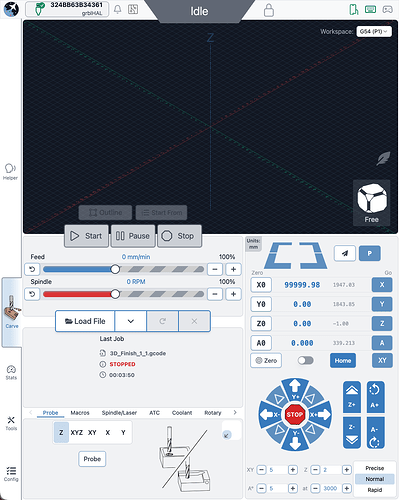

I have an issue with the layout of gSender, specifically the location of the move to the current XY home position. The button is simply too close to the return to Z home button location, which can easily be touched by mistake. Yesterday I did it twice, once breaking a tool and the next snapping a support arm off of my Francis Creation AutoDustBoot. Grrrrr.
The return to XY home button needs to be considerably larger and moved to a safer location.
**Post date:** [January 5, 2026, 2:25pm UTC](https://forum.sienci.com/t/gsender-gcontrol-layout-issue/25353/2 "2026-01-05T14:25:56Z")
@mick_s I totally agree that all the home, zero, and jog buttons are too close. I’d really want that section to be much bigger, even if it meant a smaller visualizer. In fact, I suggested the visualizer to be a pop out window that could be moved to a second monitor. Or maybe a tabbed layout with the large buttons on its own tab.
I’ve made several errors like you and now pause and double-check before pressing anything.

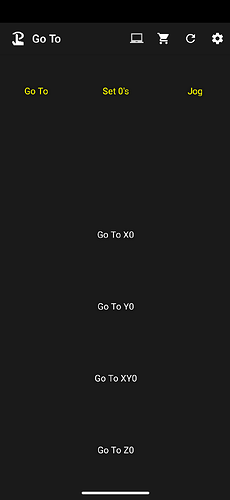

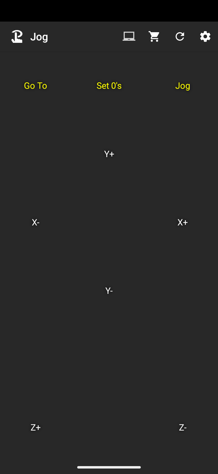

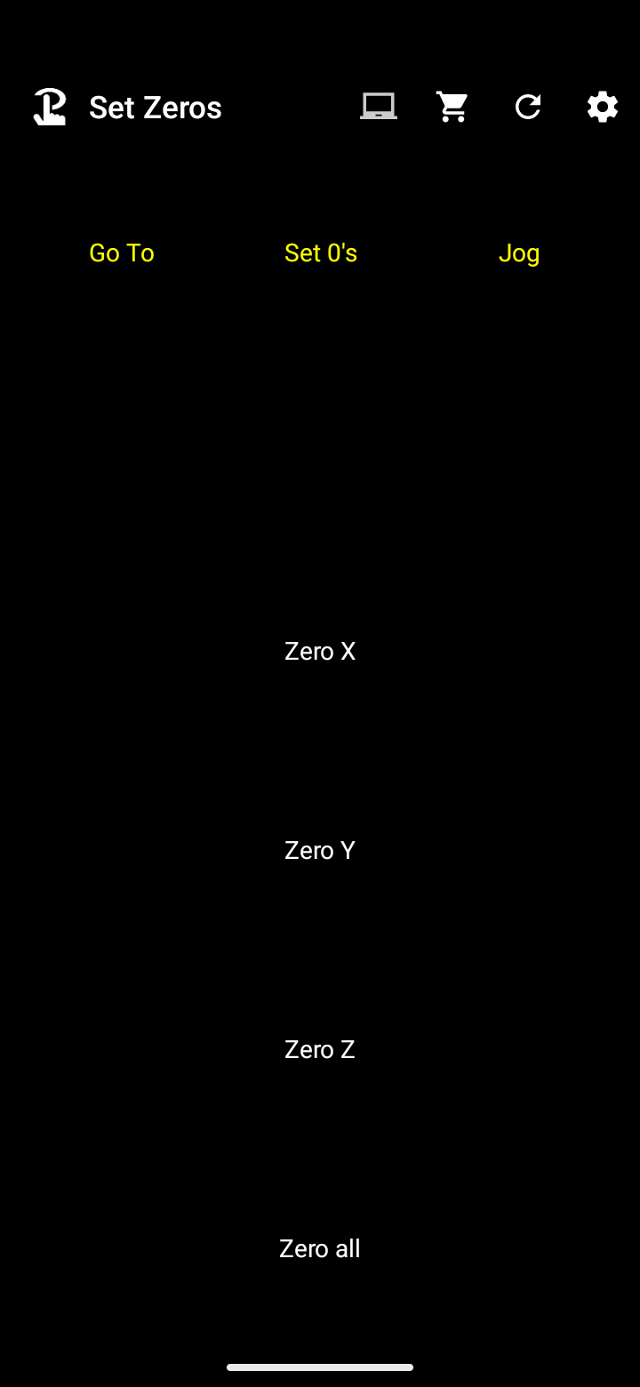

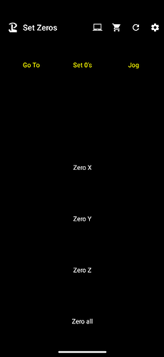

@mick_s I just downloaded Touch Portal to my phone and it does a decent job of it. I didn’t customize the buttons yet but so far I have three pages: one for the Go To’s, one for the Set Zeros, and one to Jog. Will try with custom icons when I have time.
By having each of these on separate pages, there are only a few buttons per page, making it easier to select the one you actually want. Unfortunately, the only way to switch page is to have a switch page button. So you’d need to use up three spaces for these buttons and do it on all three pages. There might be a better way but haven’t fount it yet.
If I had a tablet, they could probably all be on the same page.

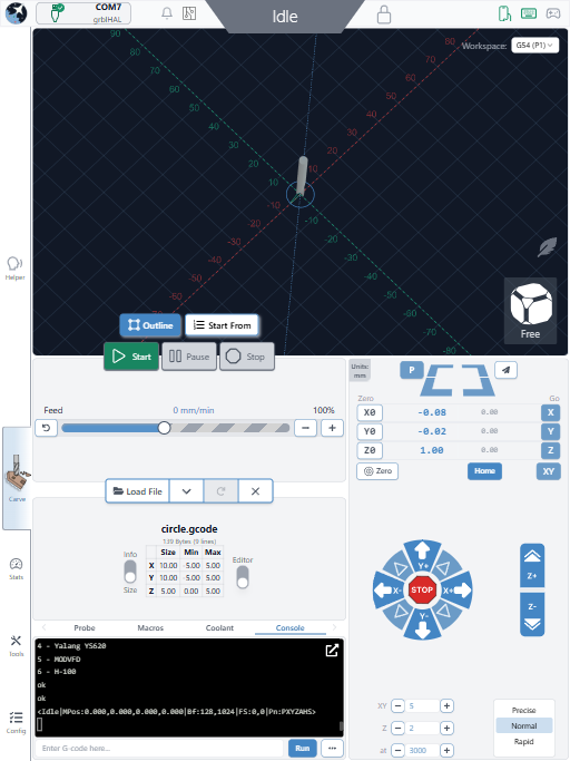

**Post date:** [January 14, 2026, 6:31pm UTC](https://forum.sienci.com/t/gsender-gcontrol-layout-issue/25353/13 "2026-01-14T18:31:23Z")

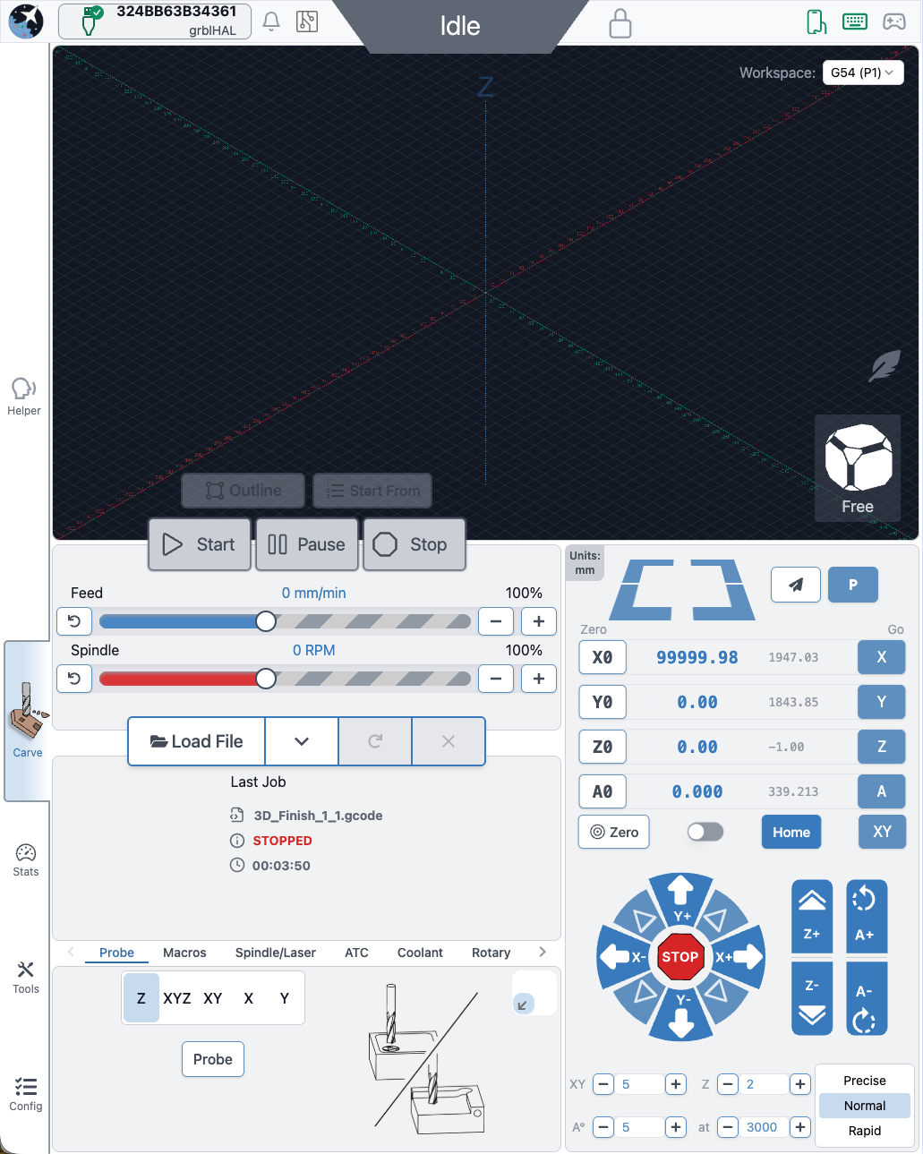

The next Edge build should have some tweaks to portrait mode layout to have better use of space and larger elements.
Before:
 ![chrome_2O5MaeGK5O](https://forum.sienci.com/uploads/default/original/2X/7/73ab5a3683dbe687a41ddd92a6e55be515f3cc33.png)
After:
 ![image](https://forum.sienci.com/uploads/default/original/2X/1/1a4f1c8b3eb1f2116464264d0ac9bd419506fc1d.png)

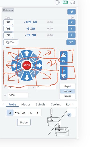

Why isn’t gSender optimized for the screen size of the gControl?? The icons/buttons are far too small to be legitimately used as a touchscreen item. The fonts are too small and there’s far too much empty space that could be utilized to enlarge all of the above items. I understand the Z buttons change when A axis is enabled but the jog control definetly should be enlarged. You mention that it’s being optimized for portrait view but does that mean landscape view continues unchanged? Before you ask, I have played with the scale and text sizes of my gControl panel and maxed it out so that I don’t have to scroll at all and still be able to see/use all the controls. Honestly the layout/sizing is my biggest gripe about the software. I really hope you guys continue to push and improve it like you guys always do. Thanks for your work!
 ![IMG_0677](https://forum.sienci.com/uploads/default/original/2X/6/6737b73601bd7797e21bb563cbfa444c7ca478fc.jpeg)
**Post date:** [March 16, 2026, 3:25pm UTC](https://forum.sienci.com/t/gsender-gcontrol-layout-issue/25353/18 "2026-03-16T15:25:04Z")
These optimizations have been available in the past few Edge builds.
