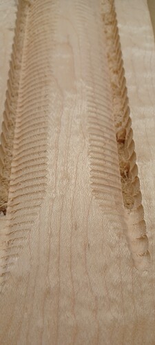

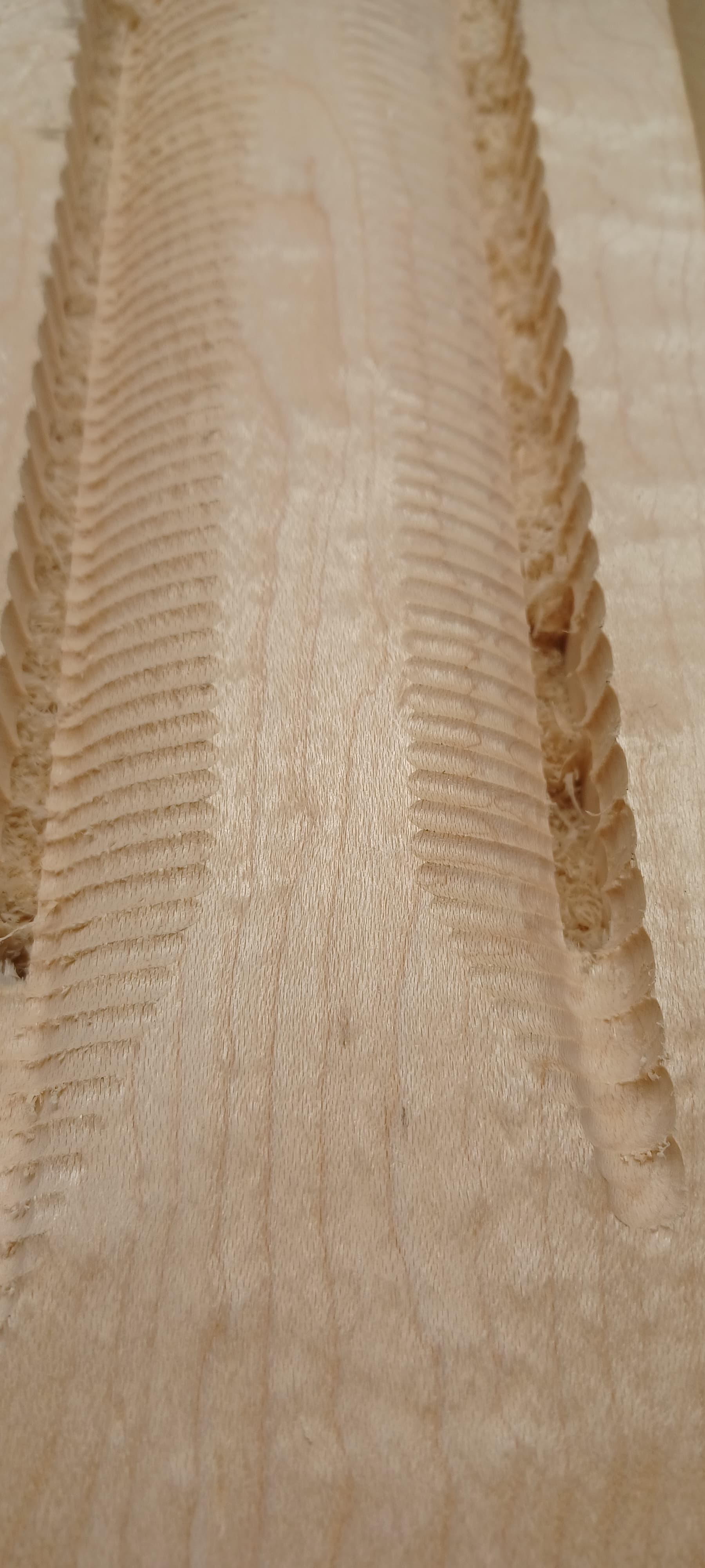

Hi, I’m having problems with the back of my guitar neck, the back of the neck radius is always off, one side is always thinner than the other ??? I thought it was a centerline problem, I’ve tried so many things, 2 dowels on the centerline, 4 dowels, screws, tape, it doesn’t make any difference. Always the same results. I made the CAM with fusion 360, I have even remodeled the whole neck ??? Could it be the machine ? Annonce had the same problem ? Thanks for your Help ! (First post here)

Hey there! I, too, had this issue when I first started making necks. The problem I had was that the machine was skipping steps. Slowing down the feed rate and/or using more step-downs greatly helped. If you’d like to share your file, I’d be happy to take a look at it. Also what machine are you using?

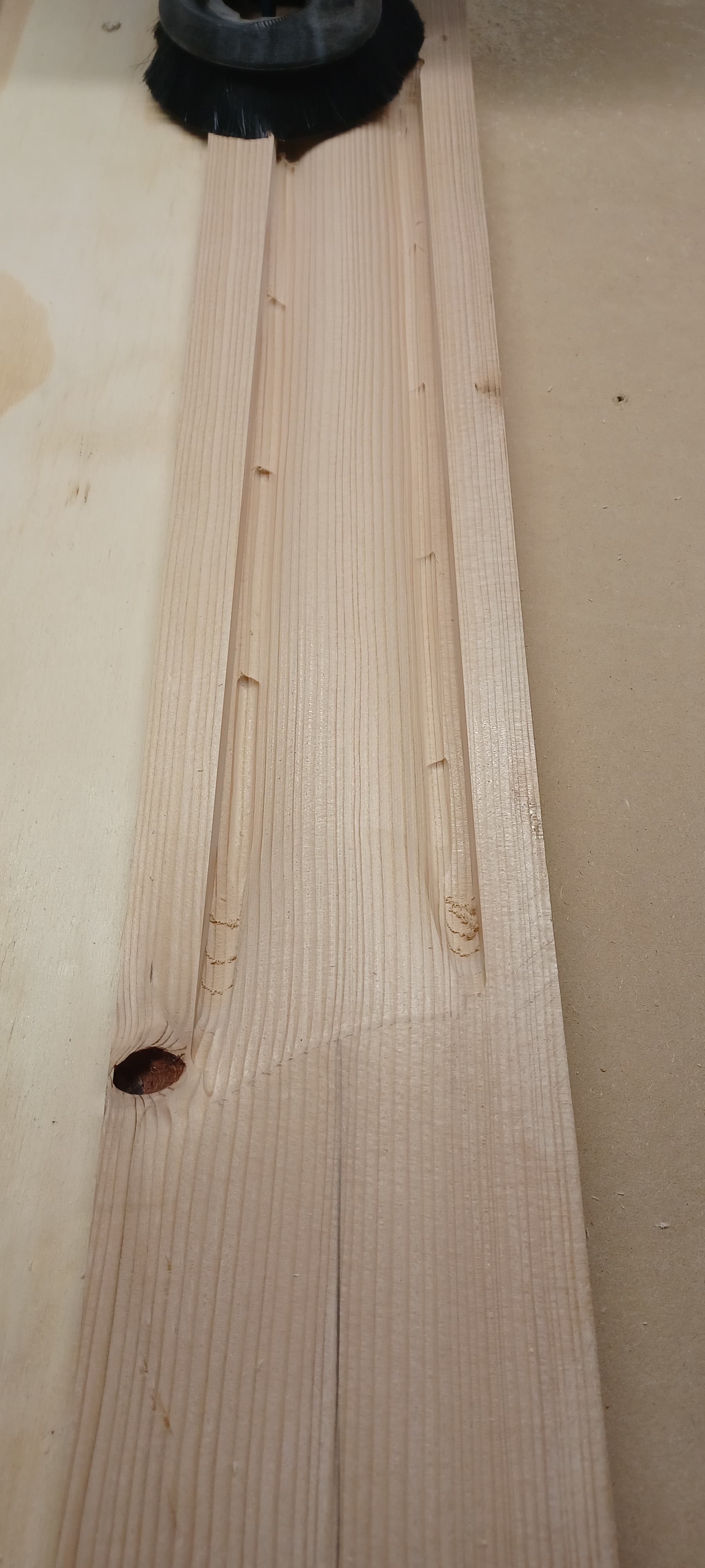

I get this message when I share the link (An error occurred: Sorry you cannot post a link to that host.) and Fusion 360 (educational) dosen’t allow me to download the file, only to share a link… 🤔 I’ll try your suggestions, it makes sens, I’ll go slower, shallower passes and I’ll do the test with pine or mdf (softer wood) and see If I get the same results. I’ll share the results. Thanks

![20250830_181209](https://forum.sienci.com/uploads/default/original/2X/5/5515311256bdfe1accb3f2feea4dbb89d58dc3ed.jpeg)I did a test on a piece of hemlock, softer than Maple, I also used an adaptive clearing instead of parallel before smoothing everything, slower ipm 35 ipm max, it looks good. I think you nailed it !!! Thanks for your help 😁
