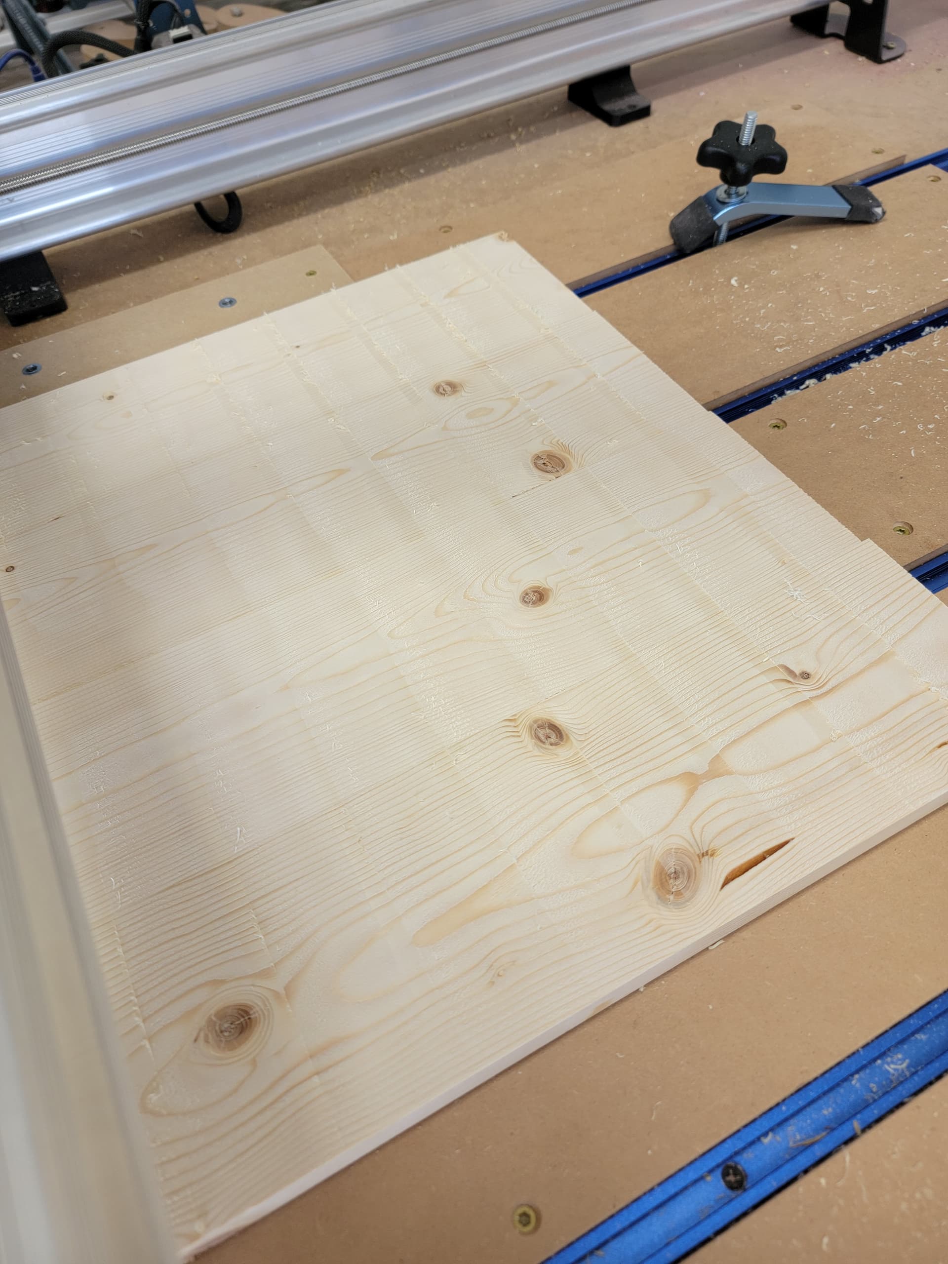

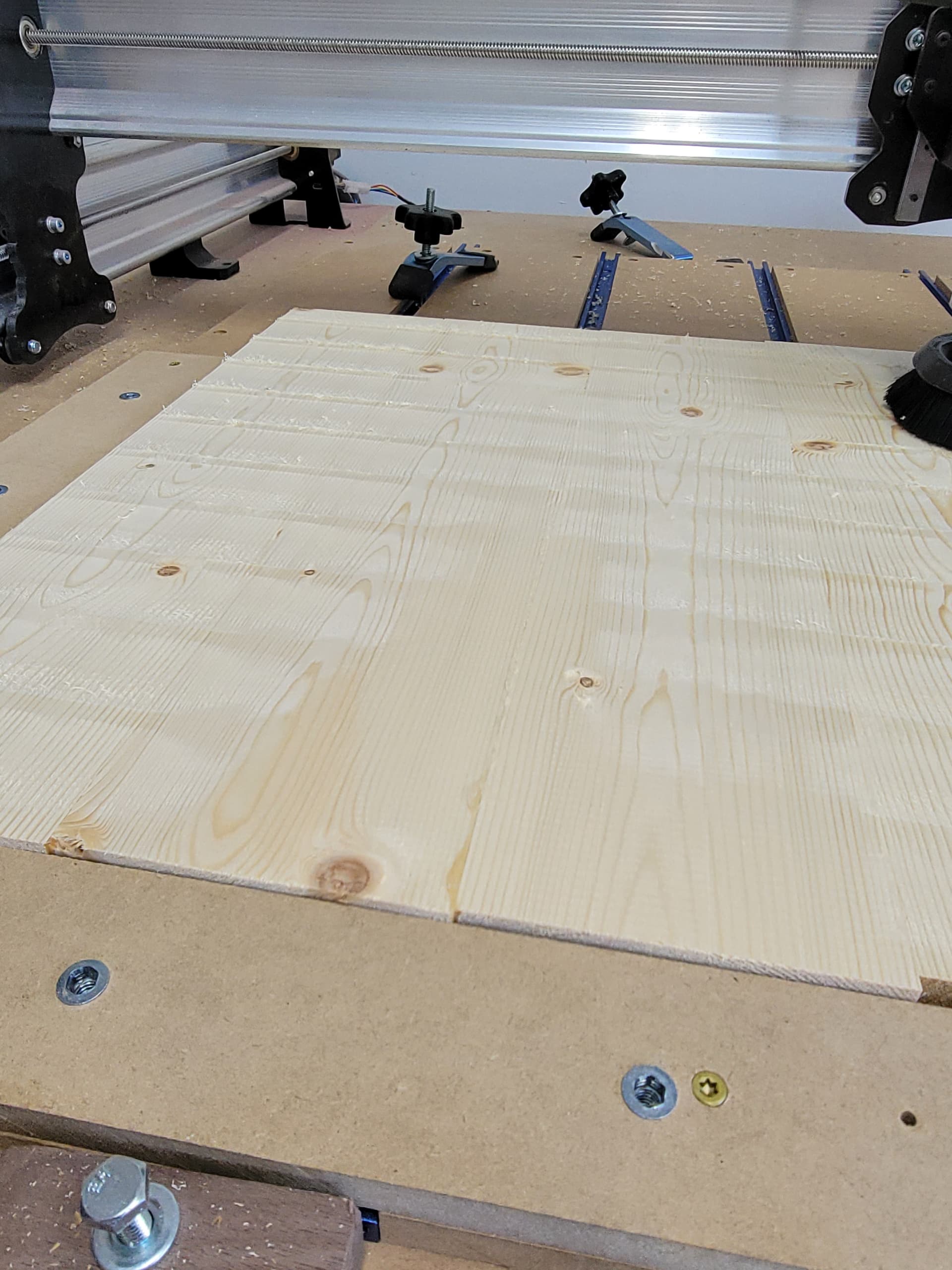

I know its time to tram again, the router is tilted right and backward, however i noticed the ridges become more pronounced as the machine moves further away. Is this a sign of a more serious problem?

Maybe a tram first, then a resurfacing of the spoilboard
