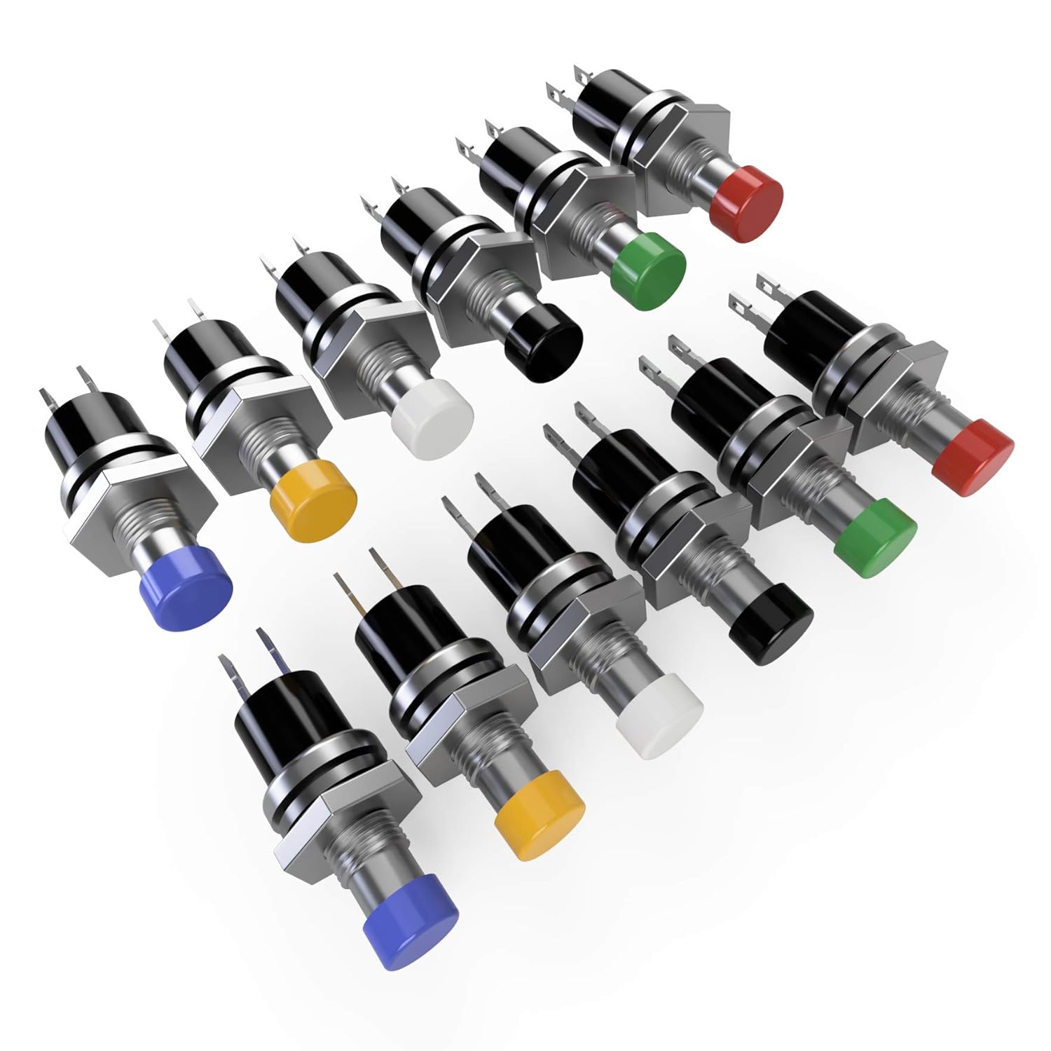

I added homing switches to my long mill. I used panel mount, momentary contact, normally open, push button switches that I found on Amazon:
> **[INTERACTIVIA - Solder-Free Miniature Momentary Push Button Switches SPST … (+12...](https://www.amazon.com/INTERACTIVIA-Solder-Free-Miniature-Momentary-Switches/dp/B0C2FCXFP7)**
> INTERACTIVIA - Solder-Free Miniature Momentary Push Button Switches SPST - Mountable 7mm (1/4") Hole
I 3D printed brackets and those files can be found here:

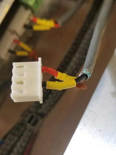

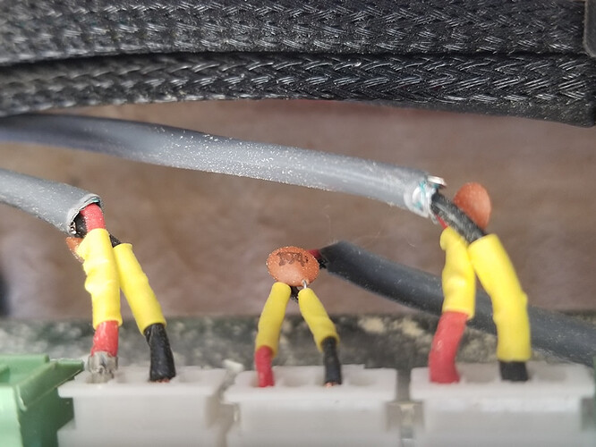

i used 2 conductor shielded security wire from Home Depot, JST-XH connectors and soldered a .1uF capacitor across the inputs to the longboard.

There are 2 connection options on the longboard. Both are clearly marked xlim, ylim, zlim, and gnd. There is an included connector at one end that has a screw terminal for each axis and one common ground for all axes. The problem with this connector is that it is difficult to add the .1uF capacitors that are needed for each axis. the second option are the three white jst-xh 2.54 mm connectors that are also clearly marked, one for each axis. This gives you much more room to attach the wiring and capacitors, but the female connectors that you need are not included. You can get them on Amazon either already made up with lead wires or you can buy a kit that will allow you to make up your own connectors, which is what I did. Once you figure out the crimp tool it is pretty easy to crimp on the pins and build the connector. Just be sure to get the pins into the right position on the connector. signal is on pin 1 and ground is pin 3.
Without the capacitors I was getting false alarms. I found it easier to strip some insulation off of the wires going into the connector to solder the capacitor on rather than trying to crimp it into the pins.

Sorry if this is a dumb question. I am unfamiliar how capacitors are use or wired in. If you don’t mind can you give me a bit assistance with which leads (positive and/or negative) would be used to wired in the capacitors?
**Author:** ![sysimgrp](https://forum.sienci.com/letter_avatar_proxy/v4/letter/s/6a8cbe/32.png) [@sysimgrp](https://forum.sienci.com/u/sysimgrp)\
**Post date:** [March 9, 2020, 9:28pm UTC](https://forum.sienci.com/t/homing-limit-switches/99/15 "2020-03-09T21:28:29Z")
Capacitors can be polarized or unpolarized. I used unpolarized capacitors wired across the input and ground of each switch. I never considered using polarized capacitors but maybe I should have. I was following the Long Mill documentation 5.0 Advanced on adding limit switches.
“It should be noted that it is very important to shield and filter noise along the lines with the limit switches, as interference can cause the limits to trigger erratically. We have found that placing a 0.1uF capacitor across the input and ground for each limit helps to prevent errant triggers.”
Since there is no mention of polarity, I just assumed that polarity doesn’t matter.

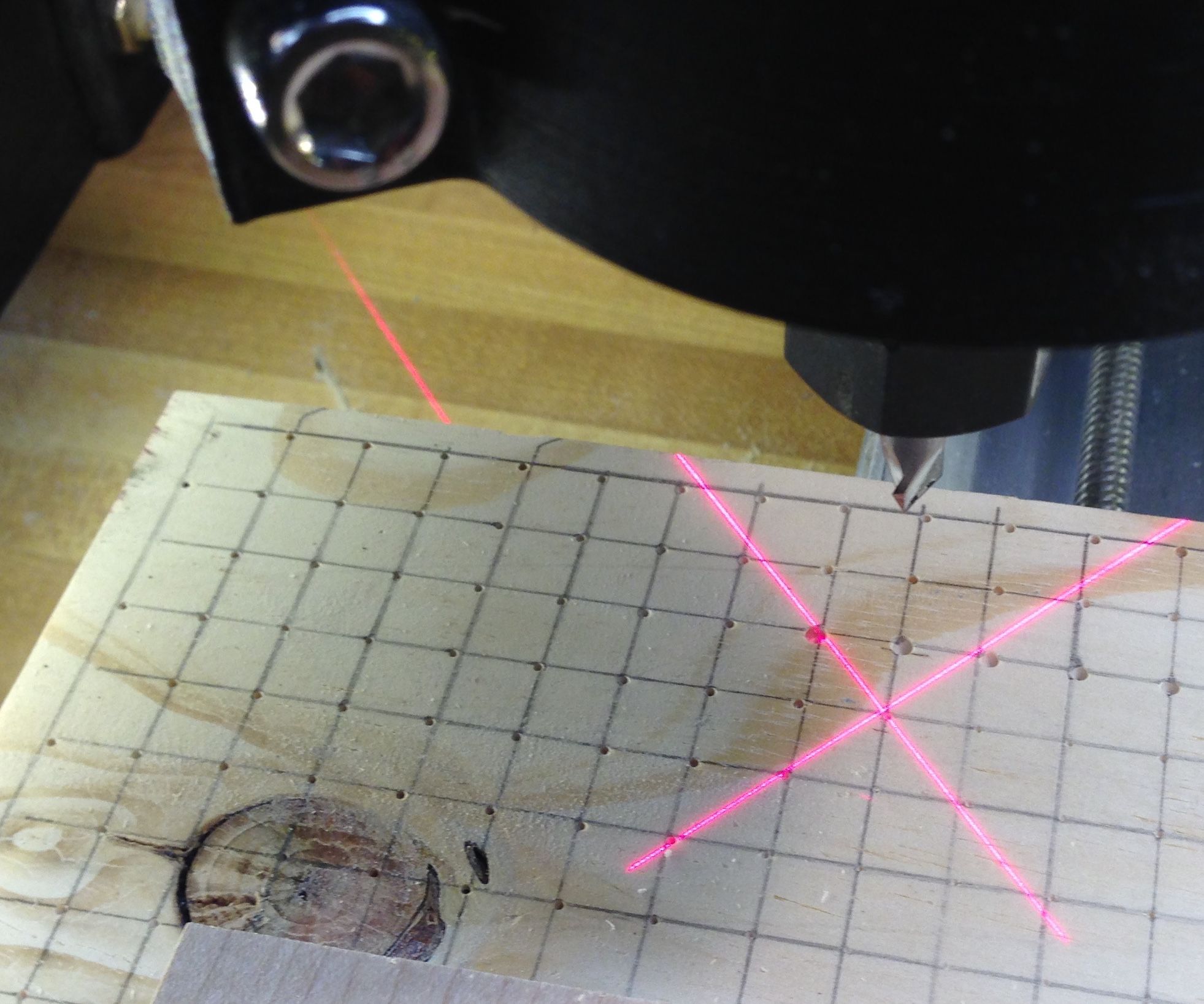

Oh btw, what do you use that laser for, on the Z axis?

The lasers are pointers to aid in positioning the router bit over a particular spot on the work piece. I took the instructions from the Mill One Community Open Source Page, which is where I also got the instructions for the homing switches.
> **[Add a Laser Guide to Your Sienci Mill One CNC Router](https://www.instructables.com/Add-a-Laser-Guide-to-Your-Sienci-Mill-One-CNC-Rout/)**
> Add a Laser Guide to Your Sienci Mill One CNC Router: An easy addition to your CNC router that makes it really easy to move to your X/Y work location.
> Parts list:
> 2 x 650nm 12mm 5mW mini Laser Line Diode Module (Anywhere from $2.00 to $6.00 each on...
I used the 2020 extrusions for the dust shoe to mount the lasers. I printed the mounts on my 3D printer. I am working on redesigning the mounts and I will put my files up on thingiverse and post a link when I have them ready.

Thanks for the reply sysimgrp. Hmmm…those laser cross hairs are an awesome idea!
I’m going to look at that again once i have the rest of the machine running.
