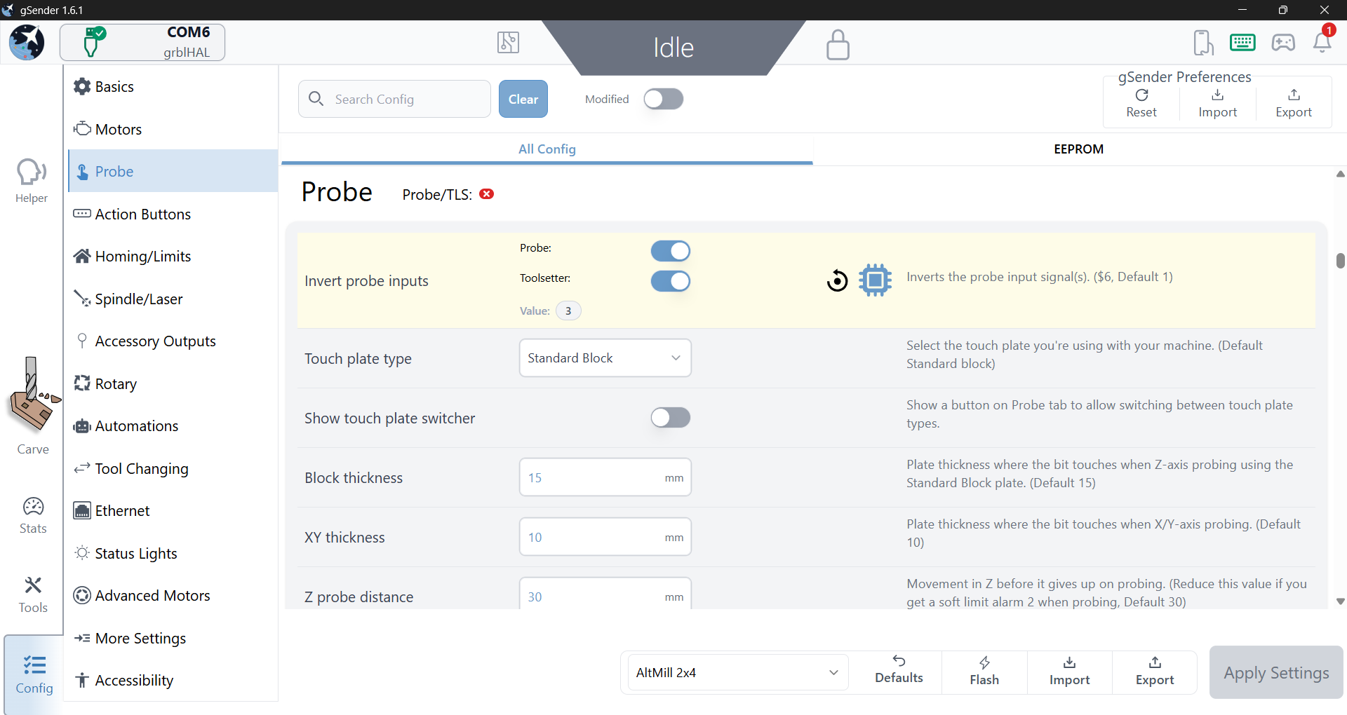

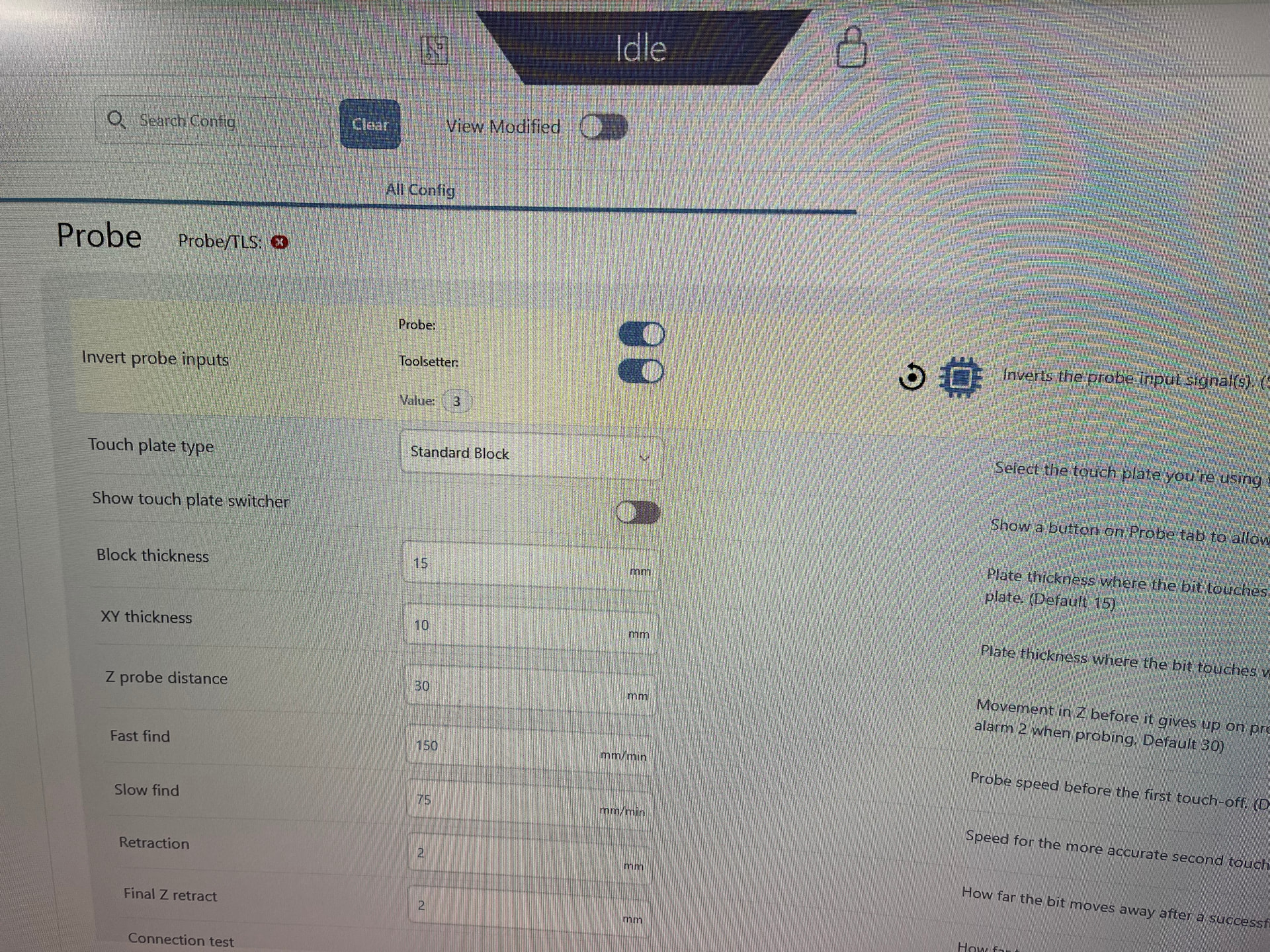

@Crazy8sCommando I am facing the same issue you are with the touch plate and have also received a replacement SLB-EXT board with the exact same result on the new board.
I did find a work around by setting the Invert probe setting to 3 by enabling both Probe and Toolsetter to enabled. The probing now works without alarm but I am not required to touch off the bit before starting the probe cycle. Not perfect but it works. I did share that feedback with Sienci Labs support.
I am wondering if this is a bad batch of boards or bad firmware like @Chucky_ott suggested.

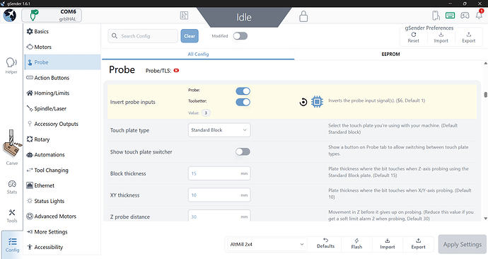

To clarify, this is not a gSender issue. It’s a firmware issue. You need to reconfigure your EEPROM value for $6 to be 3 (both toolsetter and probe enabled).
Reverting versions will not fix it - this is a issue with the new firmware being shipped out that will be fixed in the next firmware update (not gSender).
Either type $6=3 in the console, or manually enable both options in Config:
 ![image](https://forum.sienci.com/uploads/default/original/2X/3/38d0e2e95a74c0650f331a07e1413ac82435ed13.png)
Restart your controller and you should be good.
