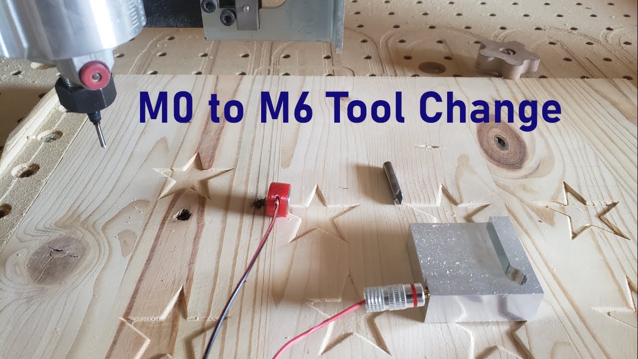

You migt have alook here. I’ve been meaning to try this for some time now.
[![](https://img.youtube.com/vi/K0iRXpUWfL0/maxresdefault.jpg "CNC - GSender M6 Tool Change Code with Touch Plate on my LongMill") ](https://www.youtube.com/watch?v=K0iRXpUWfL0&t=228s)
Andy

Thanks for the response. I kind of understand what he is doing, but is doing it with a tool probe, which can be accomplished strictly through Gcode. I unfortunately don’t have one just yet, though will make one soon.
I’m trying to understand if it might be better to try an M0 in place of an M6, if that might let me jog and re-zero? Guess I’ll have to try it out
**Author:** ![Andy1](https://forum.sienci.com/user_avatar/forum.sienci.com/andy1/32/7266_2.png) [@Andy1](https://forum.sienci.com/u/Andy1)\
**Post date:** [March 17, 2023, 3:16pm UTC](https://forum.sienci.com/t/im-using-carbide-create-v6-and-had-an-issue-with-changing-a-tool/7849/17 "2023-03-17T15:16:02Z")
Andrew , he has an earlier version of this using M0 , however he talks of a problem with it.
To be honest i don’t know , Neil is in this thread , he likely will have an opinion on how bets to handle this.
