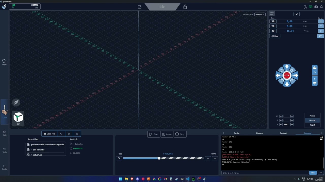

youtube video for demontration purposes, i still have to make a, probing failed if the cancel button is pressed, and ill have to test on my cnc if this is actually working

nice. looking forward to trying it. What 3d probe are you using?
**Author:** ![iuliancalin](https://forum.sienci.com/user_avatar/forum.sienci.com/iuliancalin/32/6213_2.png) [@iuliancalin](https://forum.sienci.com/u/iuliancalin)\
**Post date:** [July 23, 2026, 6:08pm UTC](https://forum.sienci.com/t/implemented-find-material-center-in-gsender/26759/3 "2026-07-23T18:08:34Z")
i use the small Chinese 3d probe, but any 3d probe can be used.
also, this is not ready to use, i have some trouble implementing it cleanly in gsender and since I’m using AI to do the coding and changes i can’t just give it to anyone, its not safe to use as of now.
if any one that has more understanding of codding and is willing to help i can send the code and what I’ve done so far.
here are some issues i encountered
1: the ui can go haywire, a scrollbar can appear out of no were
2: i want to program a message at the end of the probing cycle to display a message like “probing successful” , but apparently AI can’t really find a reliable method , waiting for controller to display idle is not an option, i tried. i did try something today and packed the installer but ill have to test it tomorrow
so far those are the major issues i encountered, also if the cancel button is pressed before the probing ends a “probing failed” message will appear, that is only dependent of the cancel button and also locks the machine and require a soft reset.

updated and working version of the latest gsender 1.6.3 release, give it a try [GitHub - iuliancalin/gsender: Connect to and control grbl and grblHAL-based CNCs with ease · GitHub](https://github.com/iuliancalin/gsender)
there has been a new button added in the probing tab that opens a popup window
