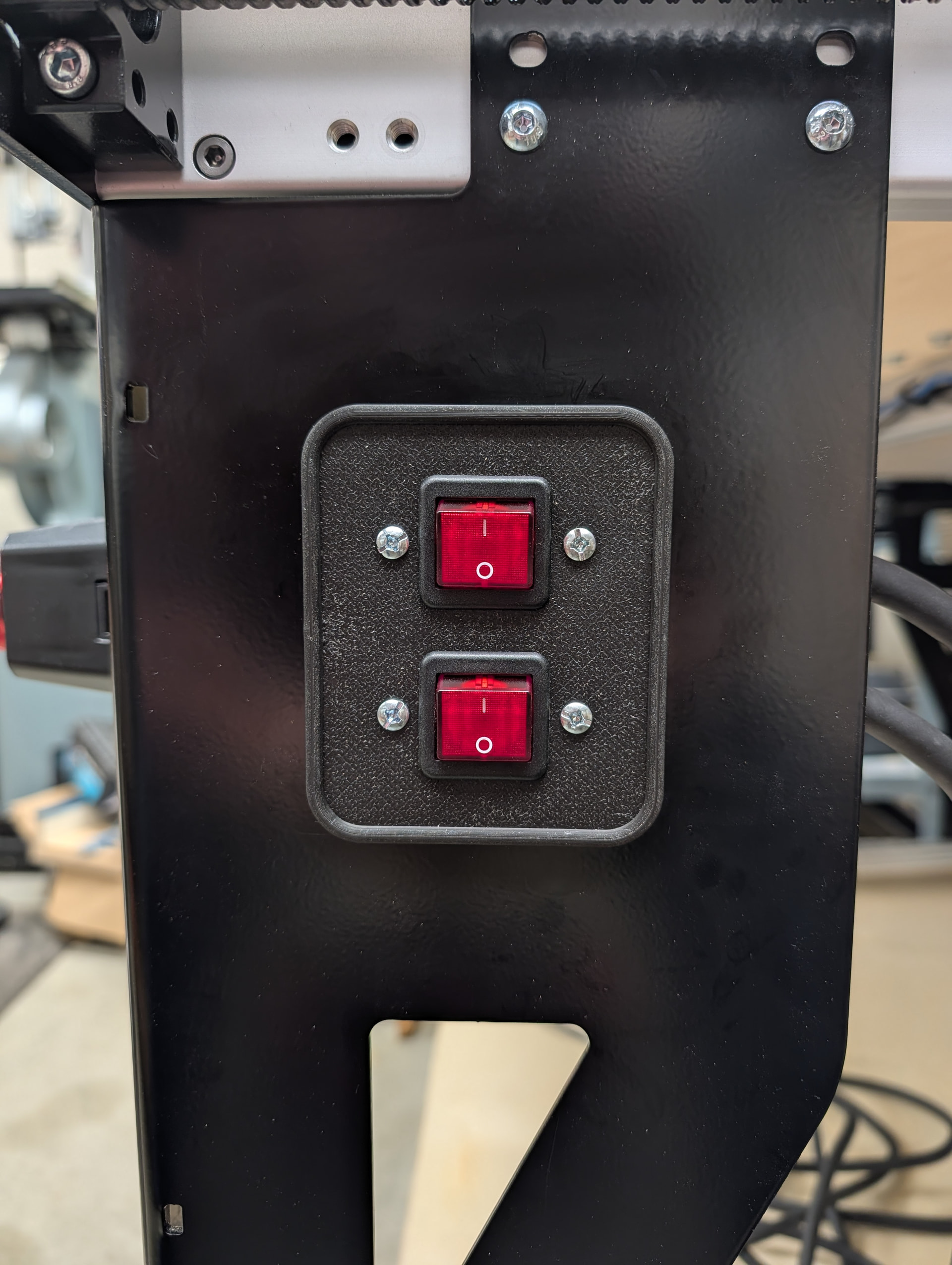

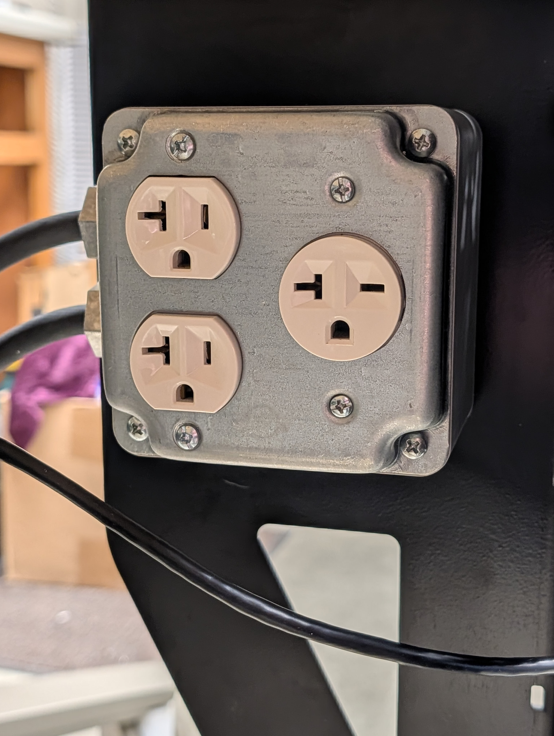

I ended up due to startup sequencing requirements using two switches. (VFD before SLB) This also isolates my VFD 220V and the SLB-EXT 120V from each other. Used the hole in the leg just next to where I currently have the E-Stop switch located on the front of the machine. Not quite as fast as a single E-Stop switch but so far it works well for power up and total shutting down of the machine.

I like that two power switch setup. Very nice. I’ve been reaching around the SLB and using that little toggle switch. It’s a pain.

@mjeanson I like that setup. Where did you source the plate with switches? As others have said the little switch on the SLB will get very tiring.

The face plate, and the box I designed and 3D printed in my shop. The metal plate on the back I milled out the slot for light switch with a hole saw because I was not able to find a dual cover that would support 110V and 220V outlets side by side. The switches I sourced out of Lowes and ended up removing their neon lights and bias resistors because they were not rated for 220V but the contacts were. Go figure! I removed the 110Volt switch’s light as well so the look would be the same between the two switches and didn’t have that flickering effect that neon lamps have. The rest of the hardware are standard screws and two cord strain reliefs.
**Post date:** [May 20, 2026, 5:02pm UTC](https://forum.sienci.com/t/installing-a-real-emergency-stop/26398/12 "2026-05-20T17:02:55Z")
I like your switch setup as well. I thought that maybe it was 3D printed but I wasn’t sure because of the textured look. Is the textured look because of the build plate or is it the top side with a special pattern or fuzzy skin?

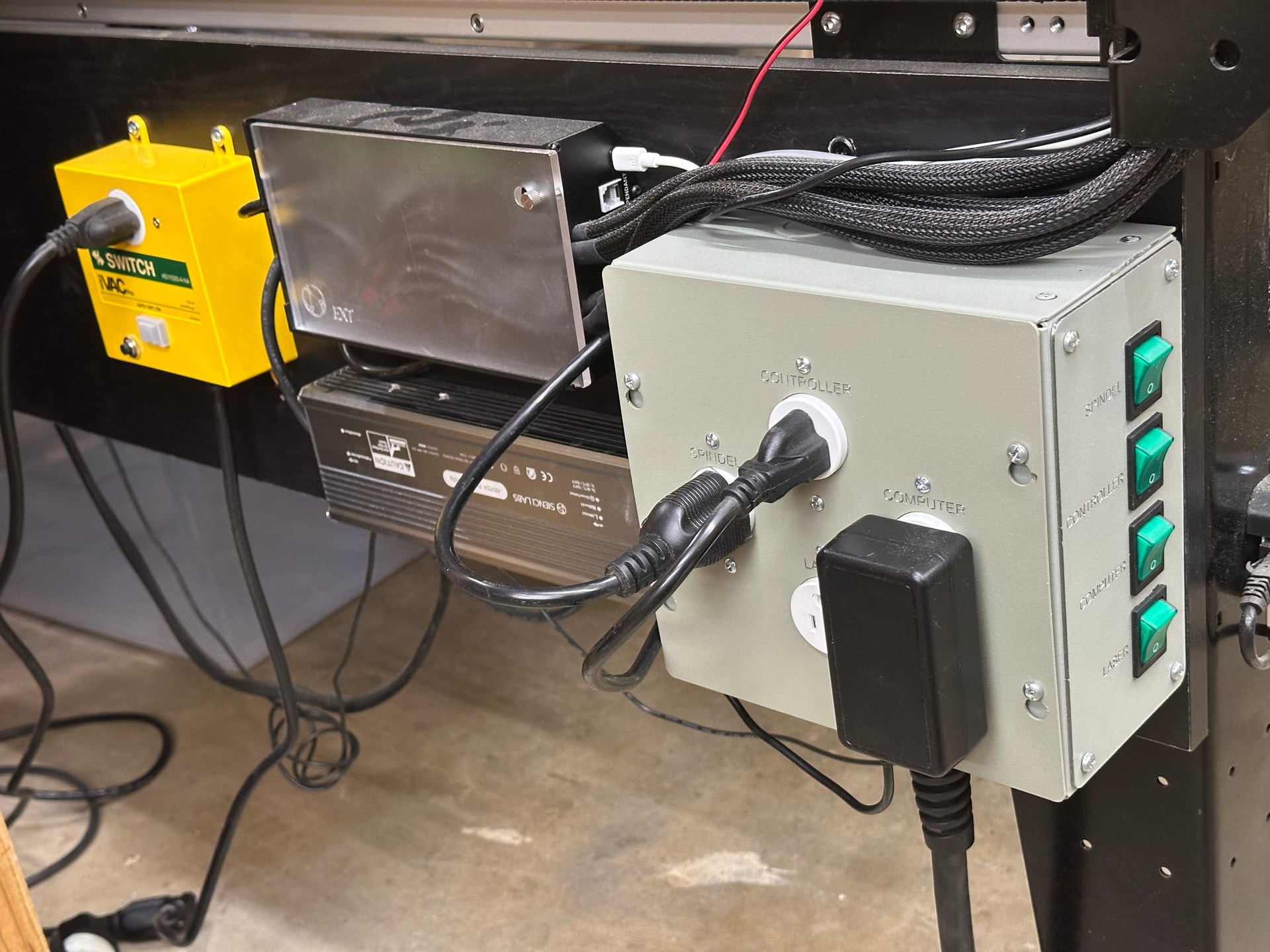

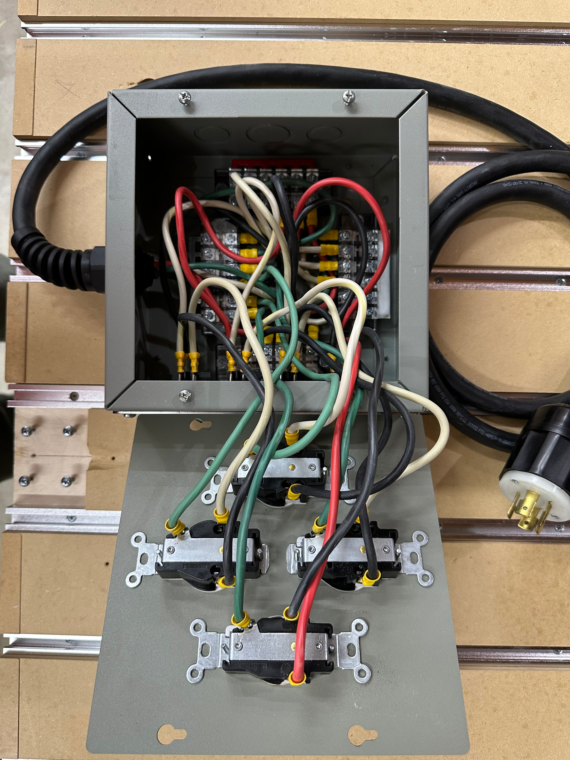

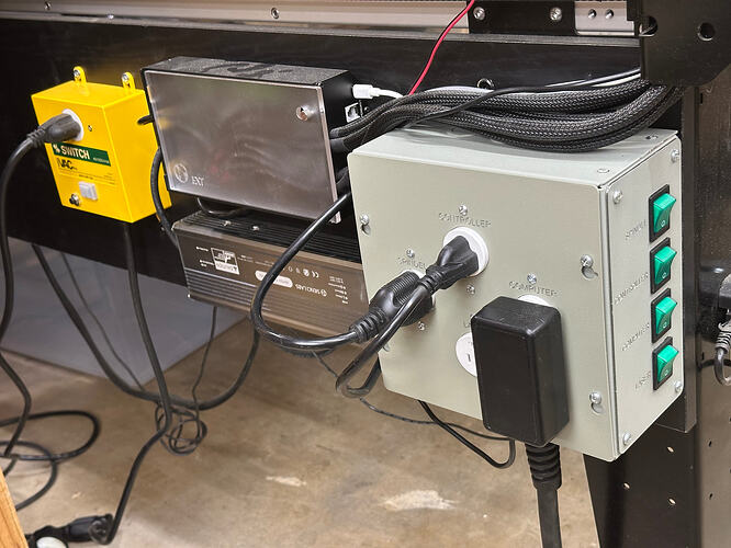

I just finished a power control switch panel for my 4x4 2.2kw AltMill. The input chord is a 20amp 4 conductor twist-lock that breaks out into one-240v outlet for the spindle VFD and three-120v outlets for the SLB, Computer, and future laser (Power load is balanced across 240v legs). Lighted rocker switches control each circuit. I built this using a NEMA 8x8x4 enclosure. The cutouts and screw holes were milled on my AltMill using 1/8" end mill designed for cutting steel (Amana #51674). The engraving used a 60deg V-Bit.

Its a texture on the switch insert side. The obverse side was on the build plate. There is a small step on the back side and on the front of the electrical box so it would sit flush and not rotate in the legs hole.

Looks like a great setup and control. I like the fact that your leads are long enough that you could easily put common and differential chokes on some of your high noise producing loads!

**Post date:** [May 20, 2026, 11:38pm UTC](https://forum.sienci.com/t/installing-a-real-emergency-stop/26398/16 "2026-05-20T23:38:31Z")
Thats nice. Thanks for posting those pictures.

Sweet setup, but you spelled ‘spindle’ wrong in your engraving. 😎😎
**Author:** ![Karver\_One](https://forum.sienci.com/user_avatar/forum.sienci.com/karver_one/32/11233_2.png) [@Karver\_One](https://forum.sienci.com/u/Karver_One)\
**Post date:** [May 26, 2026, 6:19pm UTC](https://forum.sienci.com/t/installing-a-real-emergency-stop/26398/18 "2026-05-26T18:19:01Z")
Wow sharp eyes. Any one up for a game of “Where’s Waldo”? I never would have caught that.
